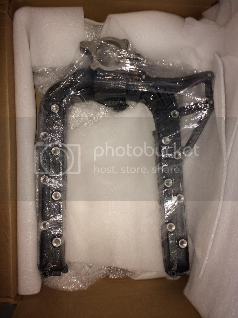

Made some progress over the week / weekend. Re-pinned injectors with replacement connectors. Updated stand pipe and dummy plug. VCs back on. Installed sending unit in oil cooler at the test port for oil pressure. Installed oil cooler. Installed my own CCV re-route. Manifold is on and is gorgeous. Pics speak for themselves. Absolute coolant filter installed and waiting on the revised fitting for the delta line kit. Should have it back together mid week. Nate and Steve have both been awesome and I would highly recommend anyone to use their products. All top quality and super nice guys.

Manifold packing was very nice
All hardware was great - even came with these nice seal washers for the rear two bolts which re-used stock manifold bolts
