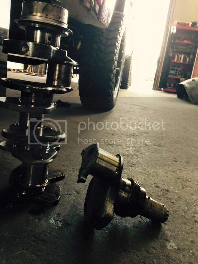

Im not willing to argue about that but in this day and age after you already broke it, since it needs changed, theres a stock dmax crank that is good for 1khp...if you balance it all even more.
But I dont doubt that someone has changed firing order to help the issue.
afaik, they change the firing order quite often. i have a buddy who is into tampons a lil bit...

They do. Im ignoring the suggestion as its looked at funny at a few shops. To each his own though. And Im INTIMATELY aware of the problem. This was last week. I stepped in the shop one night to help and found this. Lmm WITH efi live and modded firing order. Didnt matter lol
The lml cranks are plenty good and with a precise balance job they are good for built motors. But in an lmm if you just take a step back, problem solved.
