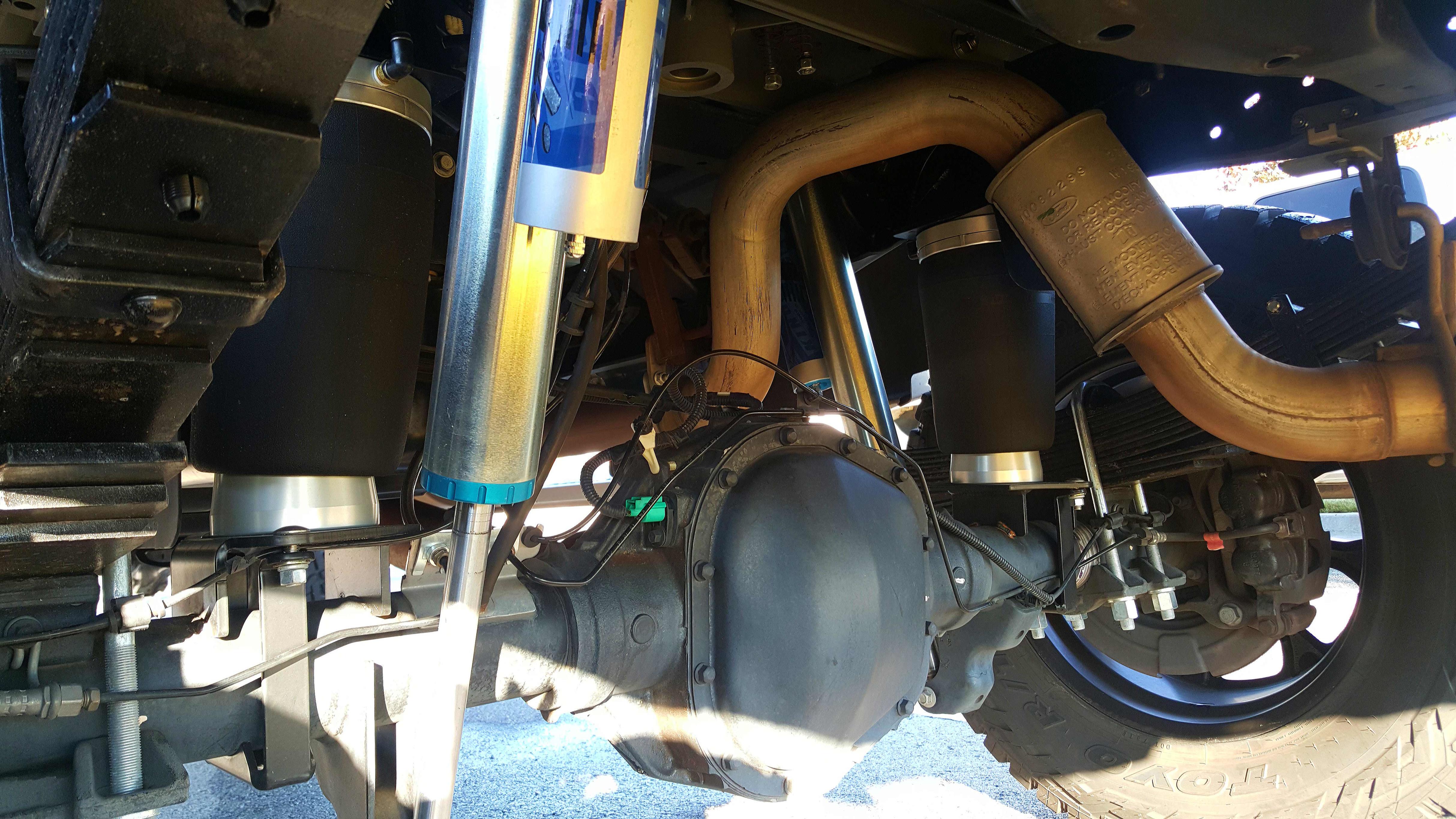

Only rear bags I am running a set of carli long travels

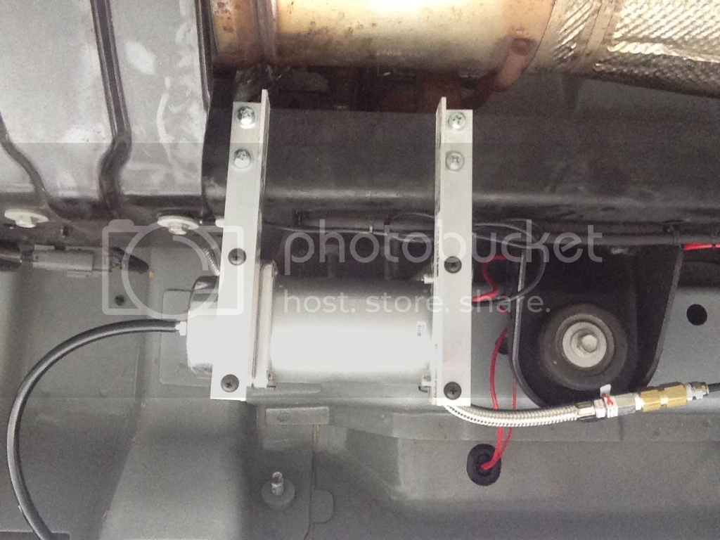

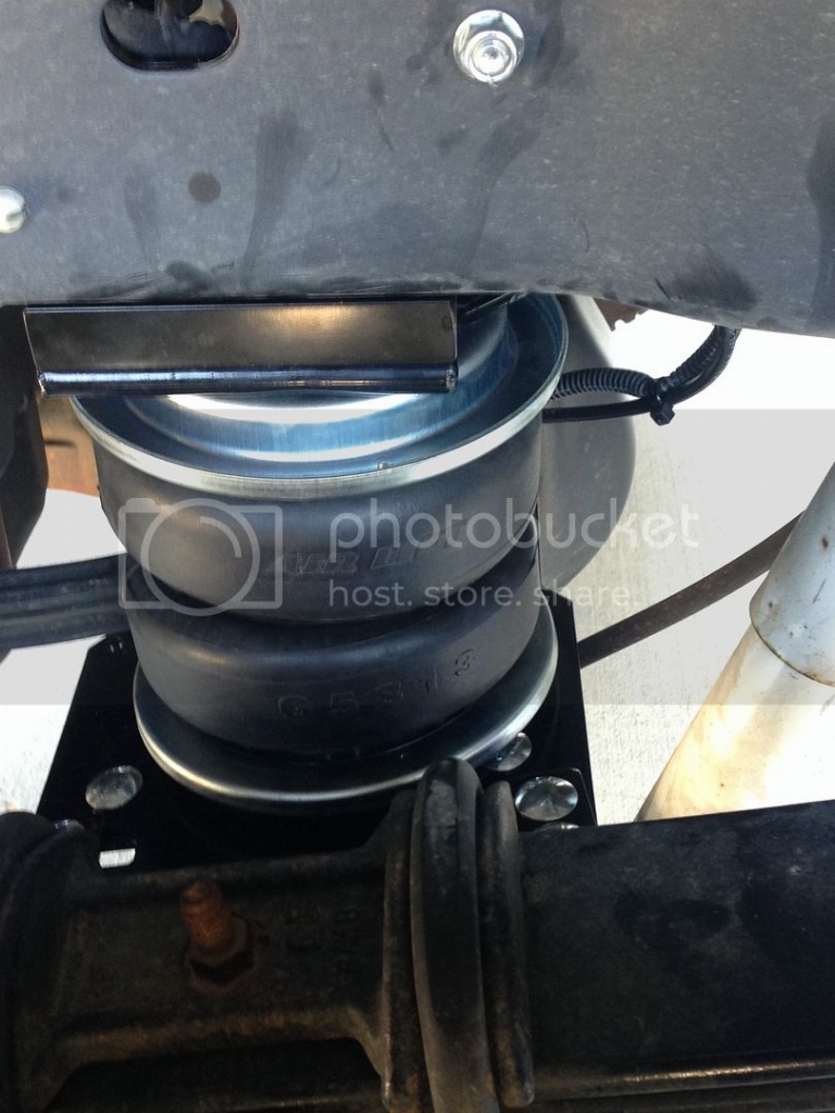

I had a bad experience with an Airlift controller on my previous '02 and I swore a better install this time around. It was an auto controller and the pressure sensors went bad and I couldn't get replacements. It was almost uncontrollable at best. I ended up putting a power switch on it and then manually controlling the bags and then turning it off so the automatic operation didn't take over.

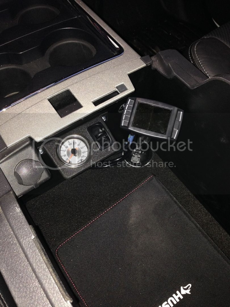

This time I started with a manual setup and Firestone bags. When it is done, I will have tank and bag pressure readings on the CTS and electric solenoids for the independent bag fill and dump. I currently have the dual gauge and pneumatic valves in place below the cup holders until I can get some time to dedicate some energy to completing the install.

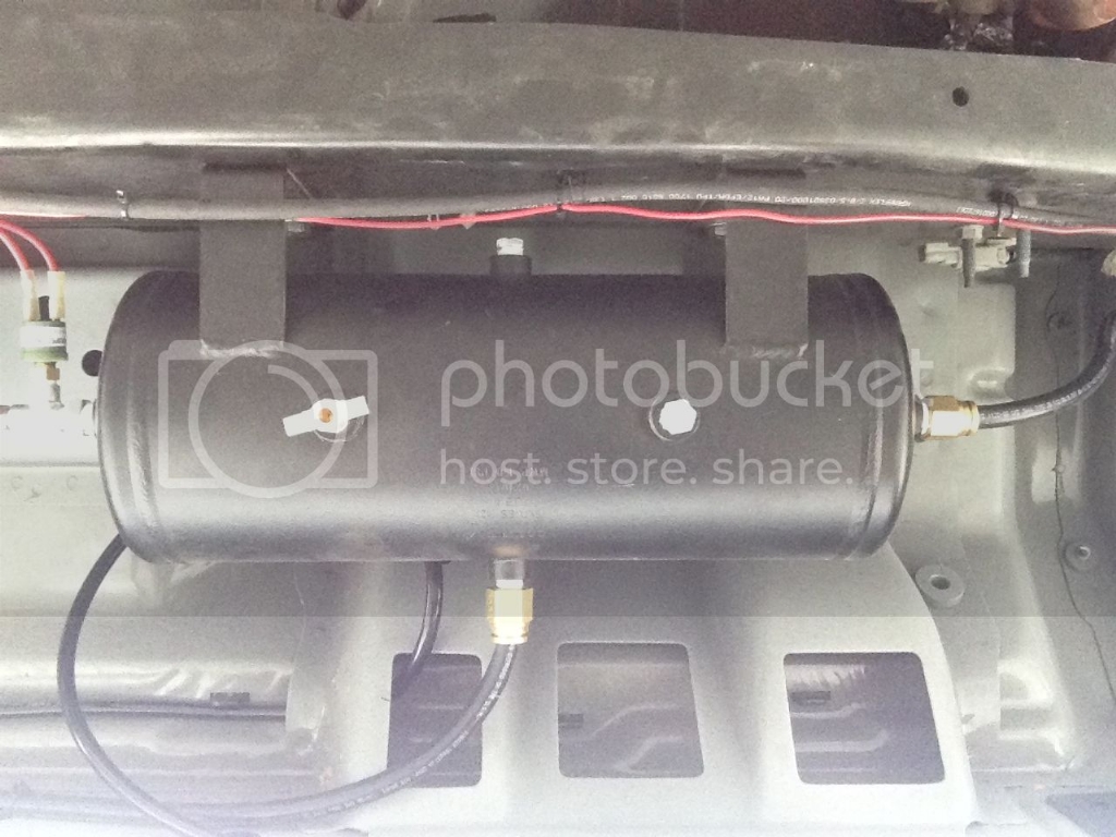

Mine isn't hooked directly to the compressor but to the tank. So the compressor fills the tank to 140psi. My switch fills the bags and releases air as well. One needle reads bag pressure and the other reads tank pressure.
