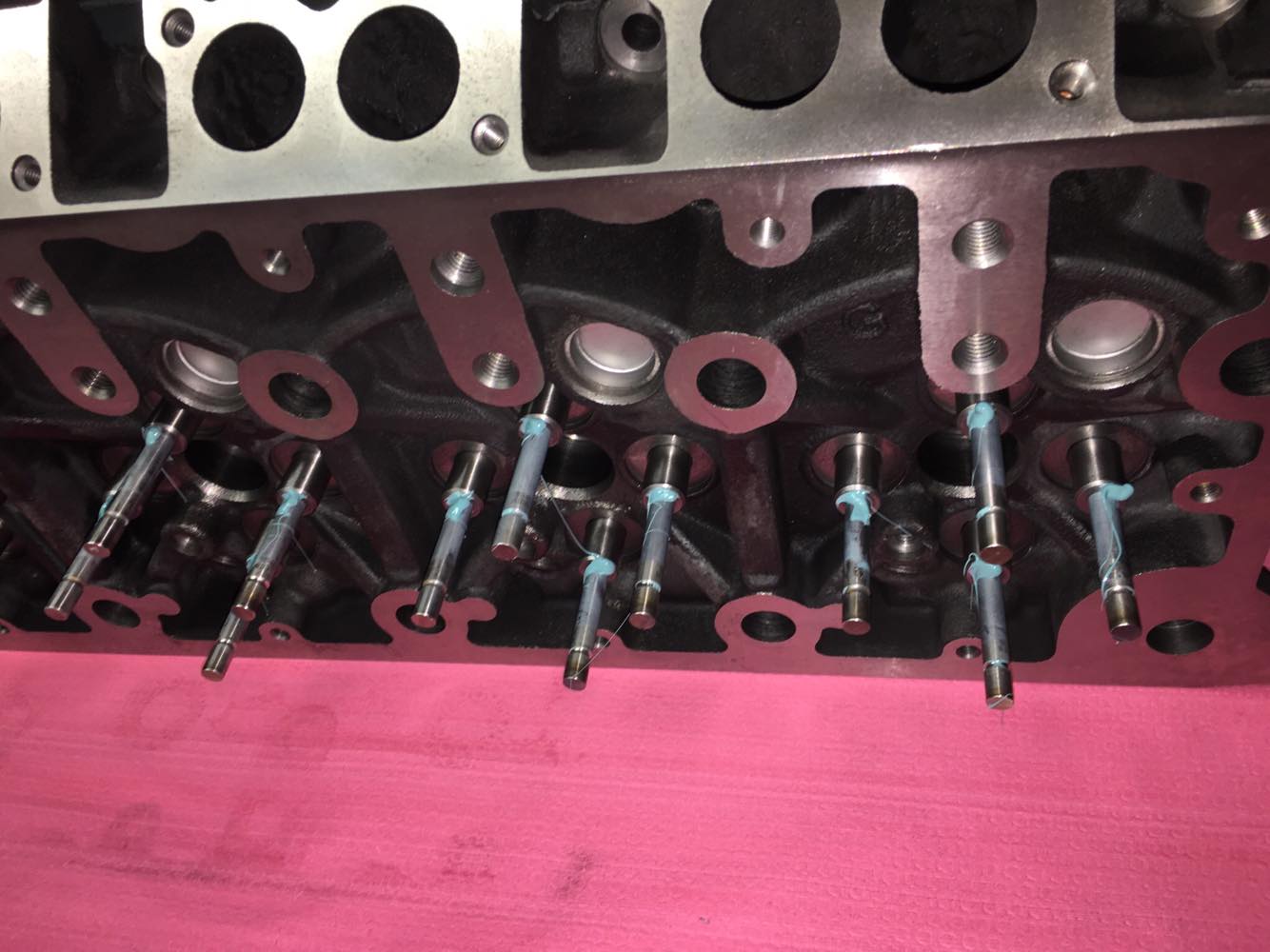

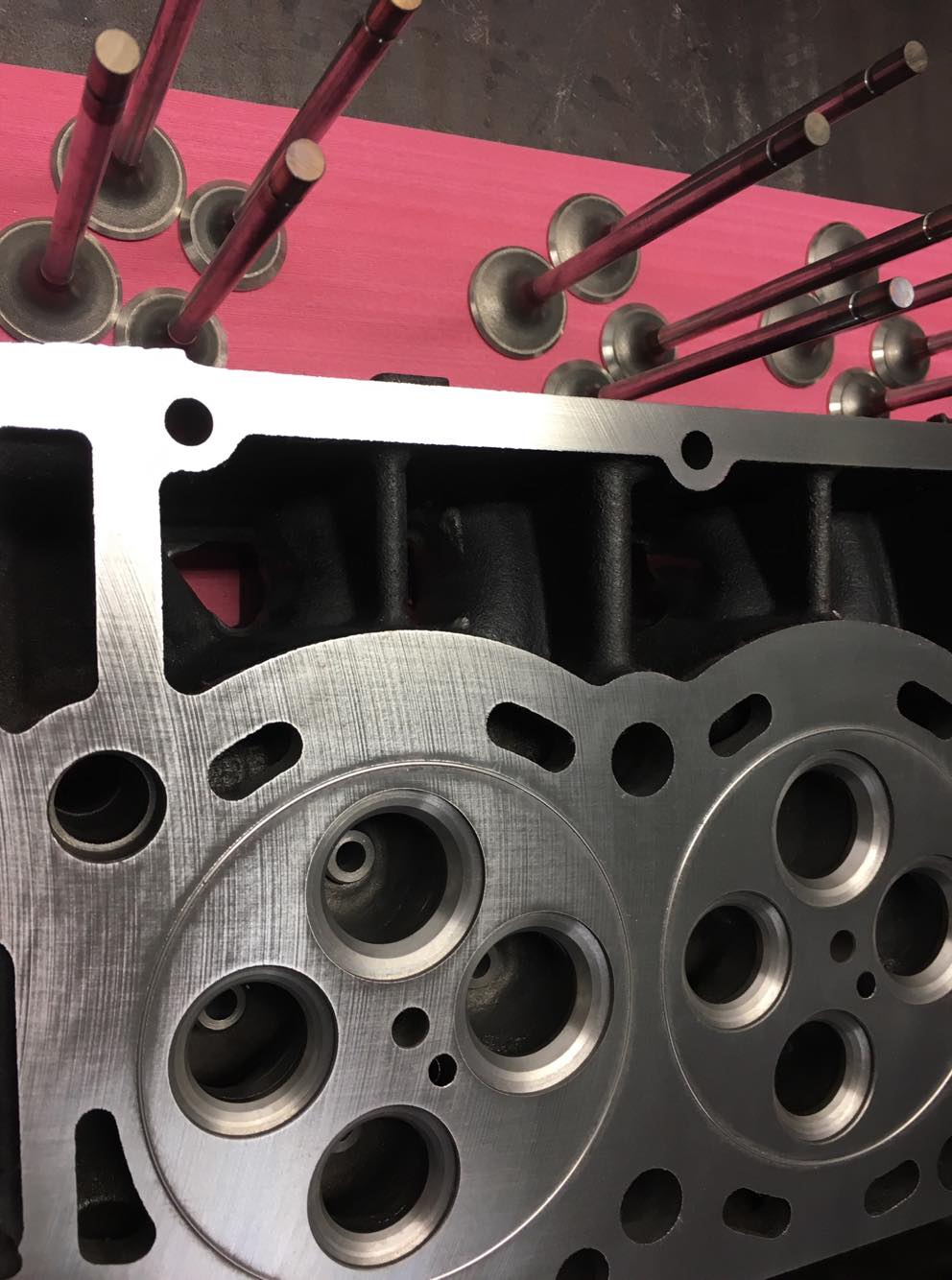

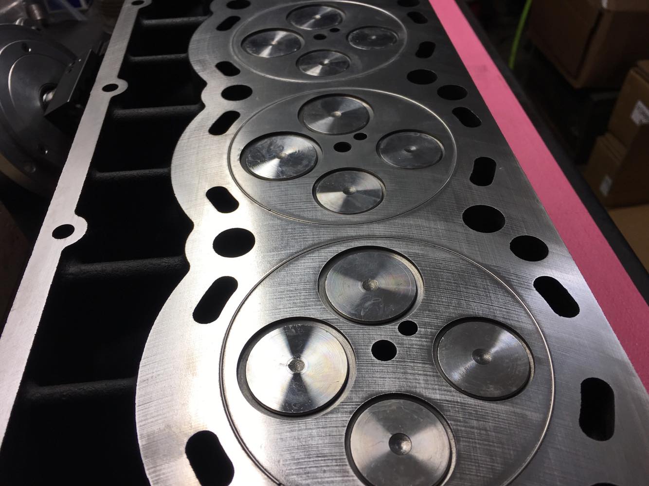

Got words that my new O-ringed heads got machined today and will be assembled tomorrow, hopefully ship next week. Front cover removal and surface cleaning until the weekend.

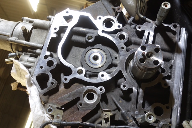

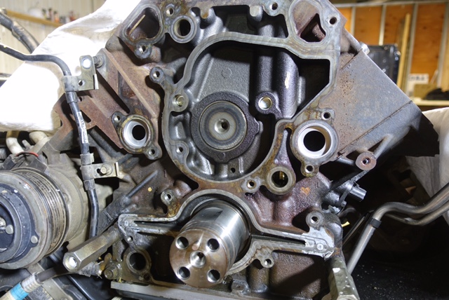

Got the Oil Fill and Front Cover off last night.
Two bolts were hiding :doh:
Slid right off with no effort after I found them. Need to move my brighter shop lights back over.
Got the first pass of block surface cleaning done as well. Used a Scotch Brite Roloc 120 grit wheel and it worked like a champ. I'm gonna go over it a few more times with a light scotch brite pad to even up the whole surface.

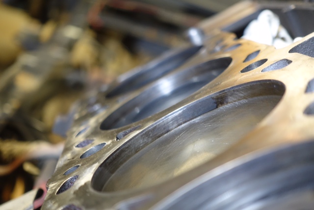

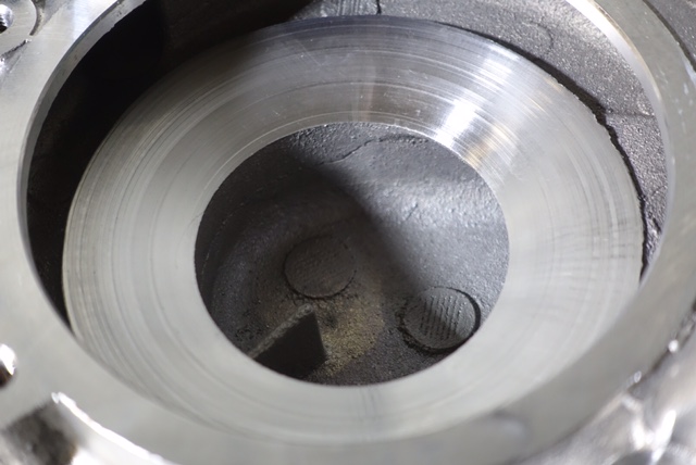

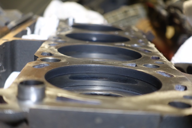

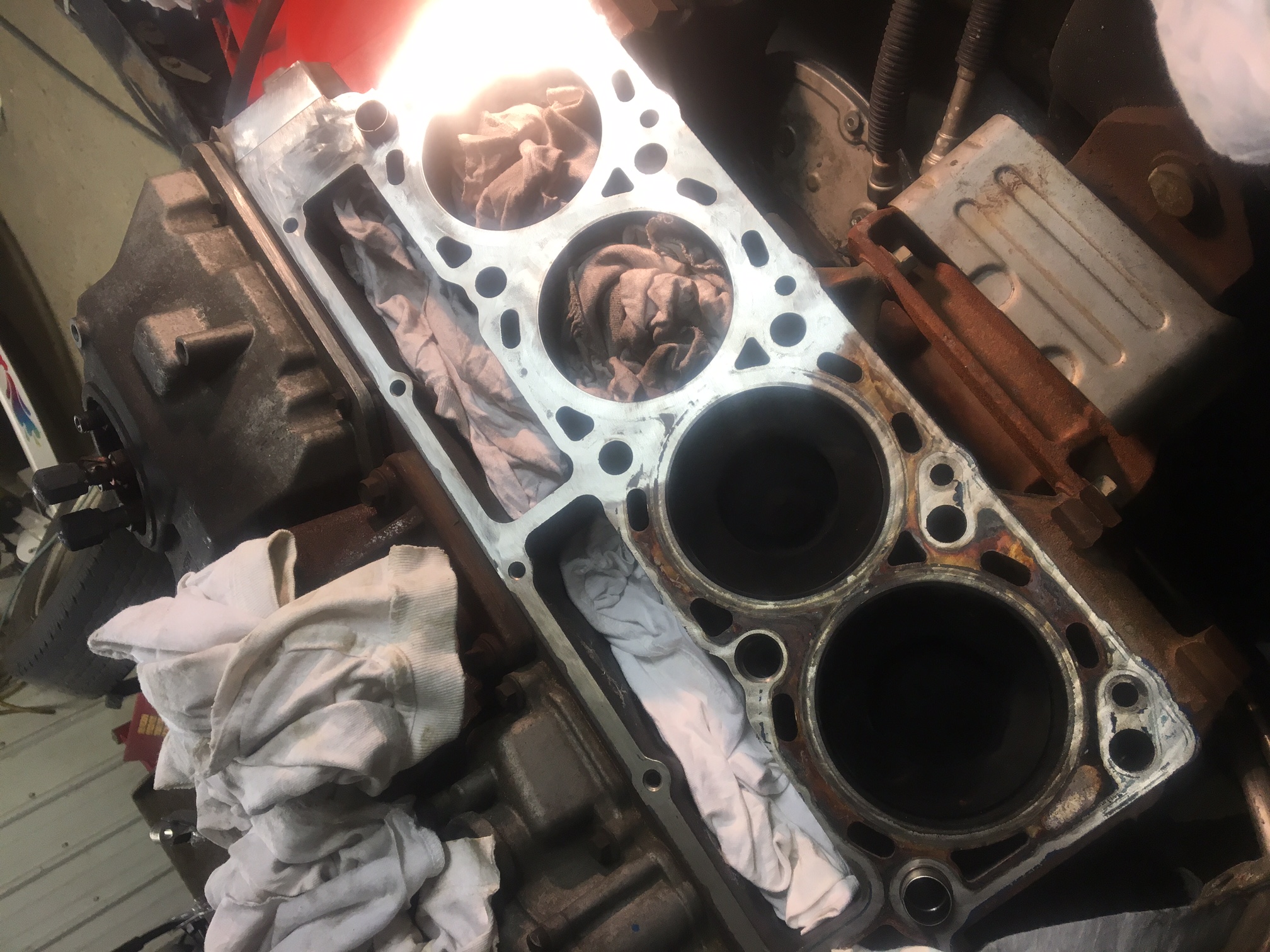

Carbon Build Up on Top of Cylinder
I need advice on how to deal with the carbon build up right at the top of the cylinder?
I hate to scratch up the cylinder wall in anyway. What have people used in the past? Or do you just leave it?
Razor blade? Then a scotch brite dabbed in oil/brakeleen?

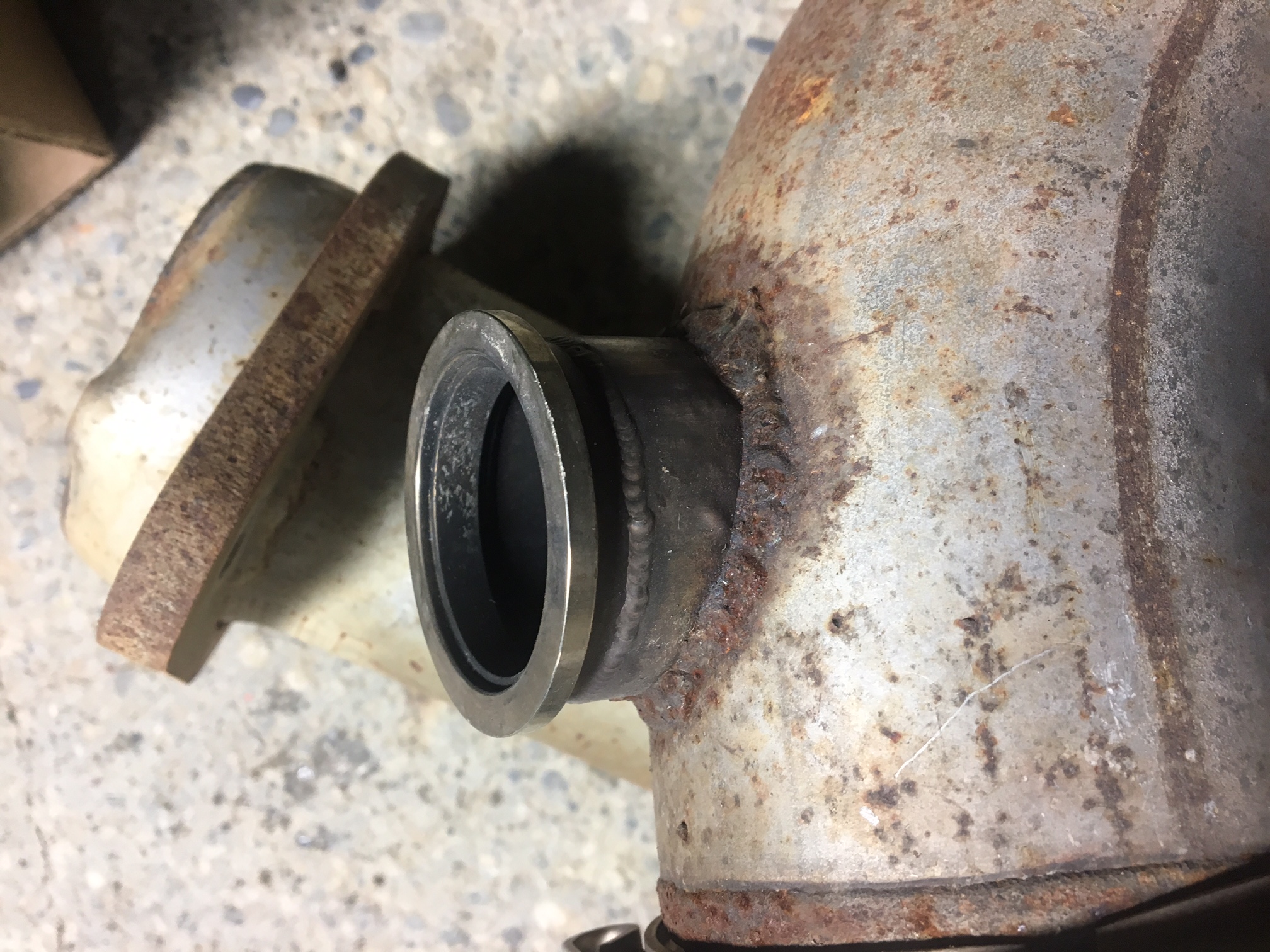

Tial Wastegate Flange

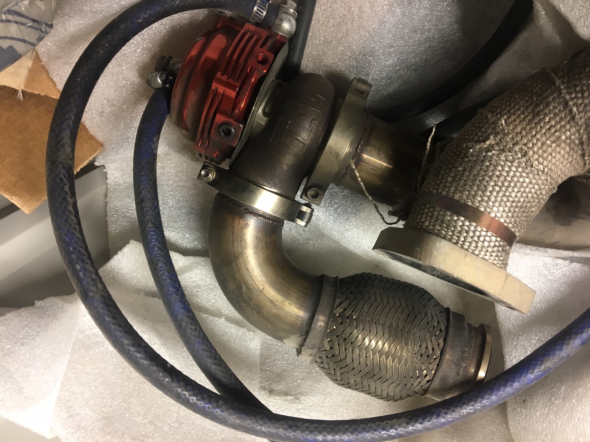

Could anyone help me find a new wastegate dump flange for a Tial wastegate?
I just need the flange to weld into my downpipe. The downpipe I received from the individual I bought the turbos and wastegate setup is garbage. Looks like someone took it out back and shot it up a few times and then welded it in blindfolded.
The flange measures 45mm/1.75" inside diameter.

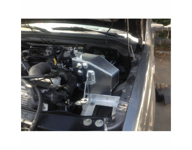

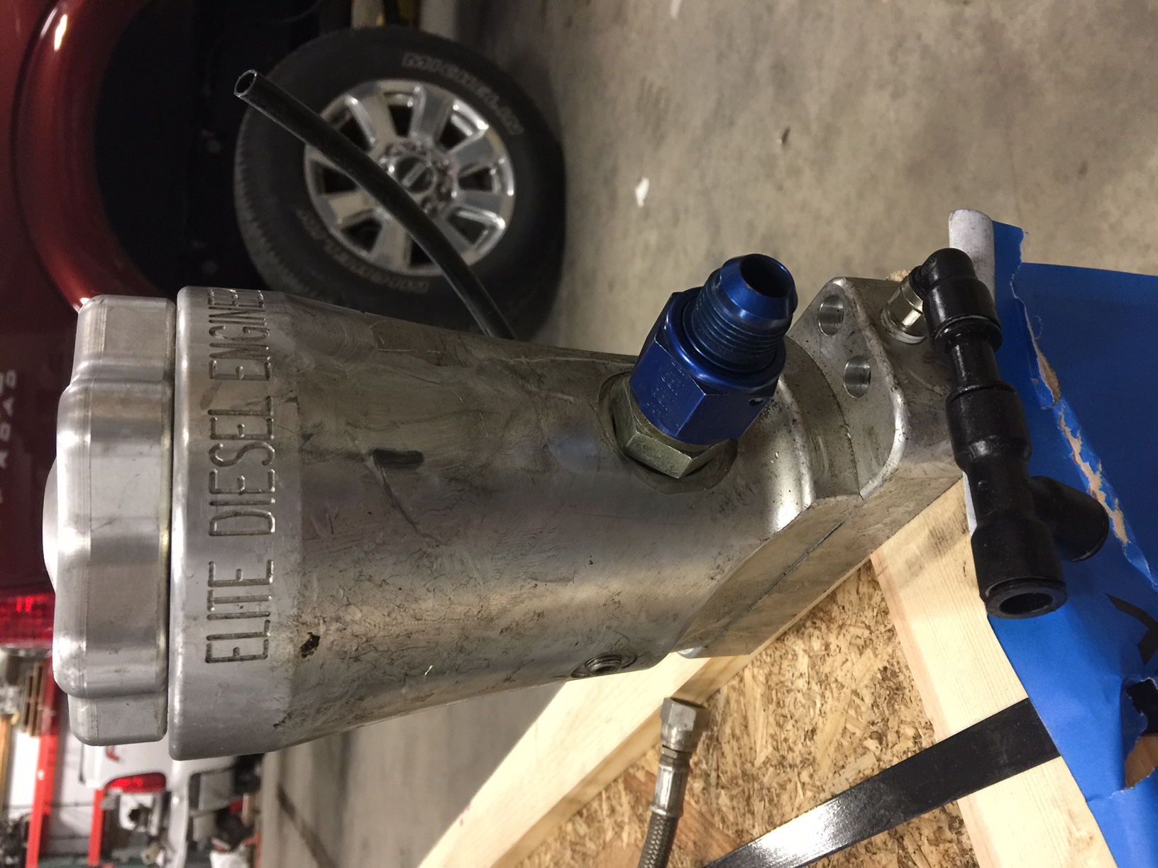

More Goodies
Found some used shiny goods from Jared Breaking Habits
Great little boost to the look under the hood

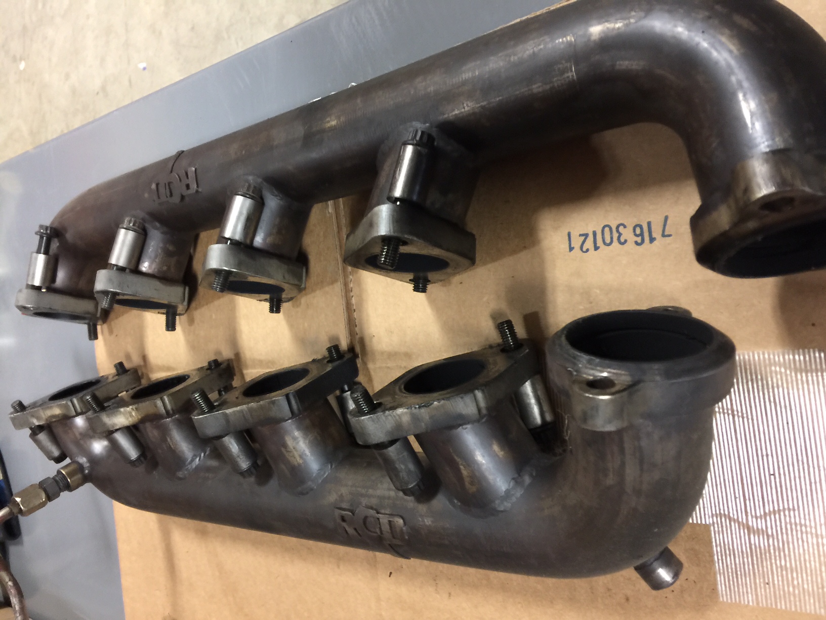

Got a set of RCD SS Race Manifolds
No Limit Coolant Tank & Battery Tray
Elite Diesel CCV Can

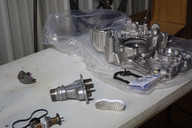

Progress Post
Front Cover is off, surface cleaned, with new thermostats and sensor installed
Once the cam is in I'll get it put back on

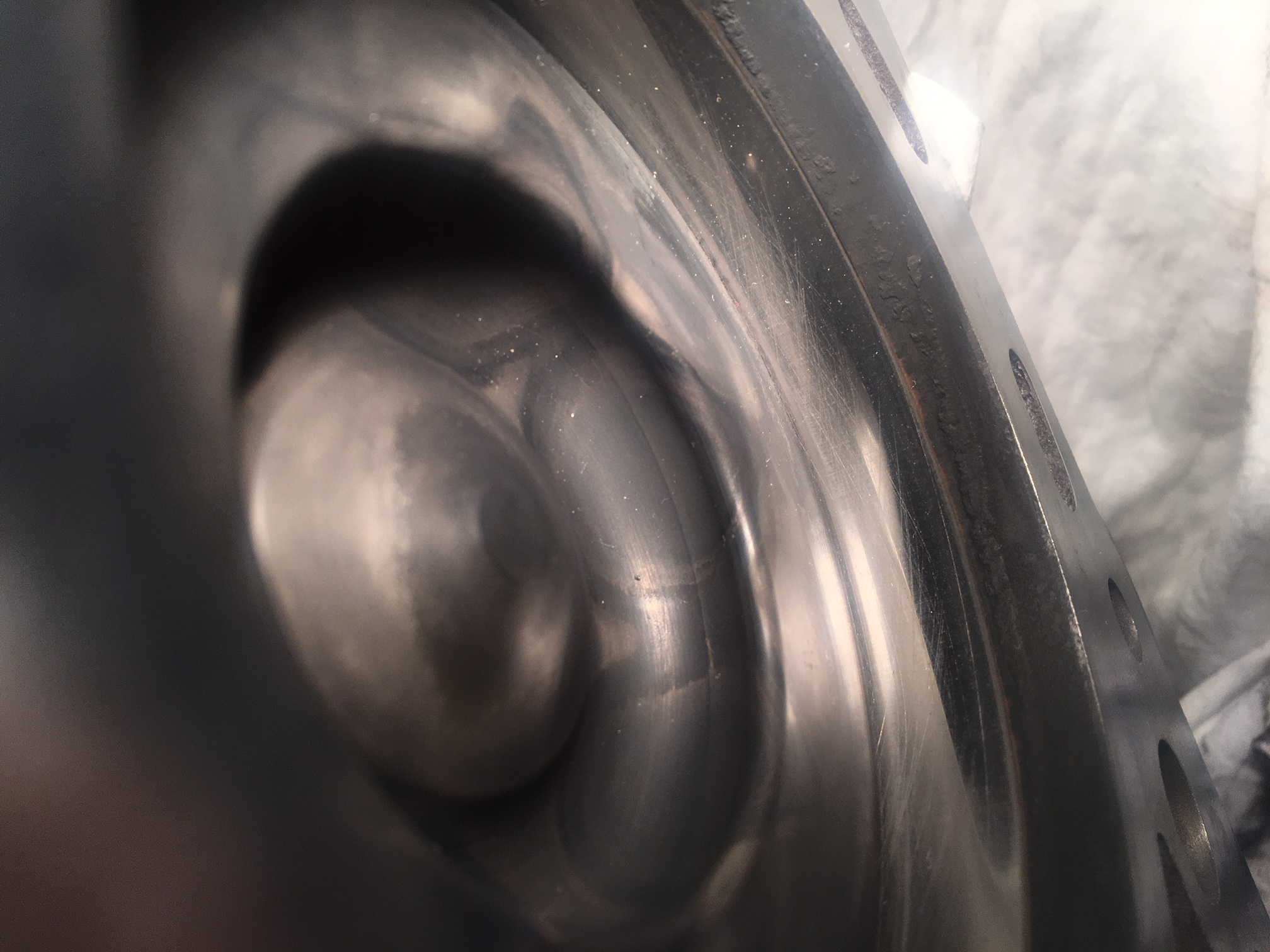

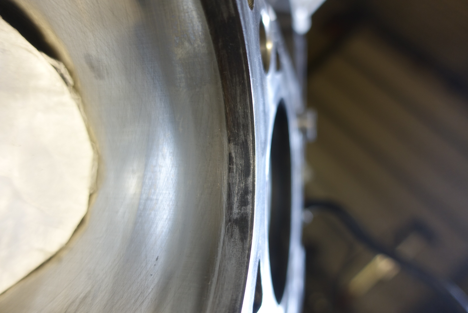

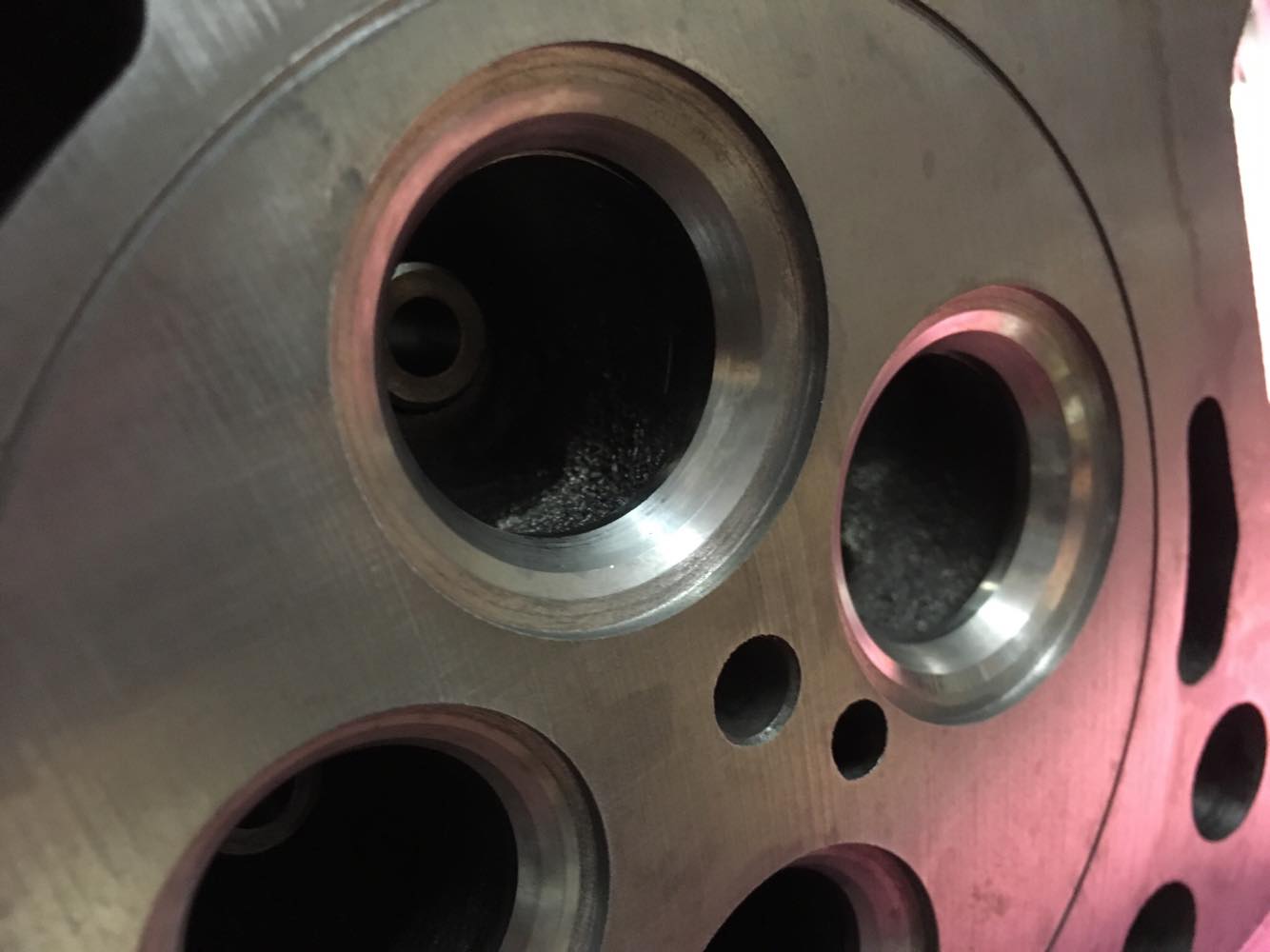

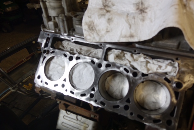

Cylinder Cleaning
I removed all the carbon build up on the very top edge of the cylinder by very carefully skimming the edge with a razor and oil then finishing it up with a Scotch Brite. This made the cylinder edge sharper and way less junked up. To avoid material from falling around the edges of the pistons I cut out oil absorb and fit it into the top edge of the piston. The rest was pulled out with a vaccum.
BEFORE
AFTER

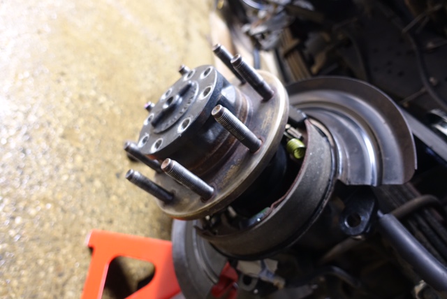

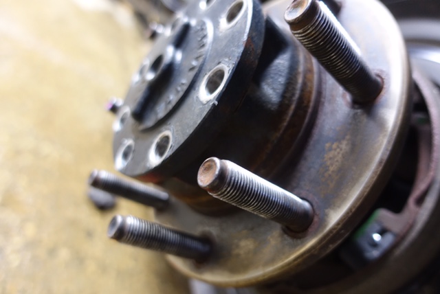

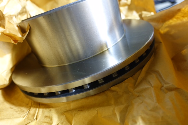

Rotors

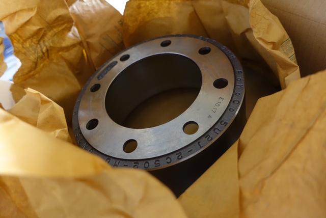

Also doing rotors all the way around, the rears were rusted to bits.

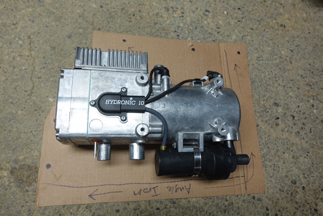

Webasto Mock Up
Started mocking up my Espar/Webasto. It'll go behind the transfer case and in front of the fuel tank on its own custom plate. The plate will have the mounting nuts tacked down so that I can get underneath the truck and pull the entire Webasto system, air intake, exhaust, wiring, and coolant manifold down and out for maintenance. It'll be fully enclosed or at least on two sides to avoid road debris.
I've been reading a bunch about truck bed camper systems. I'm hoping to have two seperate circuits, potentially with electronic zone valves. One just for the truck and one that goes up into the bed/flatbed to a set of quick connects then into a truck bed camper (In-Floor Heat). Webasto can heat just the truck or just the truck bed camper or both. Also the engine can heat the truck bed camper while its running. Hopefully everything will have some sort of quick connect system and can be somewhat automated through some zone valve switches. 5 Year Goal is to to live in the truck and camper for a few years while I circumnavigate North America. The more connected I can make the camper to the truck the better. Hopefully the charging system of the truck can also charge the battery system of the camper and maybe vice versa with the solar panels on the camper - this is why I am adding the dual alternator kit to the truck.
This is the company I hope to build with in a few years. Still not sure if I will keep the bed on or not. Ill at least have the truck 100% dialed and ready.
