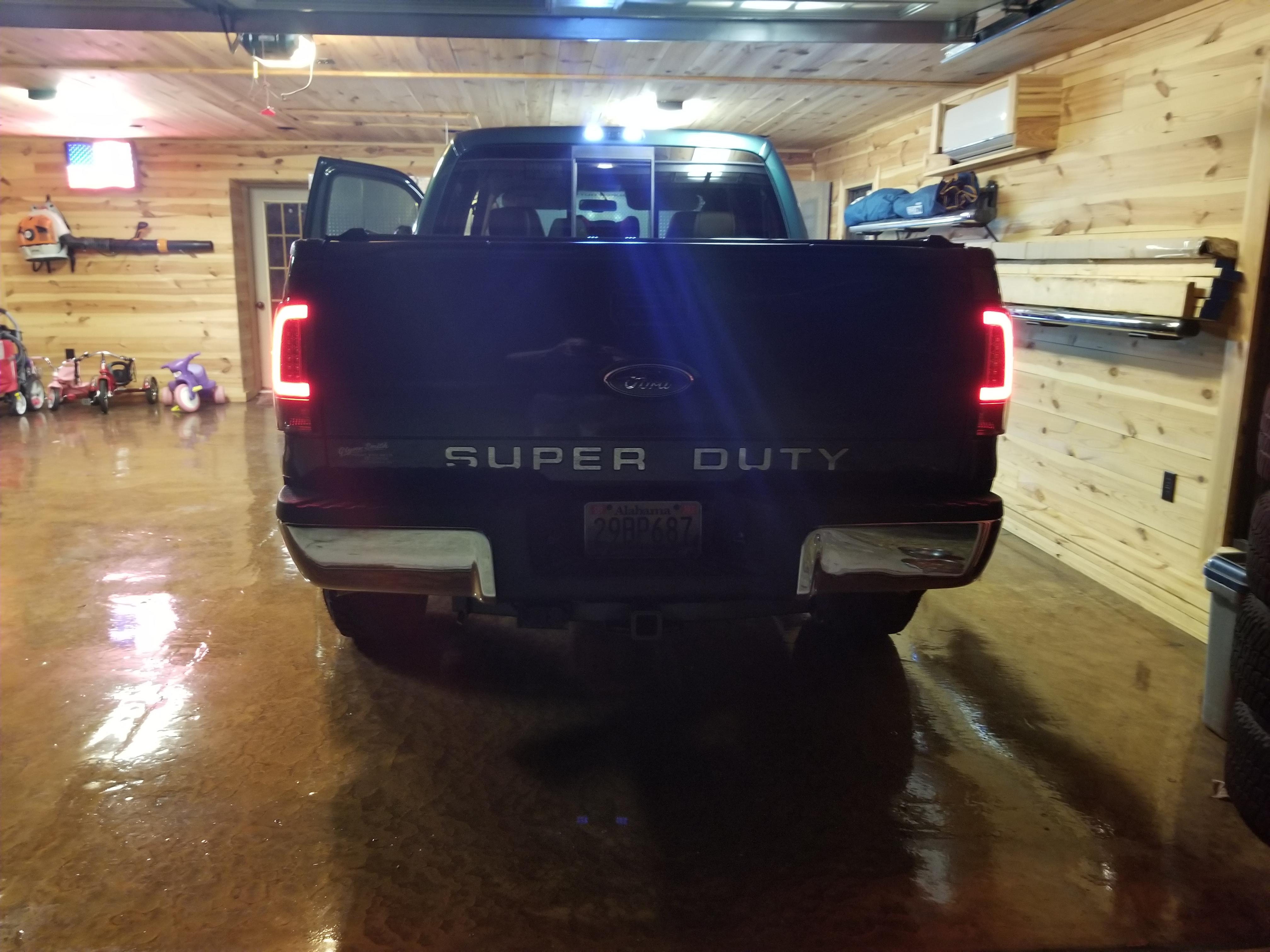

Tail lights...
I have those tail lights to my truck they were paint match from retro customs they are awsome and look good at night

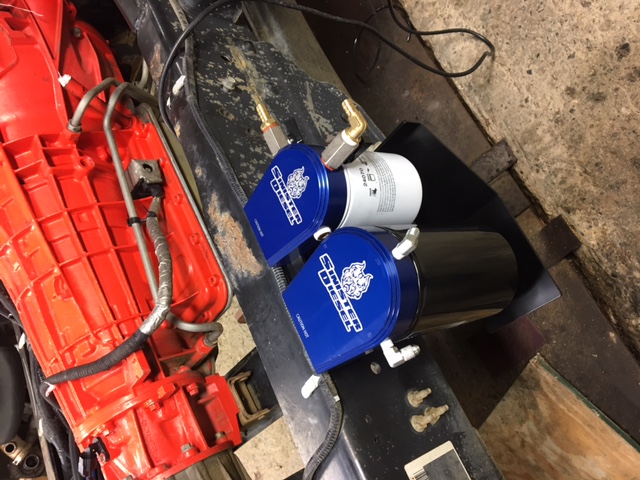

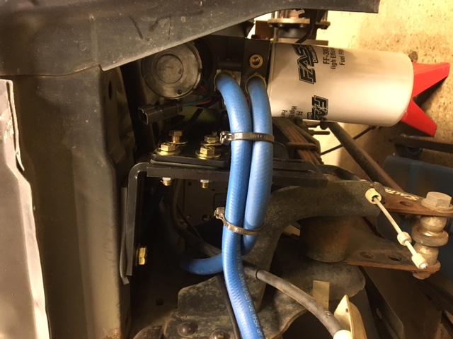

Progress Post

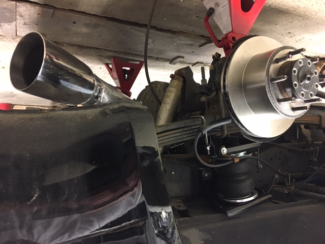

FASS 150 GPH Low Pressure Pump Installed
External Filter Kit Installed
Sorry about the images being all flipped around. No matter what I do they keep flipping around.
Had to use a angle grinder to get the old tips off, they were stuck! Cleaned up the tailpipe with a angle grinder, got new MBRP tips in. Gotta shorten the tailpipe a little to get the look just right.

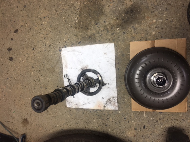

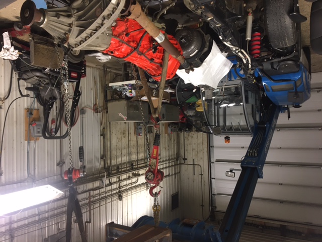

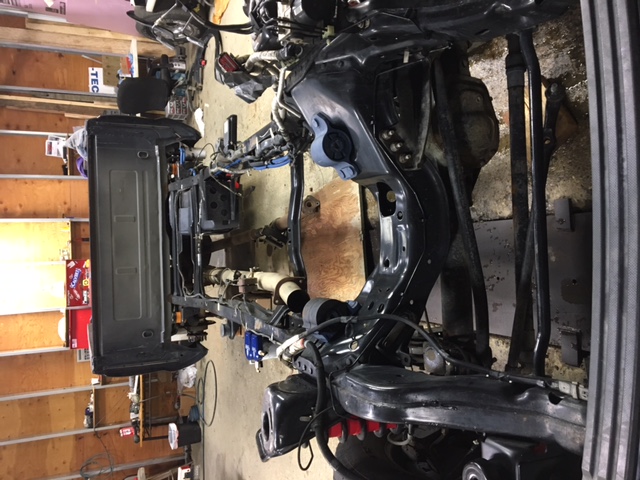

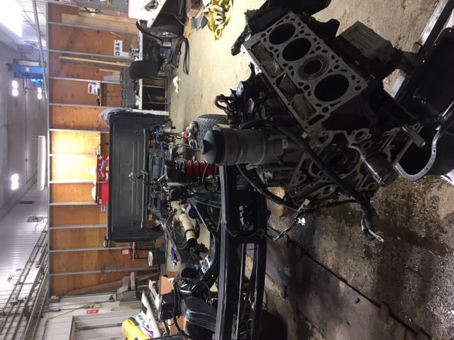

Progress Post - Cam
Got the cam out. Made the rookie mistake of not unbolting the torque converter and pulling it with the transmission. I don't think I would have been able to get the nuts off from that little hole anyways.
Gonna do new motor mounts, flywheel, and starter while I'm here.
Still waiting for the cam, UPS guy forgot one package when he picked up all my stuff from the shop.

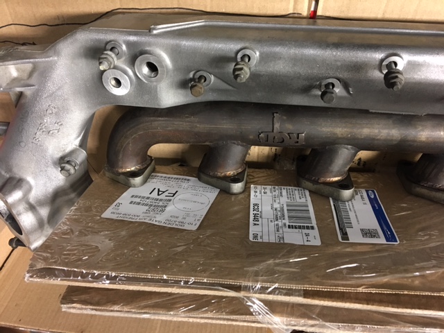

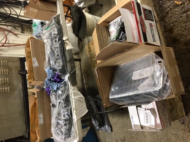

Got my new coolant tank, RCD manifolds, and O-Ringed heads in.

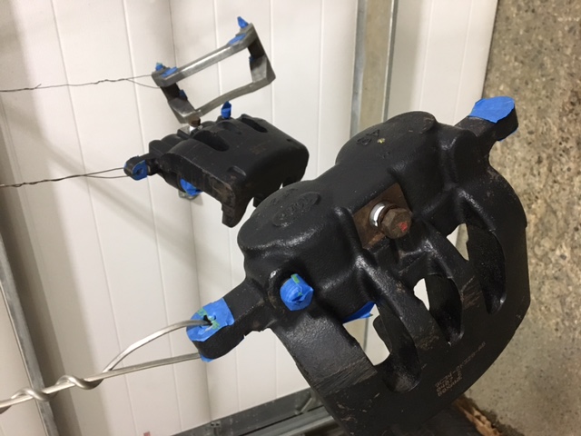

Painting
Painting & Parts
