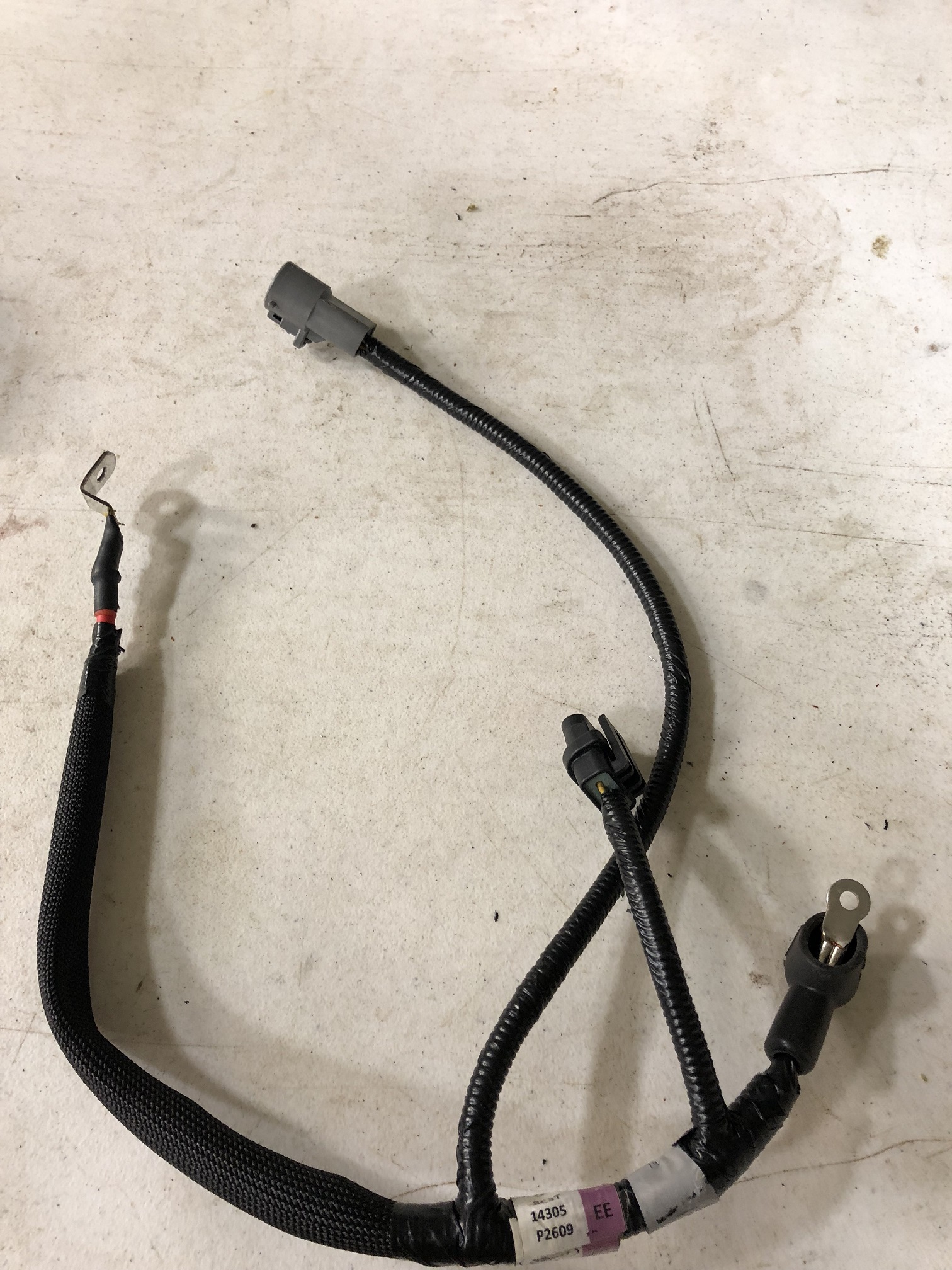

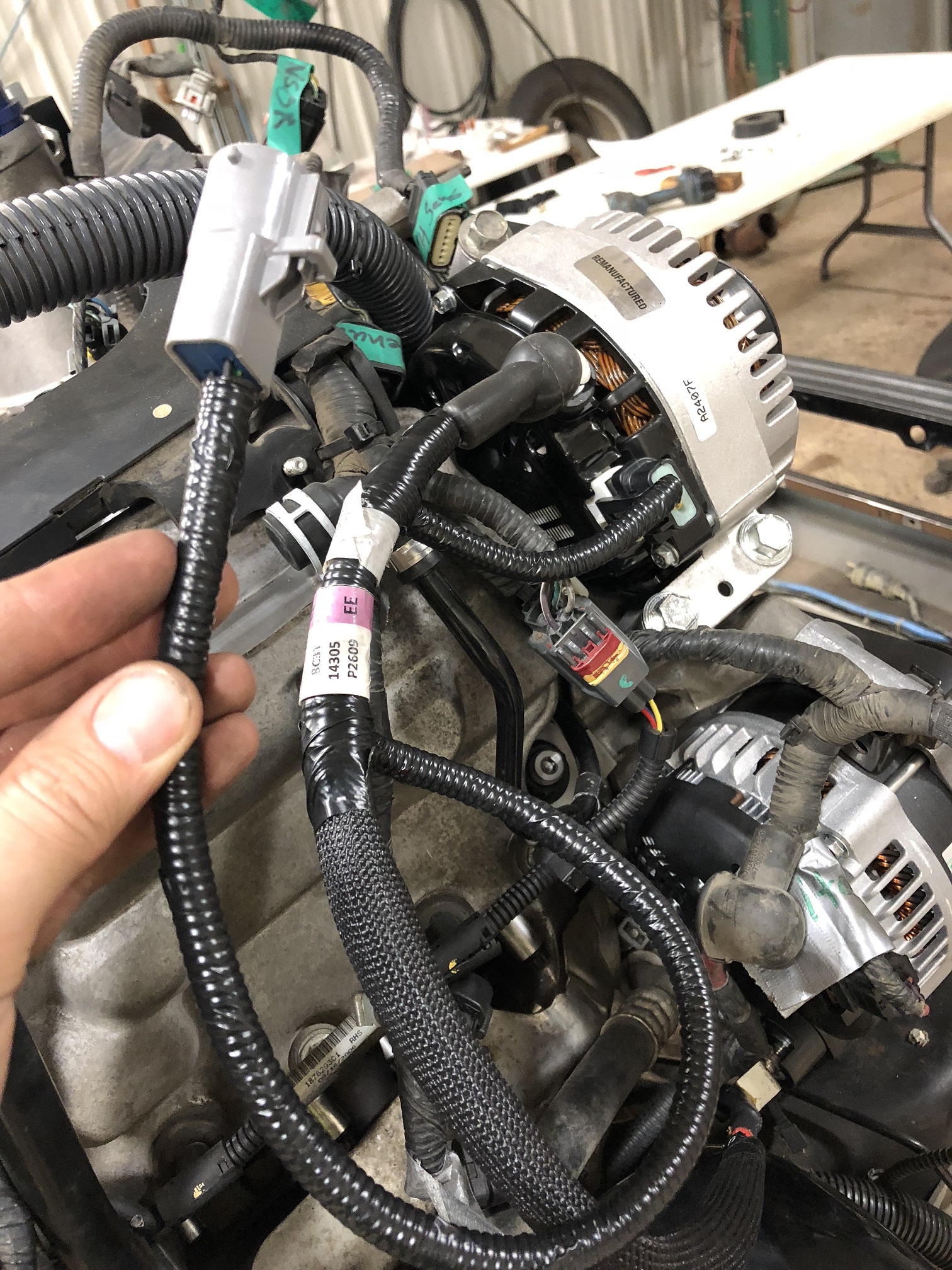

Alright, so I got some questions on this whole adding dual alternators project I got going on this truck.
I need help identifying where this plug goes on this additional wiring harness that I purchased from ford.
Here is a link to the bulletin I have been using:
https://madocumentupload.marketingassociates.com/api/Document/GetFile?v1=4309010&v2=053118092833&v3=60&v4=fba306494be3263f4f061d8061bdfa20aeb8bd42486d1e04fc261dfa&v5=False
I ordered P/N 8C3T14305E / 14305
That is that part number:
I may need to just wait til I get the cab back on and can find the right connector but I cannot find where the other end of this plugs in at?
Anyone else have experience adding a Dual Alternator to a 2008 Ford with Diesel Engines?

That will plug in once the body is down. The plug is on the rear side of the passenger battery tray, by where the factory bottom portion of the air box mounts.

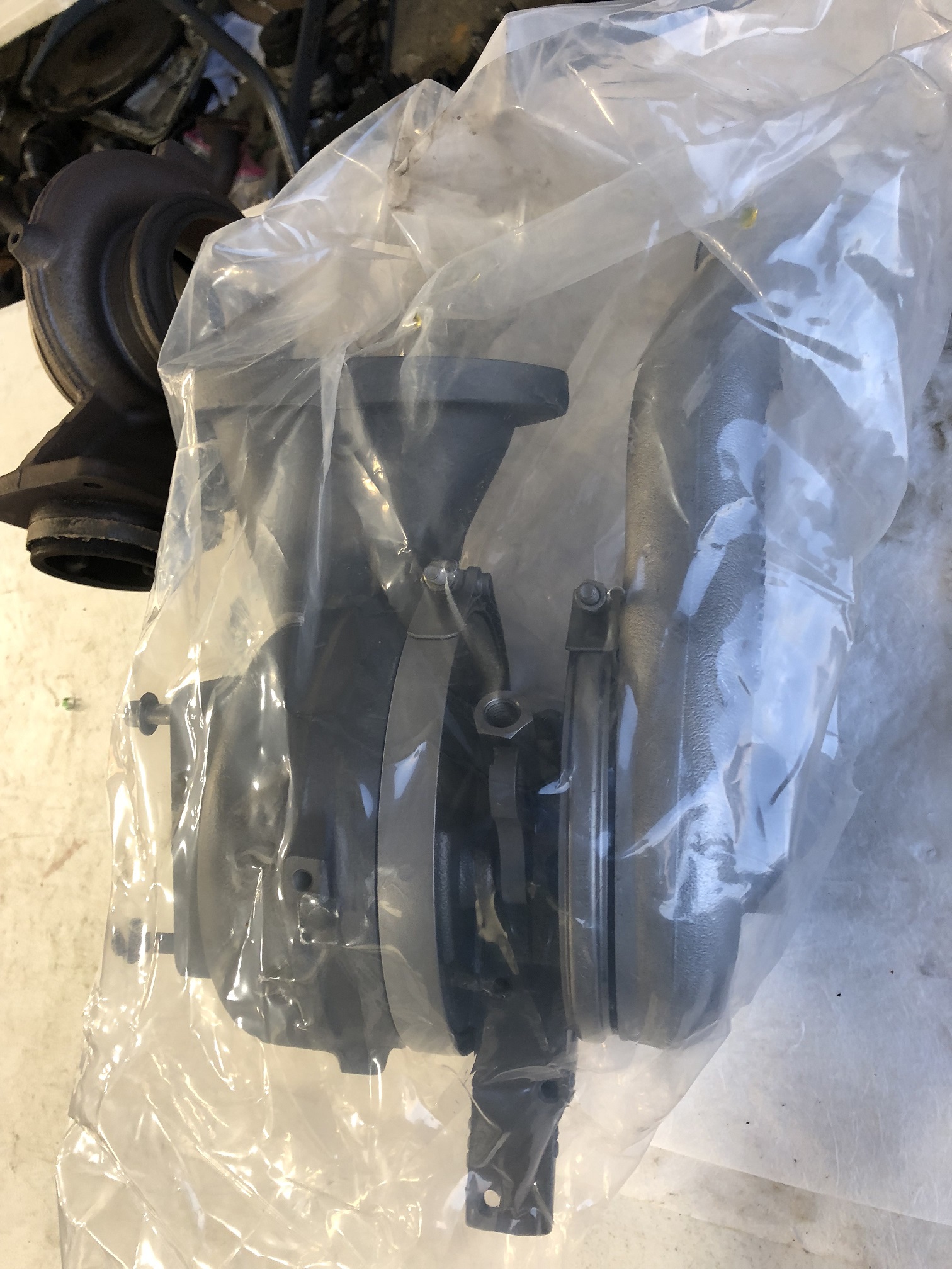

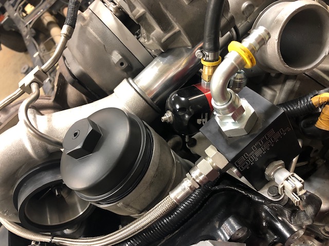

Got my new matte black powdercoated ODAWG intake in the mail and installed. Great product and install besides having to chase threads on one of the sensor ports.
Got my turbos in finally! Just need to do the final re-assembly on them.
Cleaned up some rust spots on the frame and am doing the final mock up on my webasto install
Once I get my turbos mounted, up-pipes mocked up, and wastegate dump welded into the downpipe its just final button up of the webasto hydronic lines & wiring, external filter lines, helper air bag lines, low pressure fuel pump wiring, and all the various ford hookups, etc

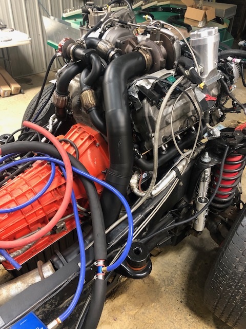

Hello out there!
I've been back at it for the last two months finalizing the last details of the build. Got my manifolds, up-pipes, and downpipe back from ceramic coat. Got my Espar Hydronic heater all plumbed and wired in. Got my on-board air system re-plumbed and wired in.
Cabs in the air over at a friends shop and we are hauling the chassis over tonight! Startup videos hopefully coming soon!

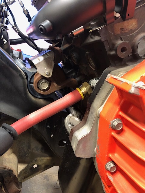

Espar Plumbed right into the side of the block
Additional vent added on drivers side since I had to remove my passengers side back in the day to fit a subwoofer
