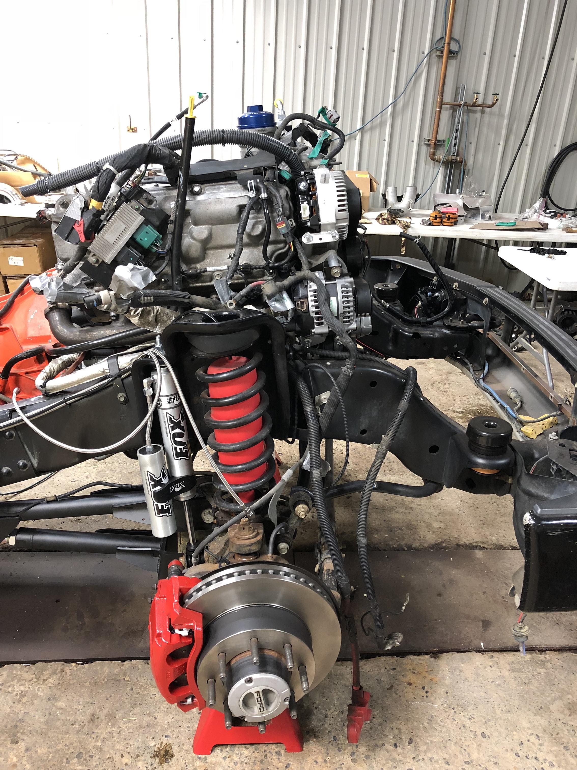

I can now happily state that my Jr High Powers have been fully rebuilt with a fresh high pressure turbine wheel and a new exhaust housing. I also have to happily state that Jared Rice at Midwest Diesel is one stand up guy. I bought these turbos from him almost more than a year ago (he had no idea they were in the shape they were) and he is helping me get everything taken care of with Elite. Pretty rare to see someone make something right after so much time has passed.
Since I've been waiting, got the 3 link installed.
Finalized my full brake job on the truck, new rotors, pads, and a fresh red caliper paint job all around.
All the belt tensioners, belts, alternators, and harmonic balancer are all mounted up.
Holes for the webasto mount are drilled in the frame and nuts have been welded to the top of the plate for easy installation. Getting excited about the final mounting, I think its gonna turn out really clean.
Also, finishing up the body work on the tailgate handle relocate.
Once the turbos arrive I can mock them up, mount the up-pipes, and get the wastegate downpipe dump welded in along with my CCV exhaust dump. Once that's done, its final wire running, double checking, and the cab goes on!

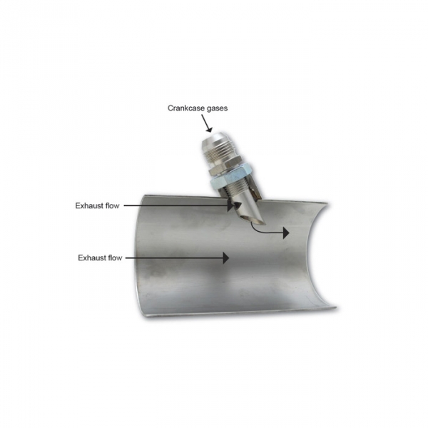

Next Up..
I'm trying to find who has a VIBRANT Mild Steel E-VAC Scavenger Kit in stock
P/N 11189
Ordered one from CPPdiesel.com and got a message back that the manufacturer has discountinued the product.
Other Options?
