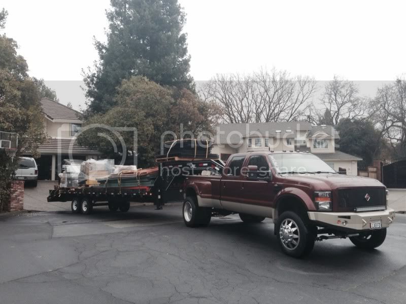

Well I thought I would make a new post after having it installed a little under 2 weeks. The fit and finish of this radiator is very nice and every mounting tab and bolt hole are dead on where they need to be. I was not expecting to see any drop in temps but right off the bat I noticed a 4 degree drop on coolant from my normal 200 temp rolling down the highway to 196 now rolling down the highway. I saw an even greater difference in temps when I was towing into the Sierra's up to Reno from the San Francisco area, I start at sea level and climb to about 7,000 ft. On this trip I had about a 14,000 lb trailer and at the summit of donor pass I am normally about 225-230 on coolant temp. On this trip when I reached the summit I was only at 210, thats a 15-20 degree drop from what I normally was and I was shocked that is was that much of a change. Here are some pictures of it being installed
Here was the 14k load that I had going up to Reno
