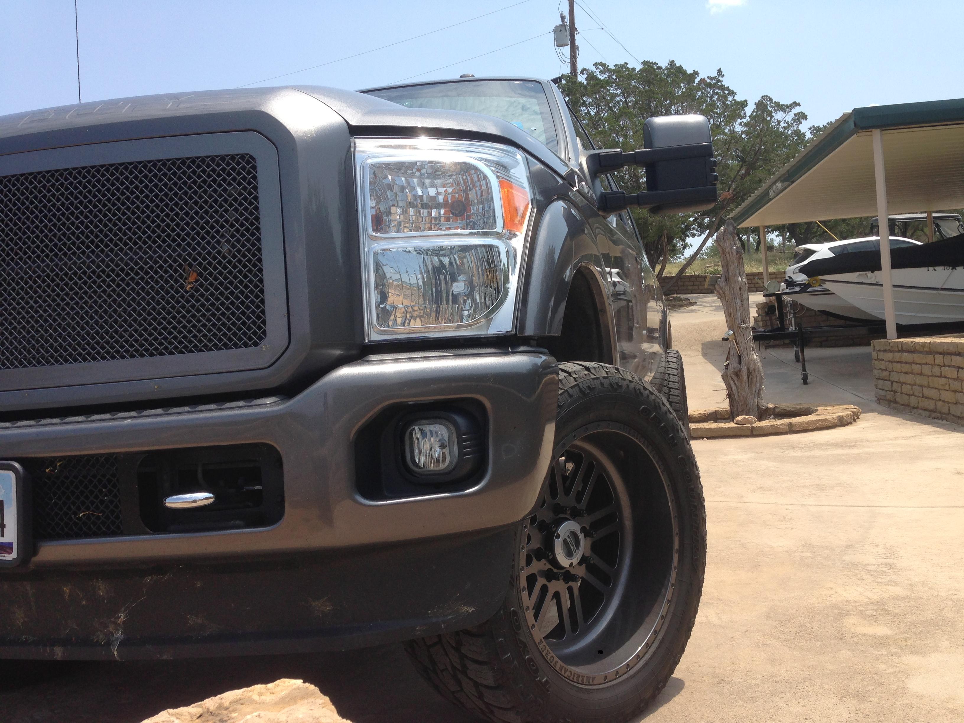

I have the 22x10's with 325/50/22. Just a 2" spacer in the front. Backing up they rub on the fog light housings at full lock. Normal fender well trimming..
