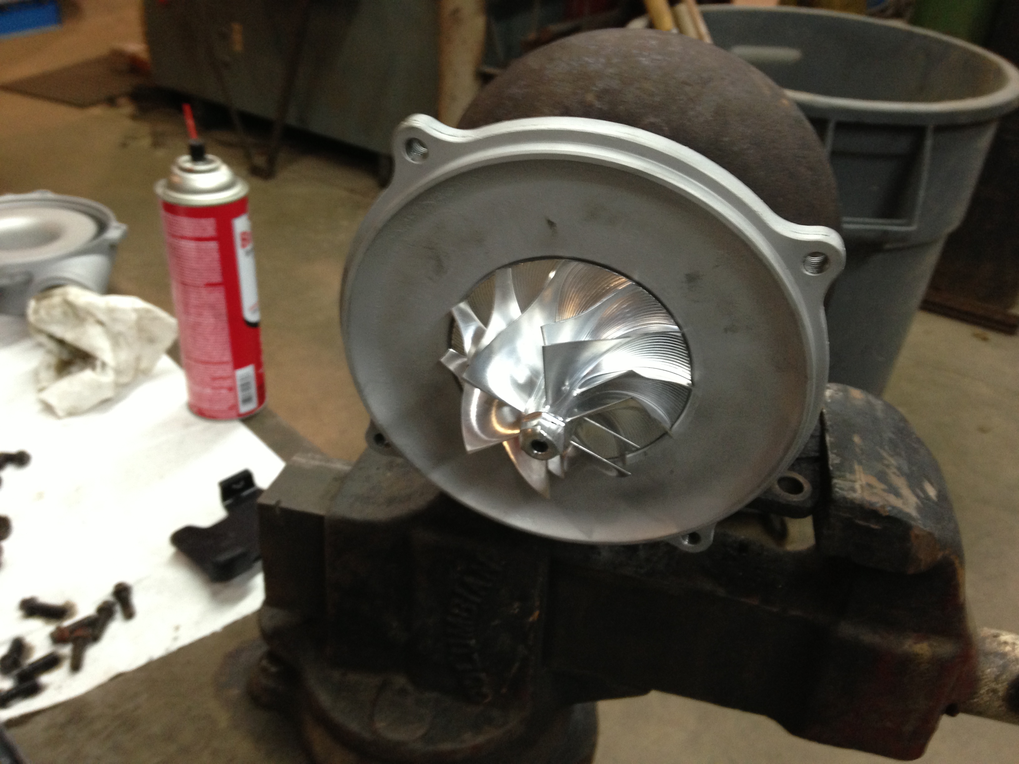

Waiting for the hydraulic shop to open up on monday to get the rest of the fittings for my fuel system and then we'll see how she runs...:pimp:

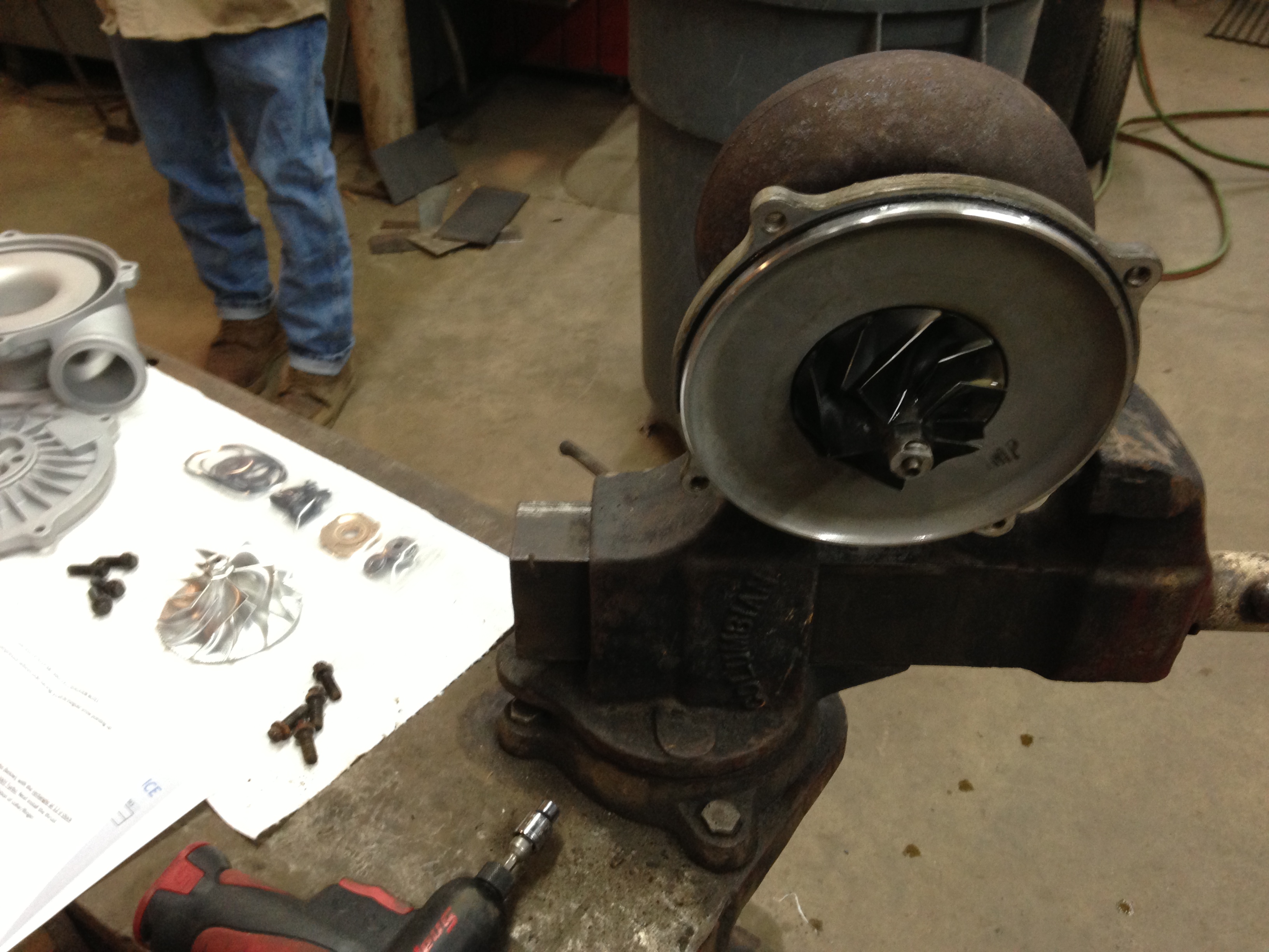

Stock OBS non-wastegated 1.15... should make for a nice setup.
I'm guessing you could go tighter on the exhaust housing without any ill effects, but for a non wastegate housing I'd like to be on the safe side and keep the bigger housing. Thats all just speculation on my part though, I'm sure Mr. Barder could tell you for sure.
Also I can tell you that it protrudes at least 1/2" farther into the cover than the stock wheel as well as being larger overall. It really looks like its going to move some serious air for cheater turbo...

Install was easy, acts just like stock on stock tunes and injectors. Whistles a little louder.
Hopefully getting time to install the stage 2's this weekend !
