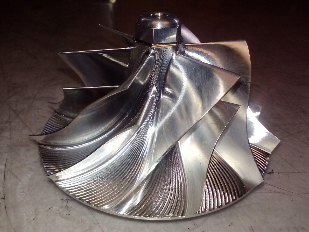

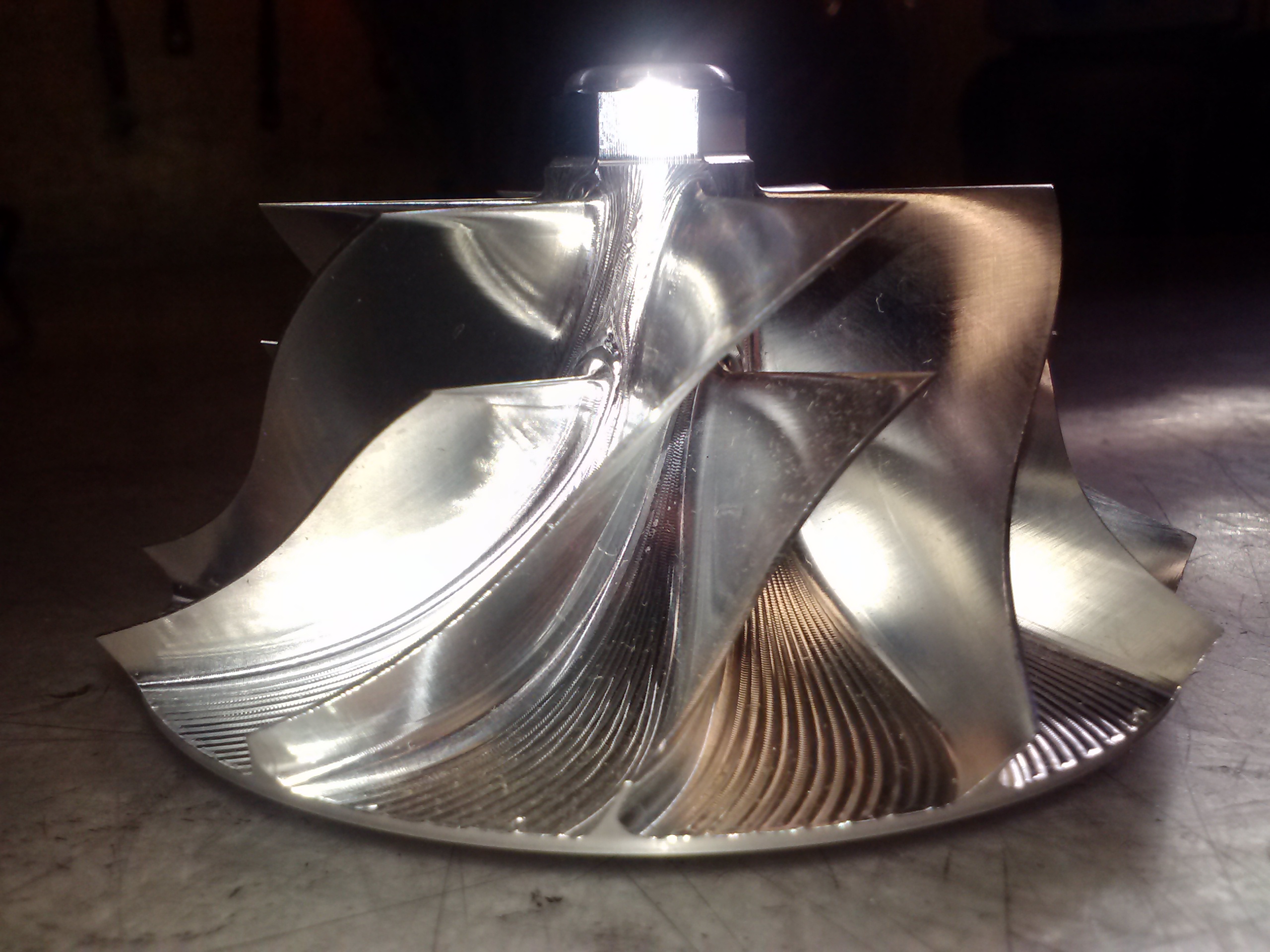

My new designed Billet 38R Compressor wheel. 66mm x 88mm exducer, Extended tip exducer. 6 Blade deisign.
Fits GTP38R turbos and my Modded Stock 66mm turbos.
This wheel is the wheel that will be used in all of my DIY 66mm Kits.
I do not have results as of now, but will be having guys doing testing on a few turbos.
PM ME FOR INFO and PRICING.

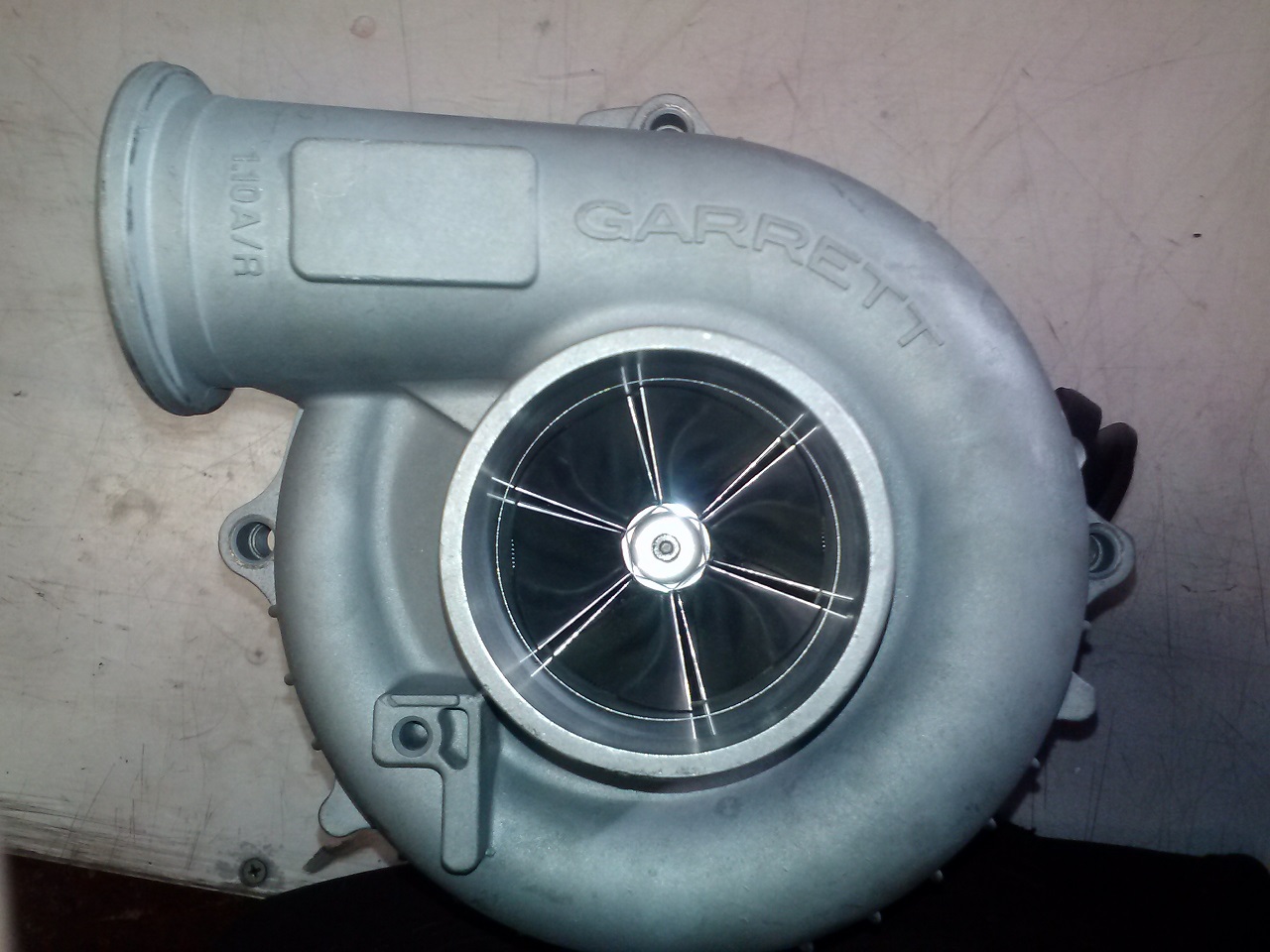

I will be getting dyno results soon... Hopefully a week or two. Stock cw, WWG2 66mm, and my version of the 66mm
Truck is an E99 zf6 175/80's t500 stock fuel system with Walbro pump. Motor has horribly blow by and 240k on it. Not sure what it will do :/

whats the new design consist of? looks sorta similar to a stock 38r wheel other then shiny.

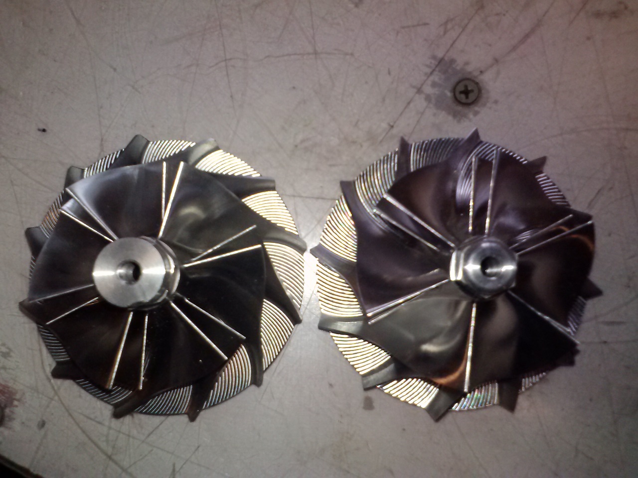

Blades are 20% taller, center hub nut has been reduced from 18mm down to 14mm, So thats 4mm more blade surface over the cast wheel. This wheel is also extended tip exducer out to 93.6mm.

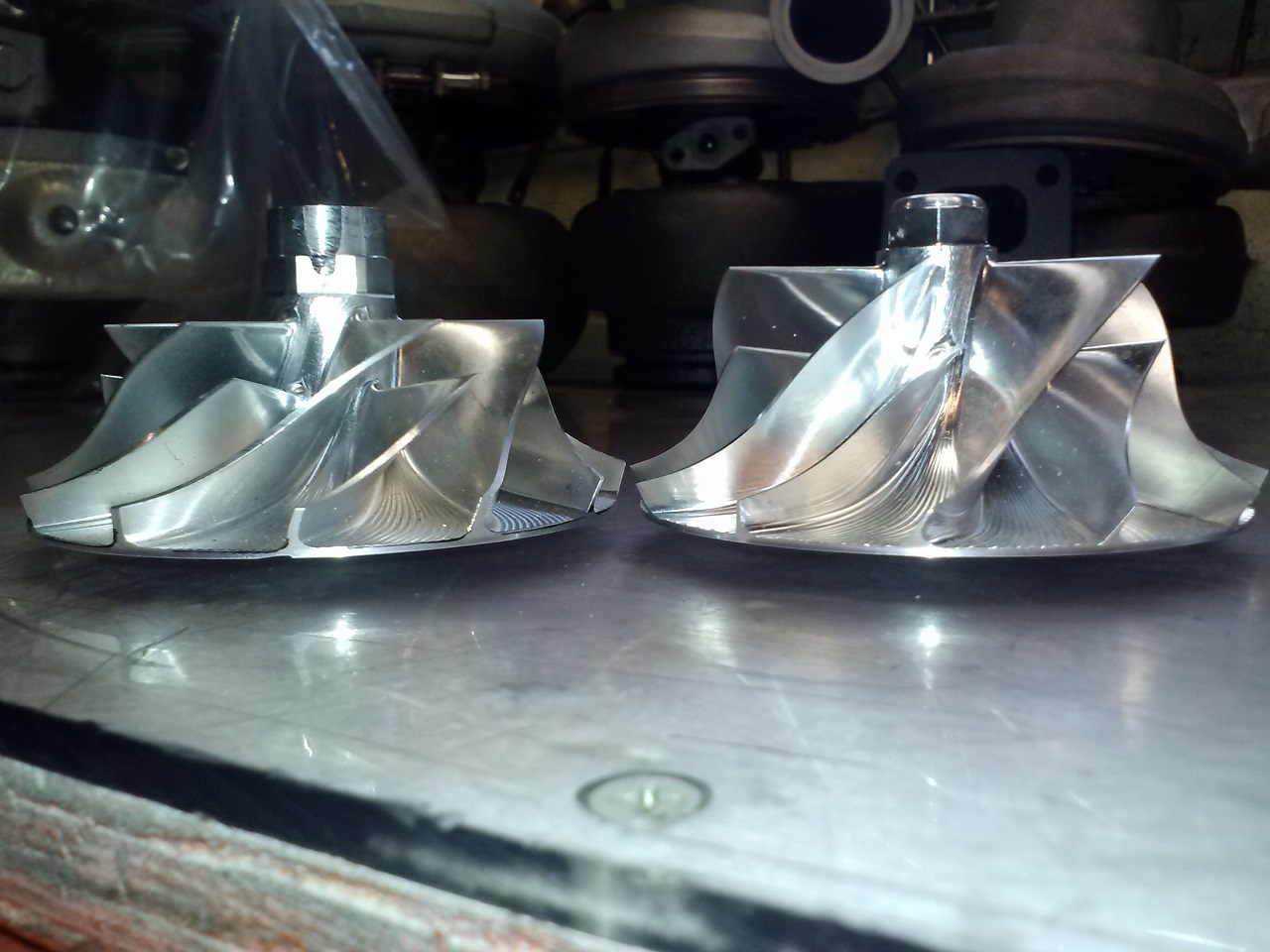

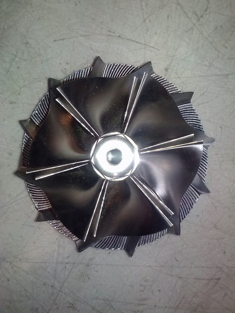

The wheel on the left is a Billet Extended tip version of the GARRETT GTP38R wheel, besides extended tip it is a replica of the cast o.e. 38R wheel.
The wheel on the right is my version of the GTP38R wheel. Taller blades, Smaller center hub, and extended tip exducer.. And is much lighter than the cast version.
Neither wheel is associated with DieselSite or the DieselSite ww2 or ww2 for GTP38R.

sweet! thanks, that makes a big difference, i thought for a second there you where comparing the stock turbo ww2 to your version of the 38r billet wheel... thats a big difference in wheel design...

I'll tell ya'll one thing, that wheel is gonna screw it's way into the air a lot better...
less hub, more and longer blades....uhmhummmm...
