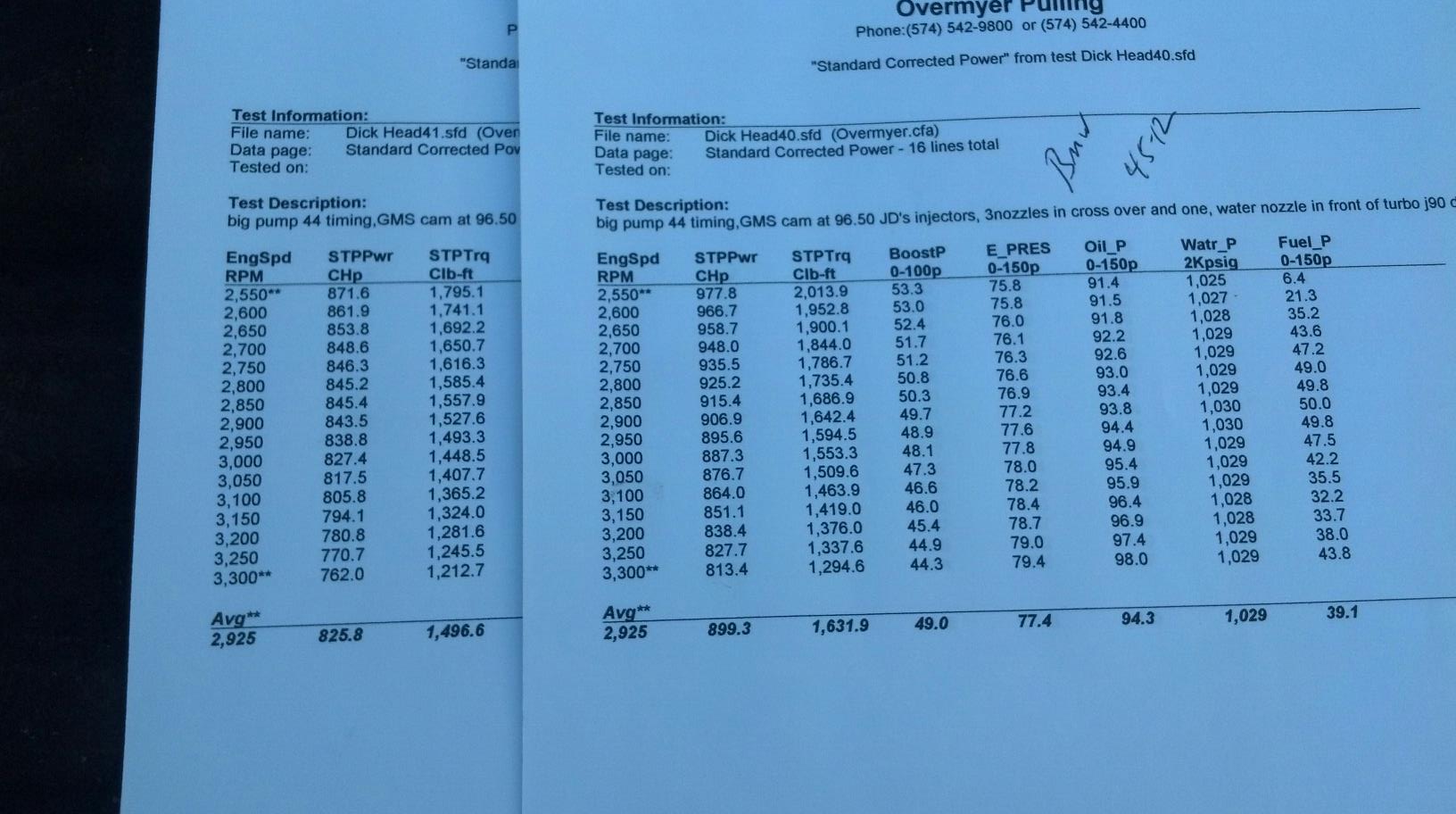

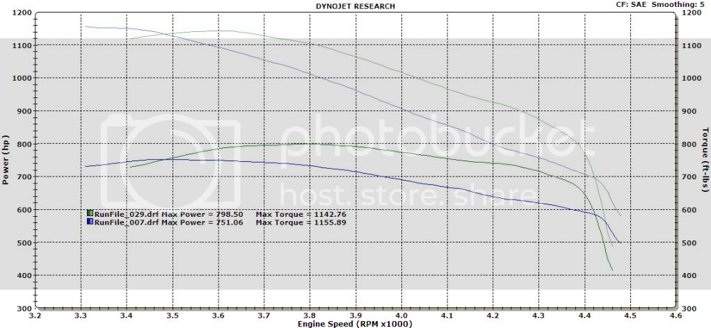

Batmowheels are overhyped wheels that dont flow as much as normal billet wheel from say precesion or garrett. Tadd from Elite has proven it.
Here Tadds precesion with billet wheel vs bullseye/batmo dyno chart.
IMO batmowheels are too expensive for a crappy wheel and almost nothing to show for what your paying for.
This graph was running extreme street. Once extreme race was loaded, the differential was larger. Peak power favored the precision by 27 horse, and 100 horsepower at 4,000 rpms. Once more fuel was added the bullseye didn't perform as well.

What's some more specs on the graph.. like what turbos from each company, it still isn't apples to apples unless it is the same turbo that gets the two different wheel put into it....hopefully rcd will put out graphs soon, I think the billet will win but I'm still interested

One was a ball bearing full precision 75mm the other was a double bat 475 with that fancy cover. Best of the best from each company turbine wheels were almost identical size too. Same truck same dyno same day
