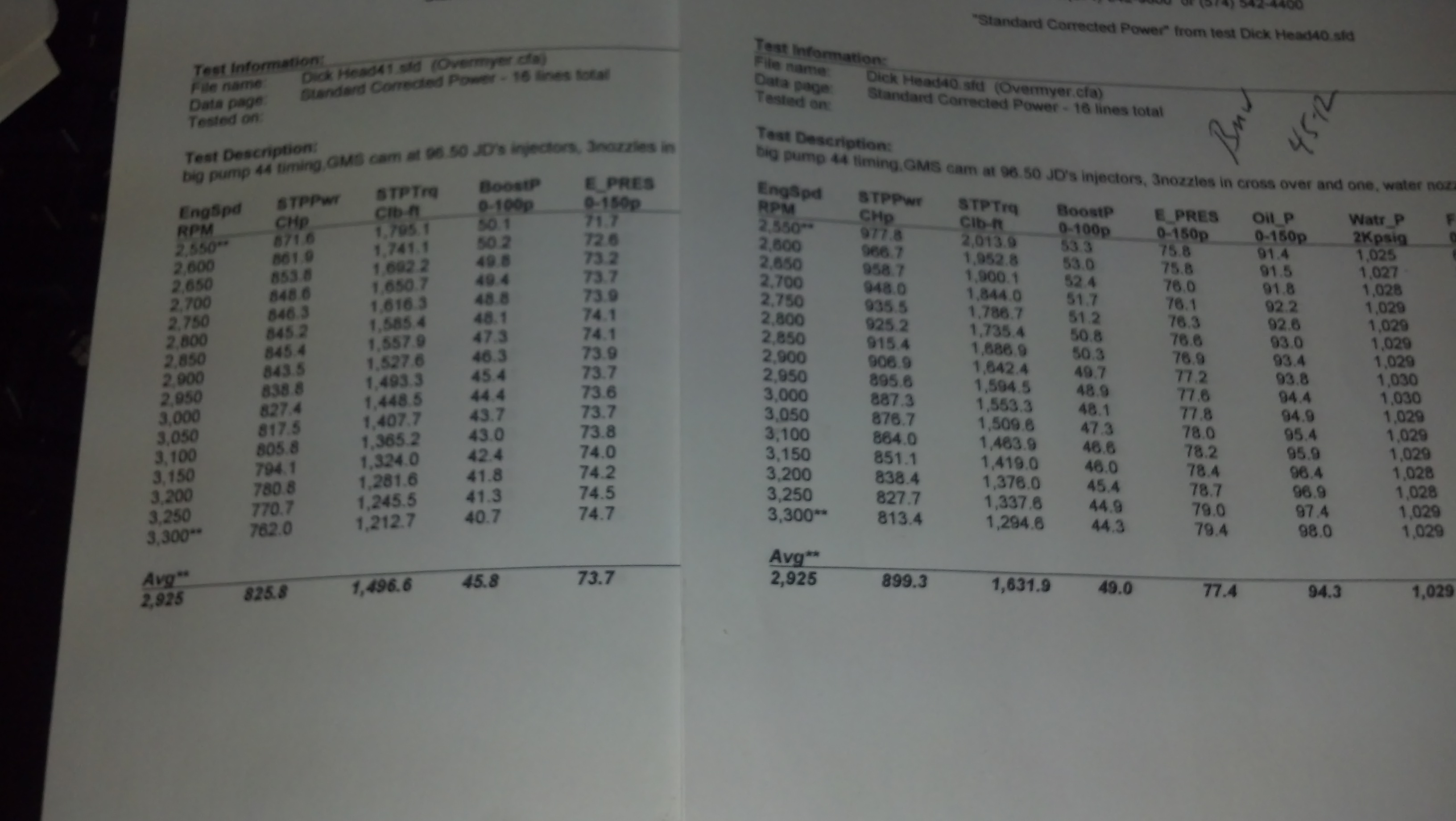

I ALSO RECENTLY RAN YOUR BILLET 75MM WHEEL VS BATMO WHEELAND SEEN A GAIN OF 90HP WITH THE BATMO WHEEL. JUST THOUGHT YOU MIGHT FINDTHAT INTERESTING.

heres full graph

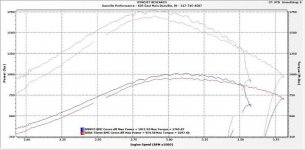

Thats a crazy huge gain. Do you have more specs on truck or charger? Any chance we could get dyno graphs of those?
It would be sweet if we could see the curves in relation to each other.

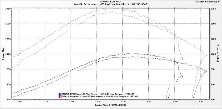

Danville performance
billet vs batmo
You would have to email curt haisley he just provided us with those numbers

Just so im clear they are comparing a 7 blade billet bullseye compared to the batmowheel right?
Craig@MFI
2,184
The one with the engine dyno was billet vs batmowheel
