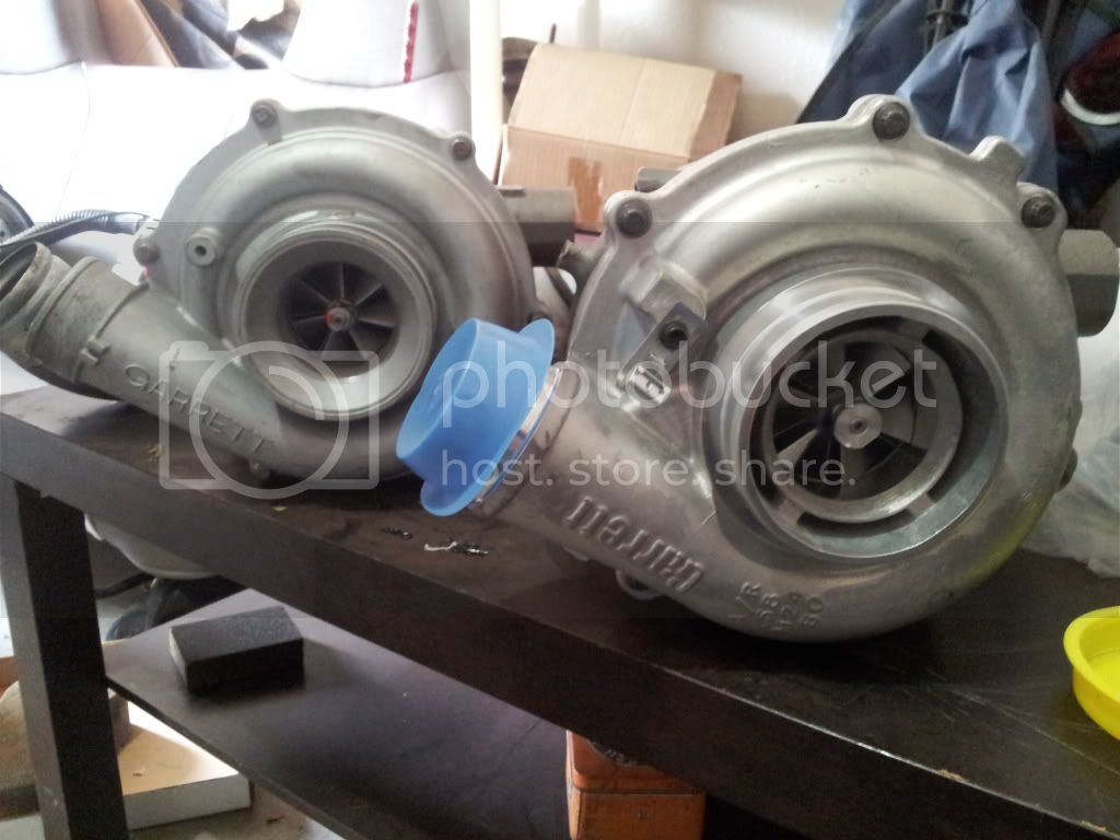

I dont know either. I guess it can push past a seal somewhere. I talked to Matt today and I will be dropping it off with him tomorrow. He seems to think its the turbo as well. He said he has seen some rebuilds get a bad seal and not hold up. Im thinking maybe I overfilled it which caused to much pressure and messed up the seal? I dont know enough about this thing yet to figure it out. Hopefully I have it fixed by the begening of next week.

my money is on turbo, although ive been wrong before, i have seen a few turbos on their way out over the last few years since i became a diesel mechanic, and your truck seems to exhibit the exact same symptoms

Well Matt said it was the turbo. He pulled it off and checked it out said he could see some oil somewhere and that it was a little low on boost when he was driving it.. And he said everything else checked out fine. So I ordered a Pmax today.
Will post final results once I get the new turbo on.

His screen name on here is BroncoF250444. He was a Ford certified master diesel mechanic and member of NTXPSA. He was working for Ford but just recently started his own shop. Mad Matt's Diesel Performance. There are a lot of trucks on this site he has had his hands on, from 7.3's through 6.7's. I've known him for 5 years and I am pretty confident in his work and abilities. He knew it was the turbo and told me how to check it but I took it to him anyways just to make sure. He ruled out every other possiblity before calling me back and didn't charge me out the ass for diagnostic time.

Got the powermax installed yesterday. Its not smoking any more. Finally got this one fixed.
