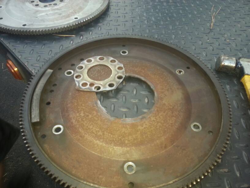

The noise is gone... well kinda... now kts just when it feels like it instead of all the time... wtf. Sounds like yoy don't have one joe...

Check to make sure the bolts are not working their way out of the flexplate... it will rattle like that if it is loosening up.

Either way trans is coming out.. if the bolts are backing out the plate is gonna be hammered and the bolts soo gonna need a plate one way or another.

Well its alive again!
It only took a few light taps from a hammer to pop the center out.. good thing for the ring under the bolts.. only thing that kept it together.
