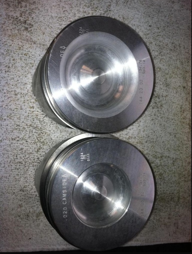

Have them machined to look like this? Valve reliefs cut also or no?

Just depends on your cam, how much you take off the block, heads, and if the Pistons are decked.
Those terms are new to me to be honest. What machine work does it take to have a reliable 650 hp? From machining of the block for .20 over, piston work and heads being plained and have fire rings installed?
