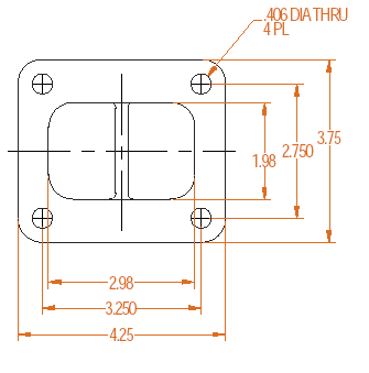

I hope I'm not shooting myself in my foot by putting in a T4i flange turbo mount. I can get a T4 flange also and weld it up for later by putting in flange connectors on the up pipes. Just will take time and more parts.
I think it depends on if you want to select from Holset/Bell turbos (T4i) or if you wanted to select from Garrett/Borg Warners (T04, aka T4).
Borg Warner and Garrett only sell one type of gasket for both last I knew....with the east/west dimension slotted the extra .125 on each side to accomodate the differences between the two.
T04 aka T4
T4i
http://i259.photobucket.com/albums/hh320/389SixPack/Turbo Flange - etc/T4iFlangeDimensions.jpg
I think this thread here about sums it up :hammer:
http://powerstrokearmy.com/forums/showpost.php?p=53594&postcount=4
