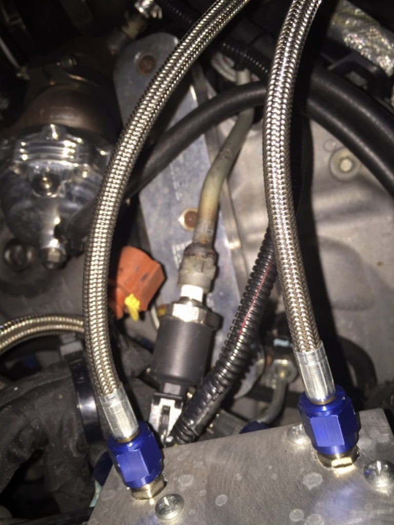

So I have all the starter and expansion kit edge parts can I use the psi sensor like my fuel sensor for the boost and one for the ebp? If so do I drill a new hole for the ebp. How do I mount it so don't melt it.
You'll need to make something like this
Copper tubing with compression fittings will work
