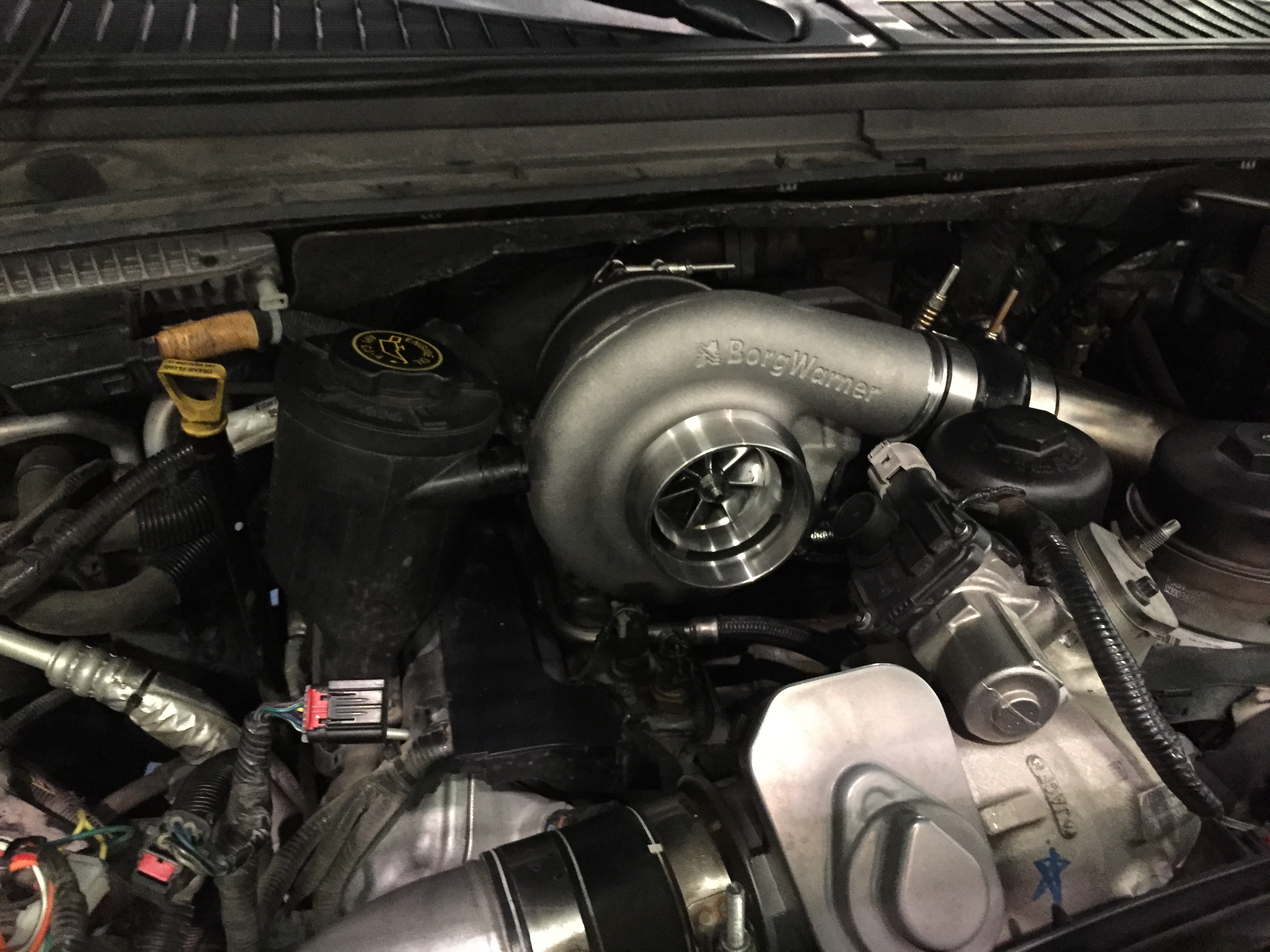

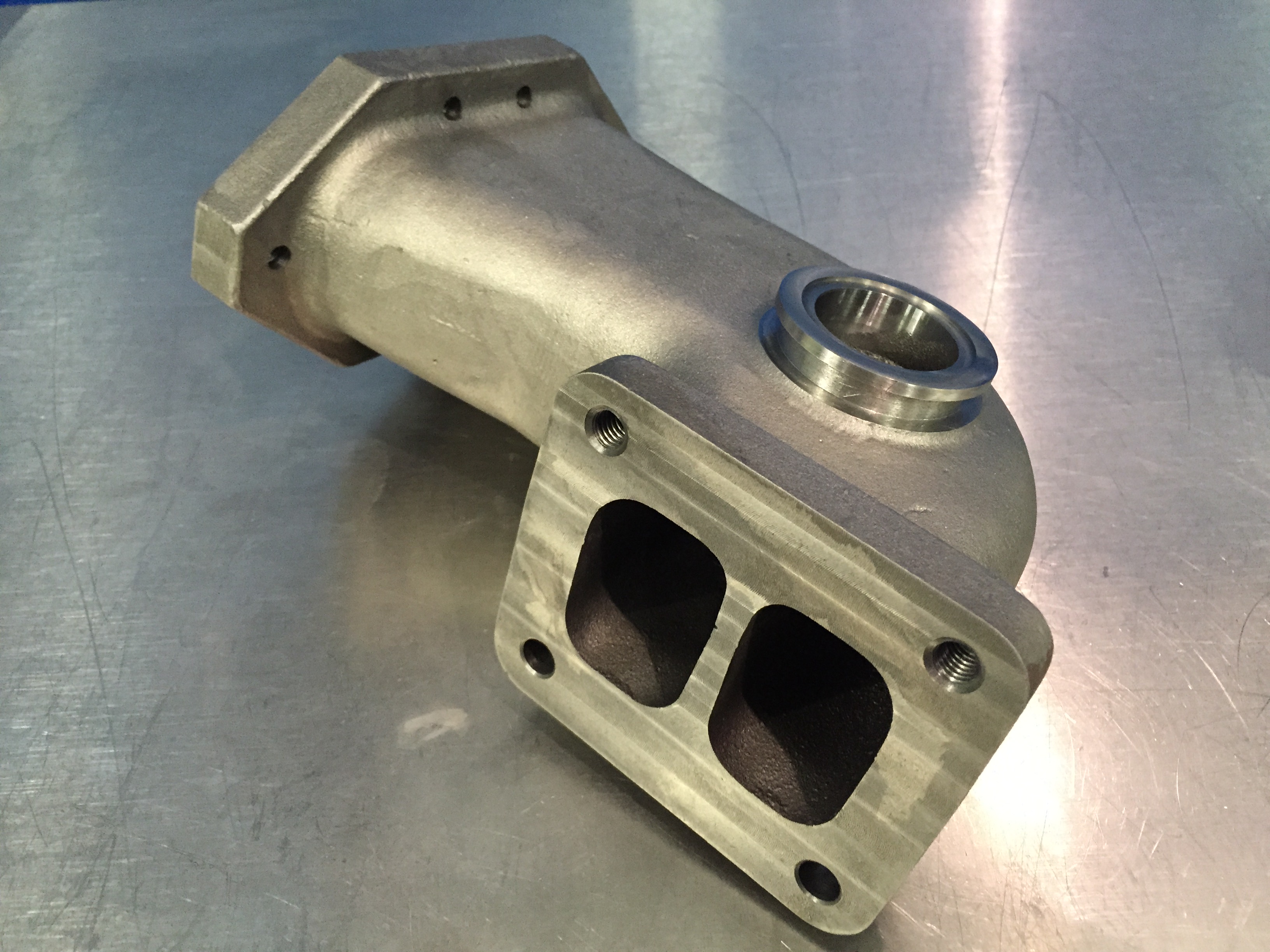

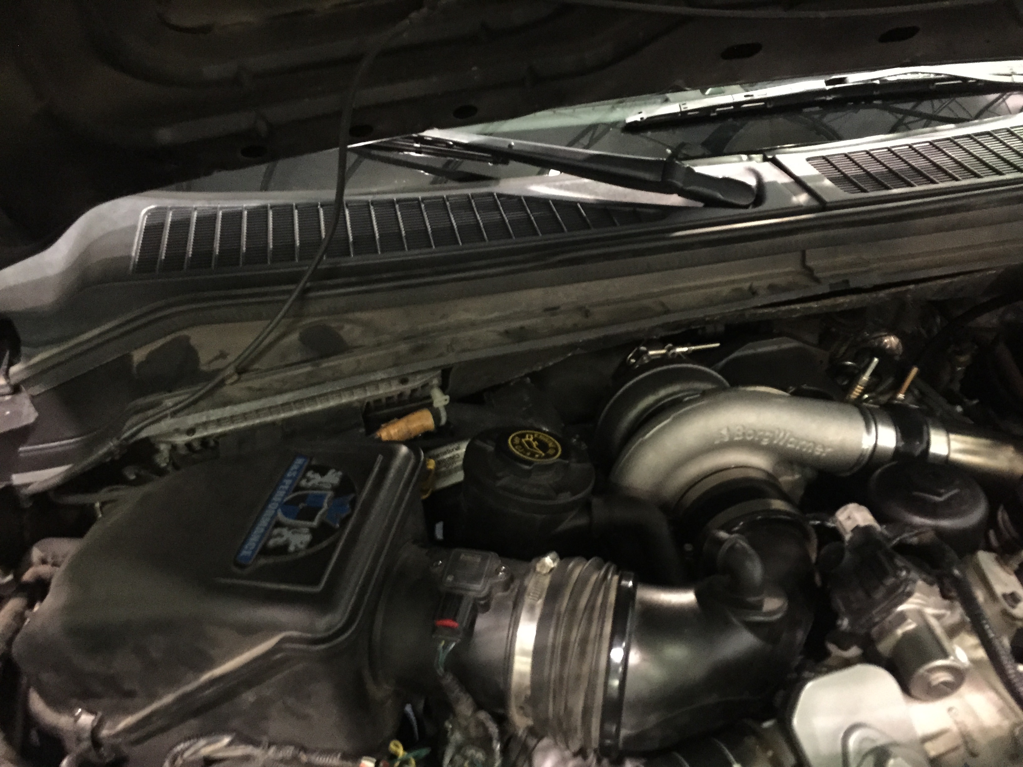

We have modded our 6.4 kit with all the necessary modifications to run all the Borg SX-E turbo's and have tested the 69mm first. Surprisingly drive-able on a 6.4. Not my first choice for someone who tows a ton, but fun to drive..... We'll try and get some data up here as we test all the sizes....

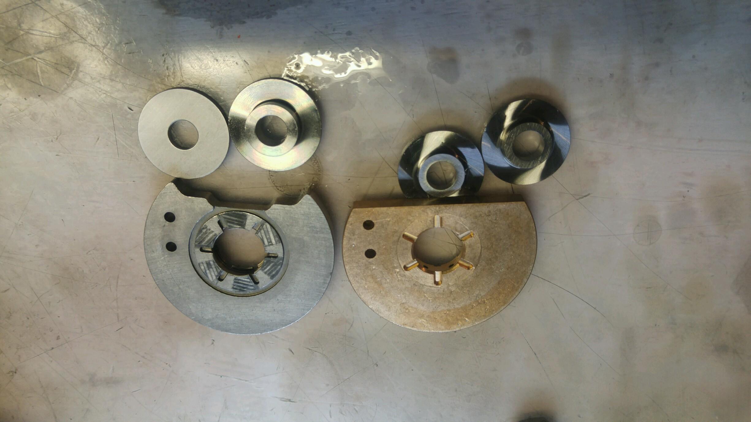

Educate me. Doesn't the 69 come standard with a 360? I assume their are different 360 bearings now?
360 steel upgrade. Next to the brass 360
The exact combo I've been thinking about since the pictures you guys posted on FB. Keep us updated!!
