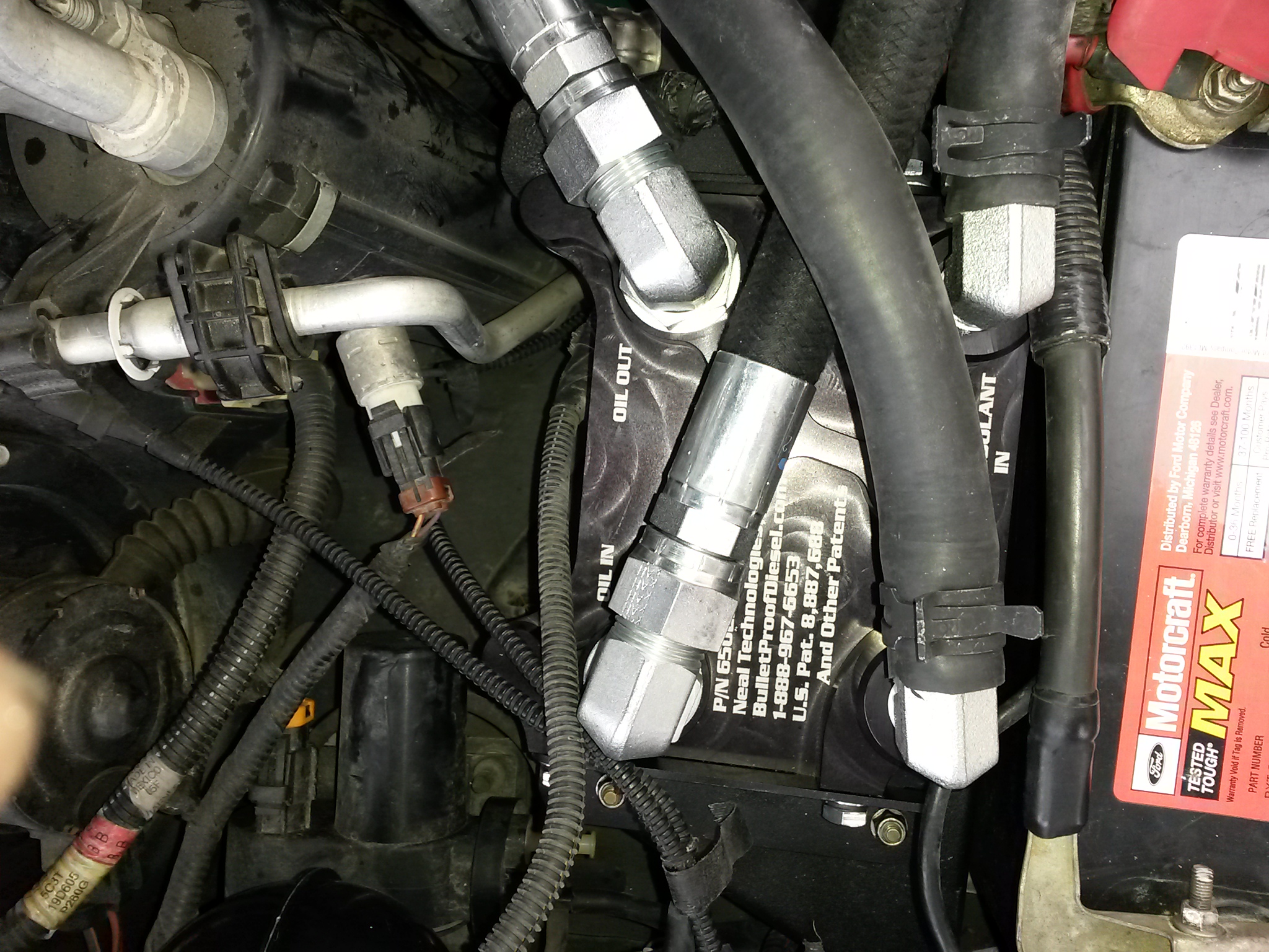

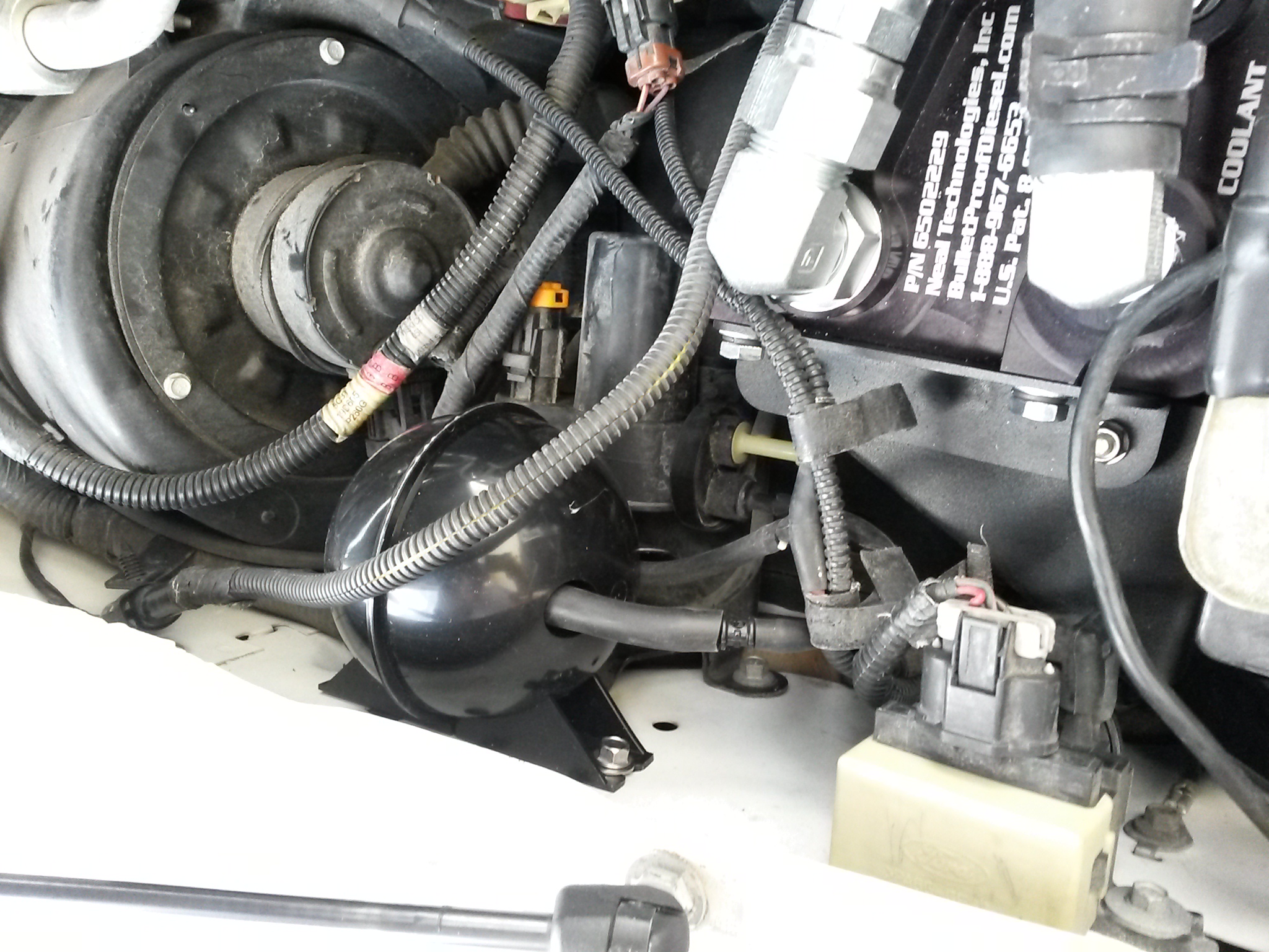

Well, I got a lot done on the truck yesterday. I had to take the turbo off about 3 times because I got ahead of myself. On the BPD Remote kit, which has good instructions, (that I didn't read) the hoses that mount on the plate are HUGE and have HUGE bolts. They are 1 5/16 I think it is. But You have to tighten those bolts on the ends of the two hoses BEFORE the turbo goes on because there is just no room. So finally got that done.
Then the turbo drain tube didn't look right to me, so I took it back off again. I'm glad I did because there probably would have been a huge leak! It wasn't in the engine very far. I got another 1/4 inch or so more.
Then another time I was tightening the drivers side bolts down and didn't realize that the passenger side mount in the very back wasn't sitting all the way down on the pedestal. Soo, again, took it off to get it lined up. Got it all situated, then the freakin back ban clamp snapped as I was tightening it down on the up pipe! *&^%ro ^@#%#*(^#^!!!! THAT was a $35 mistake and ford only had one in stock! THIEVES!!
SO, All day on it yesterday, today it will fire up I hope! By the way, heard a bunch of Harleys out yesterday, started to say hell with this truck and get on one of mine!!, BUT, priorities said continue on! Hahahaa

GOOD NEWS!! It's done! Once the oil pressure built up it fired right up. So far so good!
When I was cranking it over to build oil pressure.. had a.leak at the base of the oil filter housing. Took the 4 bolts loose and basically just barely moved it around , tightened it back down and seems to be good. There must not be much room on installing that? I suppose it has to be perfect, but sure didn't think it would have leaked like that!!?
Overall, it's not to bad to install this kit. Is is expensive though! Buy the COMPLETE kit if you decide to go this rough unless you want to be parts chasing for the little stuff like the vacume ball and bolts and vacume line. PLUS you cannot install the baseplate on the engine unless you have the oil cooler gasket. I got the oil cooler from somewhere else for cheaper.. if I had it to do over, I would have just got the complete kit.
On the flushing part of the coolant system, I bought a quart of that vc9 or whatever it is from Ford and distilled water. Took the thermostat out and ran the truck around the block several times and down the road. Pulled back in the driveway, let it cool off some and pulled the block drain plug out and drained it.THAT CHIT WAS HOT!!! SO BE CAREFUL!!! Then put straight distilled water in. Repeat the process. THEN pulled the heater hose off, drain plug on the radiator and the block drain, and ran the water hose through everything. Then dumped 3 or 4 gallons of distilled water through it again, with truck running. After that, put the new thermostat in and filled it with peak 50/50 mix antifreeze (cat1 approved!) I went over kill on the flush bit I had the oil cooler rupture and that was disastrous!
