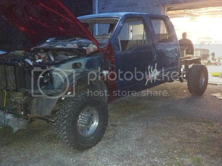

not much in the way of pictures this round, but got the wiring all squared away, brakes bled, coolant filter installed, temporary trans and drive shaft insalled, all fluids filled.
and she moves !

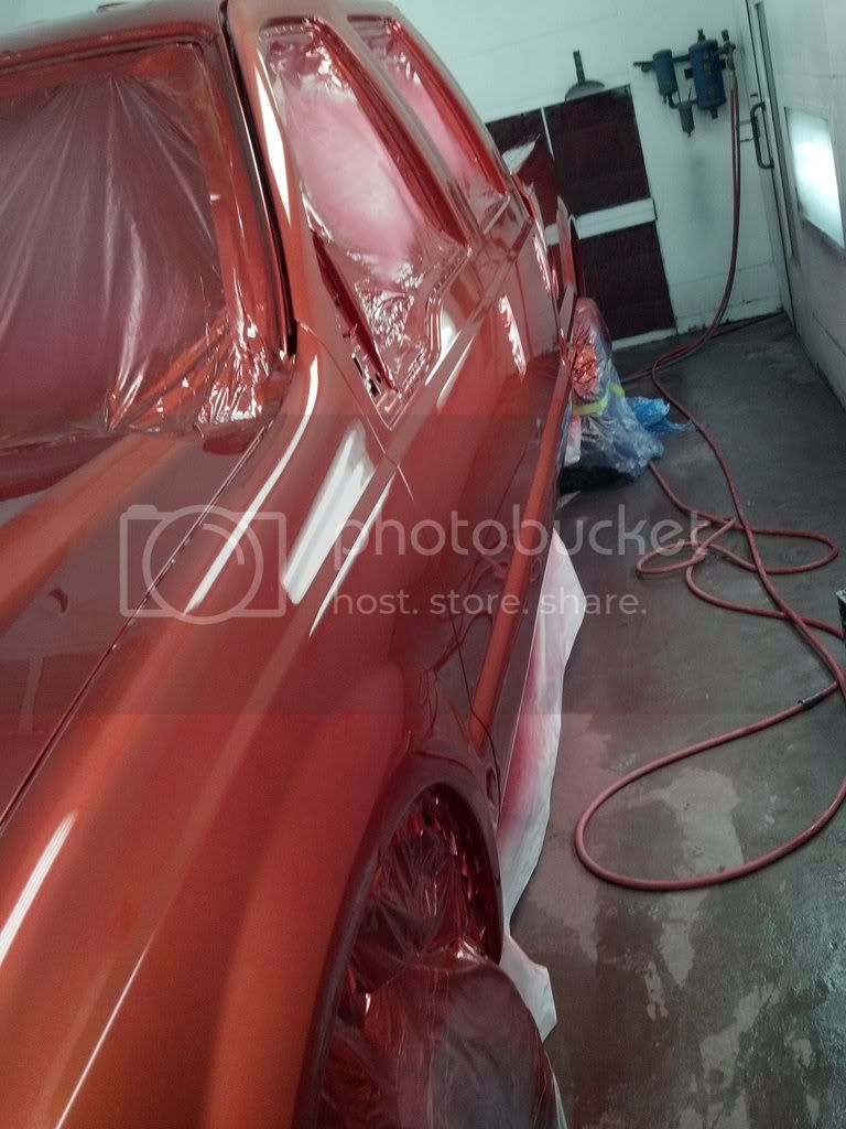

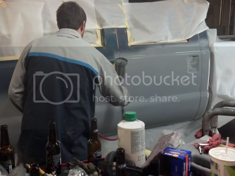

got the doors primed and blocked, a few nights ago, to smooth out that wonderful factory door wave

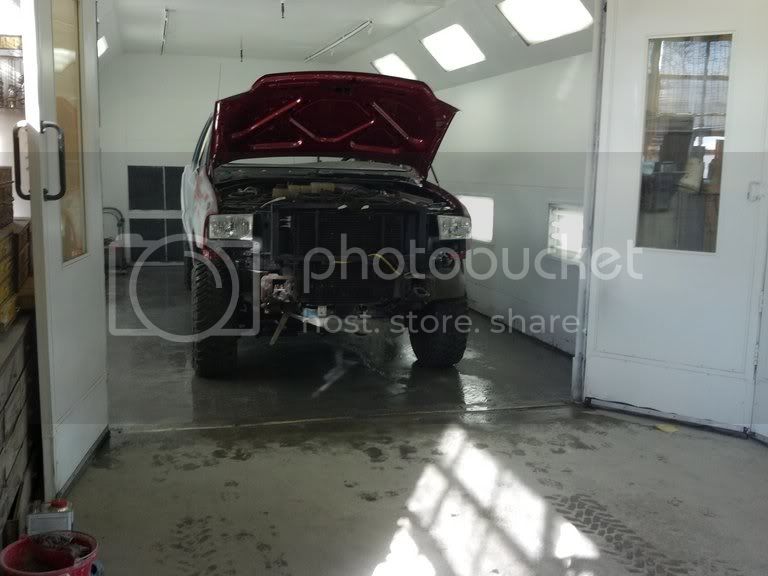

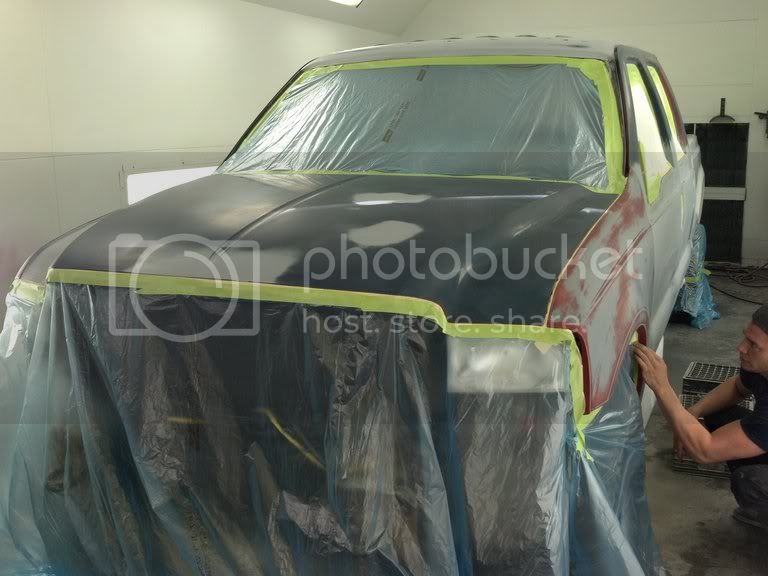

saturday morning got the final prep done and rolled it in the booth
all tapped up

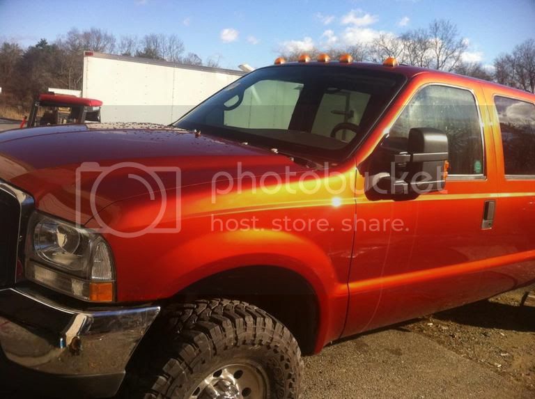

made a last minute change in paint, we (well my two buddies that painted it) decided it would look awesome as a 3stage job, with a pearl coat over the chosen color(bright amber metallic). So i went with an orange pearl)
im going to get it out of the booth now, and will get some pictures in the sun tomorrow

your friends made a KILLER CHOICE BUD!!!! are you doing an 05+ conversion or leaving the 99-04 front end? that would look absolutely stunning as an 06 clone with the color you guys chose! it's beautiful!

wow that color is wicked awesome!!! Can't wait to see the pics of the truck in the sun and as it gets the rest of the trim put back on.

Like they said the color looks great. Awesome choice. It's nice to See someone take there time to do a proper paint/masking job also. nothing irritates me more than a lazy prepped who can't mask for ****

thanks for all the compliments guys!!!
as for the front end, i have an 05 grille shaved down to fit the older bumpers and 02-04 head lights

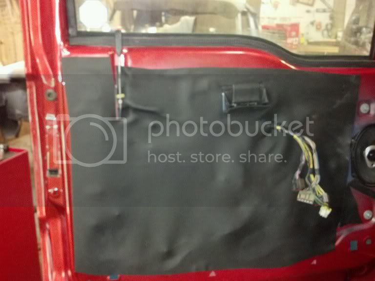

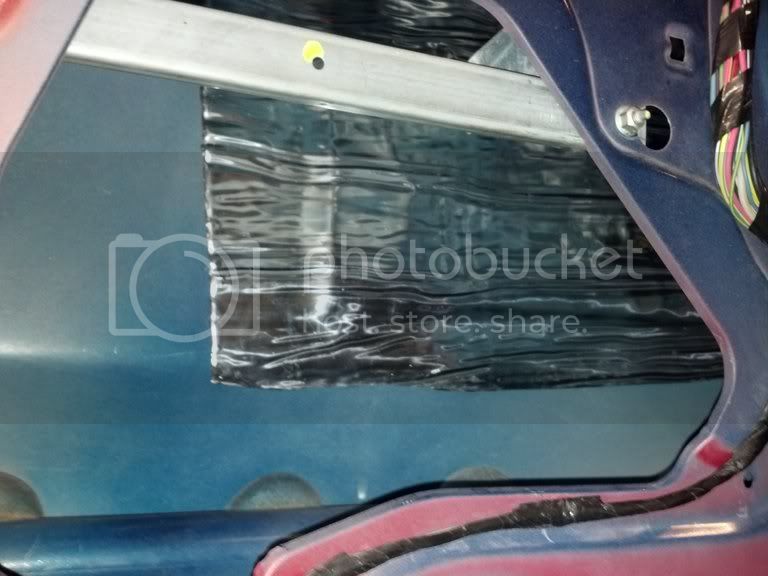

got the doors all insulated...
vibration material on the outer skin
and sealed with closed cell foam on the inner pannel
and a picture of it in the sun just for the hell of it.
i still have to get all the seats in, dye my over head console, and clean it up..but after 2 days of driving it im happy. the noise reduction is amazing! the doors close with a dull thud instead of the usual shaking echo
