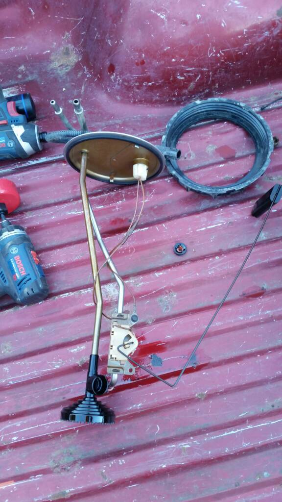

Shouldn't there be a sock or something? That's all that was attached, and nothing else in the tank.
Sent from my SAMSUNG-SM-G900A using Tapatalk
6speedsd
Jun 9, 2011
3,468
Olive Branch, MS
Oh well. Screen was intact. That little rubber plunger looking deal middle of the pic was laying in the tank. Had to take the umbrella off the pickup to get it to clear the sump bolt. But, the sump is in, supply line capped off, and tank back in the truck. Fuel line and other quick connect fitting should be here by end of this week. Waiting on those so I can finish it up.
