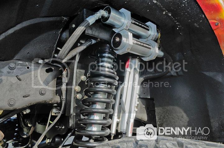

Well to put it simply the compression adjuster is a user friendly adjustable shock to where you can make the ride either softer or firmer by simply turning the red knob by hand, think of a Rancho 9000, just x100 better LOL......
A external by-pass shock is the ultimate when it comes to shock performance, as you can fine tune the ride of your truck by not only being able to soften or firm up the rebound and compression stroke, but you can do it separately. You can also adjust each to change at different points through out the shocks range of travel.....make sense? While this may be the best type of shock you can get, it can be a pain in the ass to dial in and due to the valves long the shock body, as it doesn't in very many OEM locations
That's sort of what I was thinking with the compression adjuster might be easier for me. I'm wondering if I'll get the ones with a bypass and adjust something out of whack, and not be able to get it right again. But on the other hand, if I was able to get the hang of it, I could tune it better to suit what I want it to ride like... Decisions, decisions...
But, I did see a video of the Icon Omegas where they show that the clamp that clamps the res and the bypass tubes to the shock body will rotate to fit where it needs to. They also show that you can adjust it with your hands while still on the vehicle.

I can tell you that they do a lot of good, just by a few twists of the bypasses you immediately can feel a difference in ride quality. I can make it ride stiff as nails or I can soften it up like I have it now and it seriously rides softer and smoother than my car does. 99% of the time your suspension travel is going to be within that 3-4-5” of where the bypasses are (if your suspension is setup correctly so the piston is at that point). Just take a look at your shock sometime and see where the ring is of where it has been displaced on the shaft. You also still have the valving in the piston for when it goes past the bypasses. You can custom valve those whatever way you choose. I don’t think this may be the type of shock that the op would like. Only way I would go this route is if you have someone that can help you with all the valving and assembly. I am very lucky to have someone very close to me that knows the internals of these types of shocks and coilovers very well.
That is the main reason I would go with the Icons. If you went with the icons the shocks would be setup pretty dang good from the get go. You wouldn’t have to mess with them. My setup would require quite a bit of figuring out if you didn’t have anybody to help you. It could be a real nightmare if you don’t know what you are doing.
