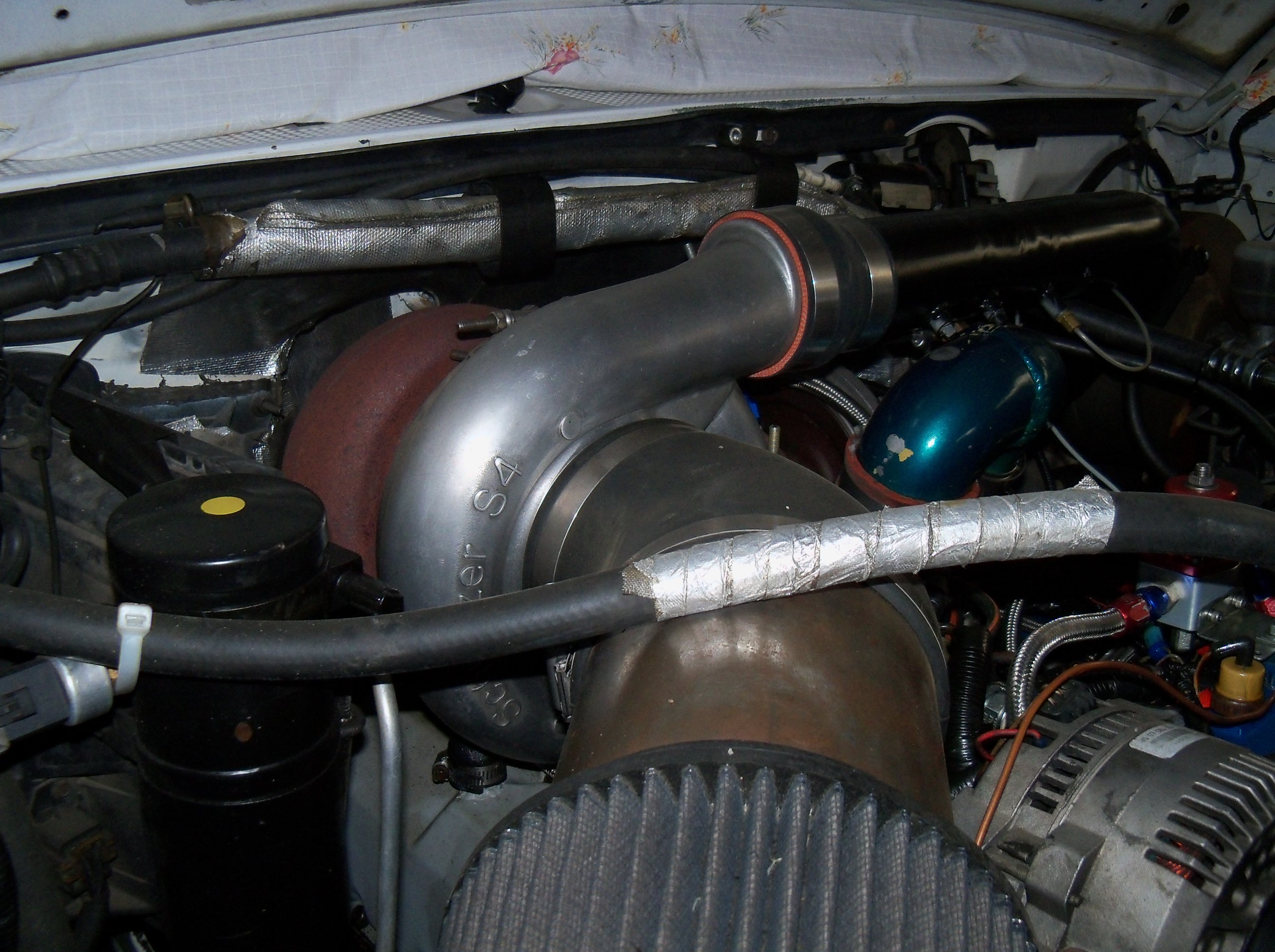

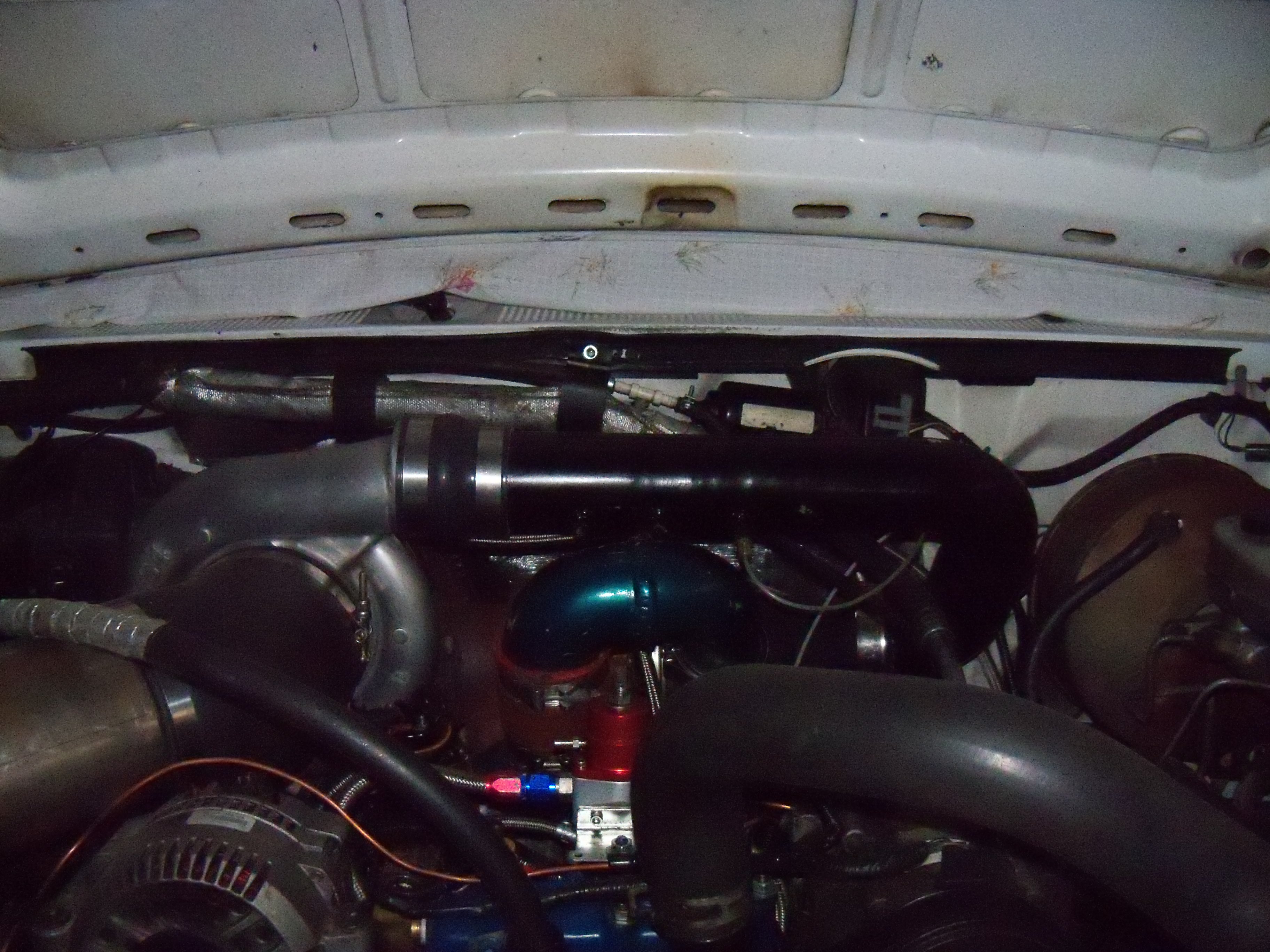

We use a heavy schedule 40 pipe to built the intermediate from, that will help support some of the weight, then you can see the bracket that attaches to the A/C compressor, helps quite a bit as well. This system is also intercooled between stages and has external gates on both turbochargers.

Thats pretty much the same thing im wanting to do, except i was kinda building on one like aggies setup that had the exhaust exiting around the shocks, where did you place the coolant bottle if you don't mind giving up the info?

Coolant resevoir is a stock bottle for the 94-97 trucks mounted on the drivers side of the engine bay.
