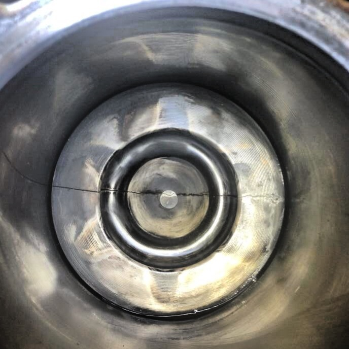

btw mine is piston #2
Sent looking at my blown up 6.4

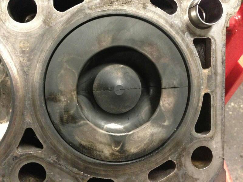

Number 8
