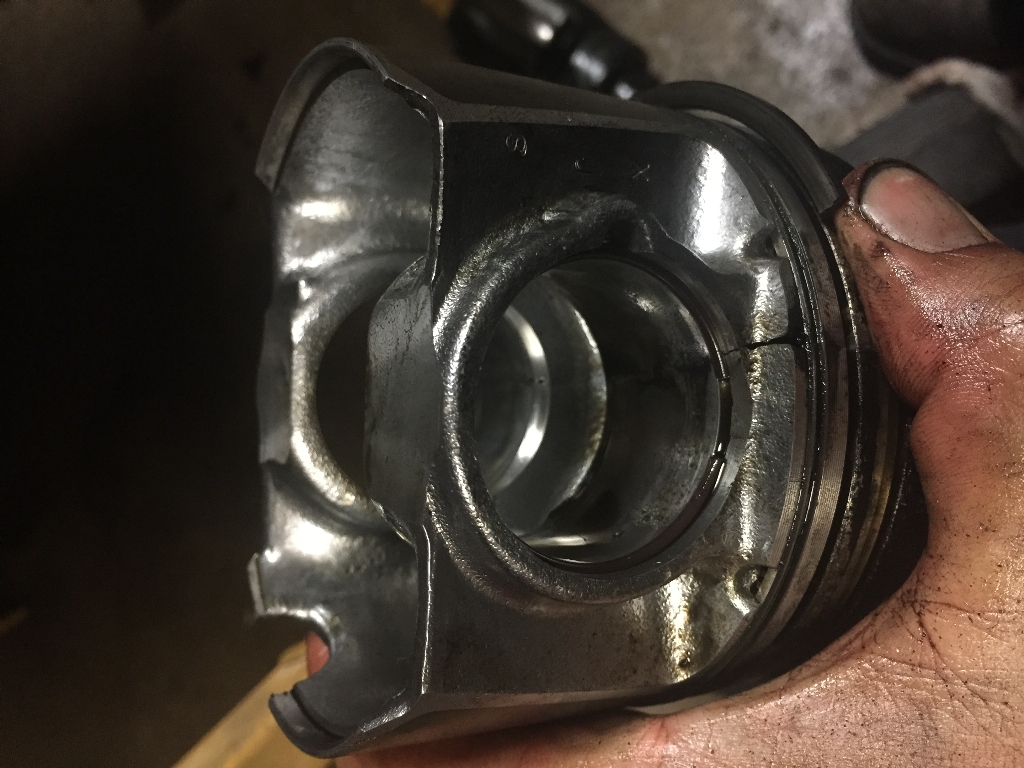

I hope you do in fact find something in the injectors. However, attached is what my piston looked like. Mine showed a melted whole as well as a crack across the piston.
I as well, suspecting a bad injector, sent all 8 to RCD. they tested and flowed them to find nothing wrong.
Sorry about the large rotated images, not sure how to fix them.
Sent from my SAMSUNG-SM-G935A using Tapatalk
Wow, that does bite when you can't find the source of the problem. The burn pattern on mine looks pretty good, so i'm still considering fatigue after 250k miles but it's looking like injector to all that have seen it.
