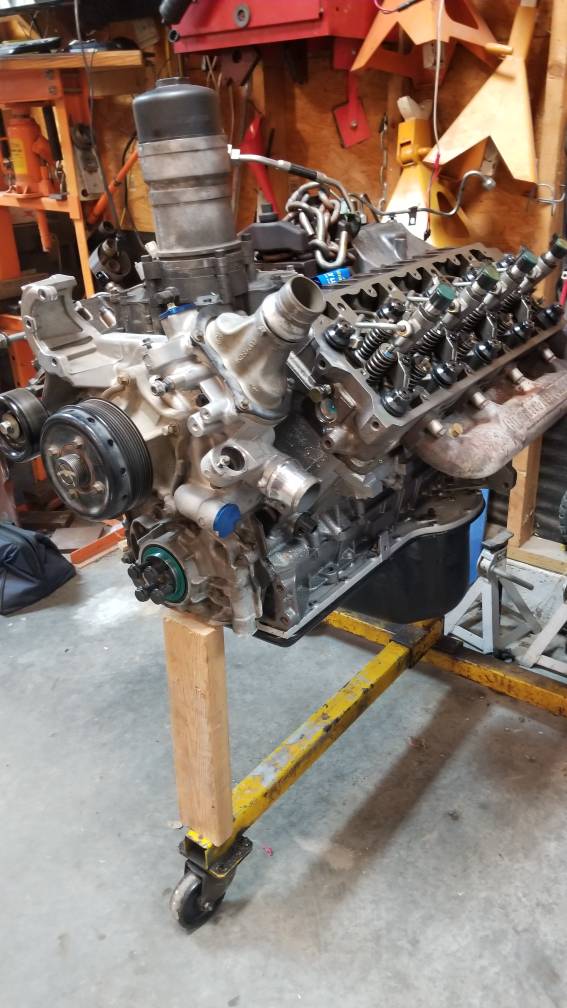

Picked up the block Friday and spent the weekend assembling. Didn't get the rear seal from the dealer and ran short on lube for the studs so I didn't get it back on the chassis yet, but it's close. Sure feels good to finally be going back together.
Sent from my SM-G950U using Tapatalk
Roccafellas
May 7, 2017
357
It will feel so good to finally have it running again.
Hell yeah it will brother
I got 1060km on my engine now and its loving it
I gotta cab off tho, i didnt put the silicone on the hpfp harness and it’s leaking bad like a rear main.
Like bad. Everytime I sit 10 drops fall in a minute.
Sucks
