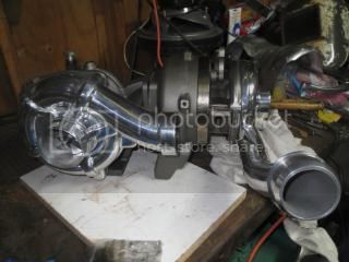

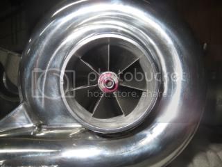

Okay Guys heres a little update ,since the shop made the move i had some time to do some other things to the build -turbos (APEX) ,fuel (DR.DIESEL), I took out batmowheels and sold them (lost my azz), I decided to send my turbos in for rebuild and upgrade!!! 71mm/59mm , billet low side ,titanium hp side
71 mm billet wheel
59mm Titantium wheel
next up change out nozzles to 30% , waiting on dual fueller kit anyday , and need an alternator , all parts will be taken to the shop by begining of next week !! Only down fall to doing these other items was i lost a couple places in line ,but was or i hope will be well worth the wait !! And was told my truck is priority :thumbup:

Whos turbos are those? Sorry if I missed it
These were done by Apexboost.com ,ask for JJ , out of cali ,They offer a 71/55 billet set , and i kind of had the opertunity to try this beast out a set of the 71/59 ! super happy with the service from start to beginning , the polishing was the longest as that can take up to 2 weeks , the rebuild was only 3-4 days

Are those turbos not the industrial Turbos? I understand the hp wheel maybe being different , just thought all those guys did was sell industrial stuff.
Diesel23
May 7, 2012
957
NWI
No Industrial turbo here , Tried that route also no luck ,so decided to send my own unit in for rebuild , they may sell some II stuff but mostly borg warner ,garrett etc, Not sure wheel size?type for II hp (57,58/cast wheel) I think they are just running a 58mm ,Apex has a set they stock 71mm/55mm billet wheels , but in talks went with a bigger 59 ,only cost to me was the upgraded titanium wheel !!
I did have the wheel size/type changed in my set up to 59mm with borg warners new Titanium aloide wheel !!!
I think they are in your neck of the woods , Give him a call JJ , ive been really happy so far ,but will see how it goes when they get installed :D
they did there own machineing but did send out my turbo housings to get polished
Yeah I know who they are. Their about 1O minutes from me. We use the same polishing shop :)

Looking good Frank, I think you will be happy with the upgraded turbos. Be interesting to see how they perform.
Today 07:32 AM
Cool , I am happy with the polishing it turned out great , orginally said 1-2 weeks turn around and it was about a week and a half , and for the money awesome place!! Great bang for the buck , and will get you an email very soon ,once i iron out my hpfp and alternator problem , the air intake is killer and next on the list to do !! ;)
Erikclaw Looking good Frank, I think you will be happy with the upgraded turbos. Be interesting to see how they perform.
Thanks appreciate it !! I was happy with the stock set up and doing the batmos but had the time and cab is off so ,when in rome ,do as the romans do , Lol !! I hope there is not to many issues once we get it all together and all issues get ironed out quick , so i can enjoy them!!
