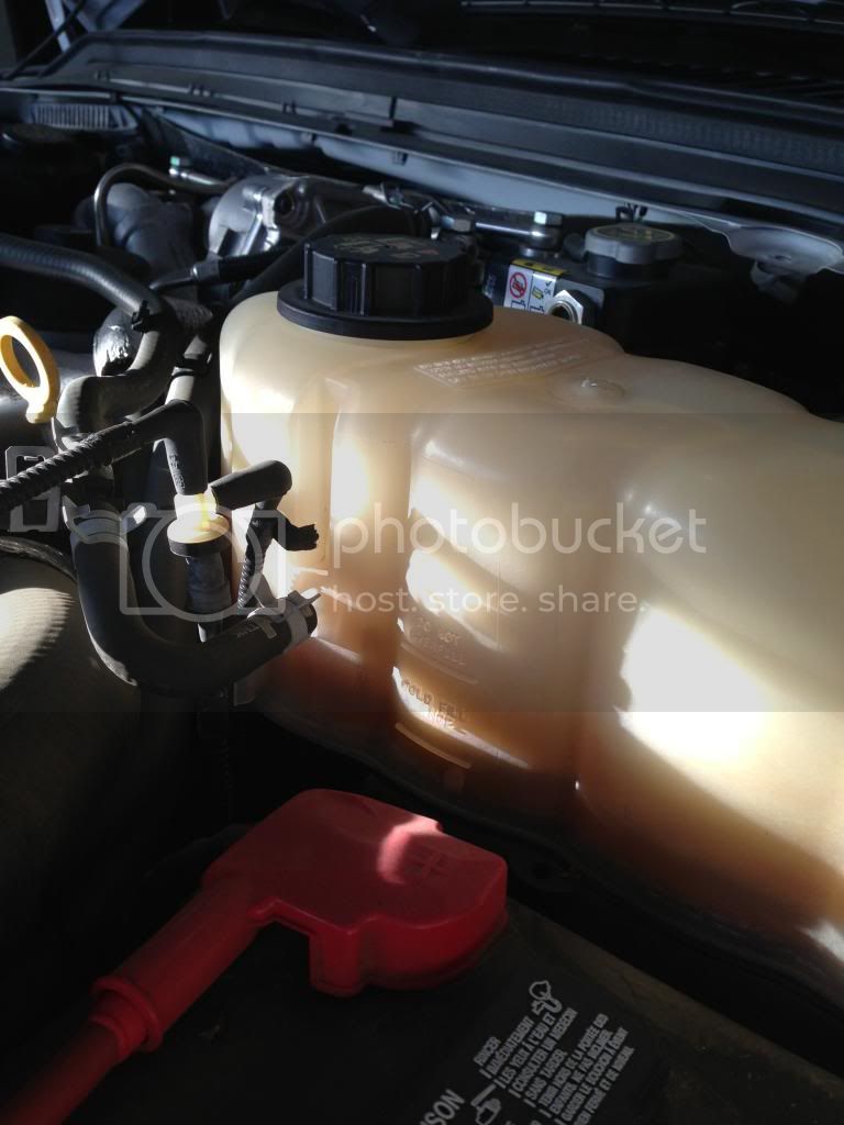

No problem, i ran into it once online and that's the only reason I know, I run the second picture with top line capped, no issues so far and that's how most trucks seem to be.
ncollins64 yes no problem, you don't really need the updated bottle unless yours is filthy, HG blew up and oil is in it, or broken. The updated lines are an almost must if you don't want to risk getting stranded somewhere, I had to do the radiator so while the rad was out I did all 3 lines for piece of mind. Next will be EGR Delete + Thermostats with the EGR out (much easier) then should take care of all the coolant issues until I get closer to the motor and can check out the front plate and water pump for cavitation (already have spare WP)

Well all this cooling system talk made me check under my hood (while looking for my EBP sensor as well) and boy good thing I did! Anyone who has the top nipple capped with the factory clamp, change that out. My clamp obviously doesn't hold enough as there is red coolant clearly leaking past it, since it is a little cold today it actually froze to the clamp otherwise I doubt I would have found it. Clamp below it is the same style so I think I will be swapping them both out for better clamps this afternoon, and next time I plan on having the degas out, switching to the newer part # with one nipple only.
