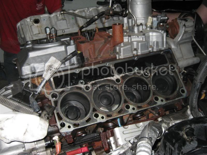

The HPFP harness number is 1872509c91
It's a Navistar part number that should be around $45 if you type it into google.
You can see it here in Spatel's buildup:
If you can't get pullies made local, there are plenty of people in this thread that can help out.
http://www.yellowbullet.com/forum/showthread.php?t=163004
It really appears to come down to the lines. By what Dzchey said, you might be screwed on that end of it...
