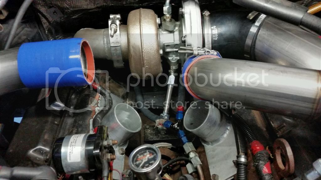

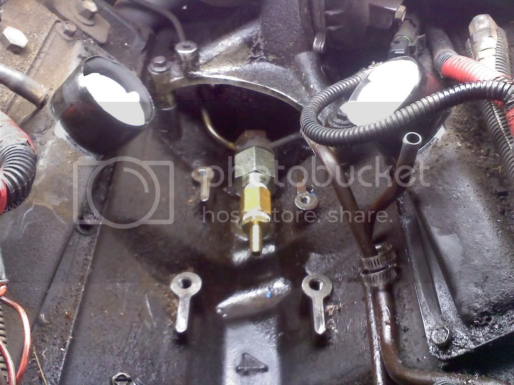

You just need a banjo bolt adapter. Has been done plenty of times. Picture from another site...
