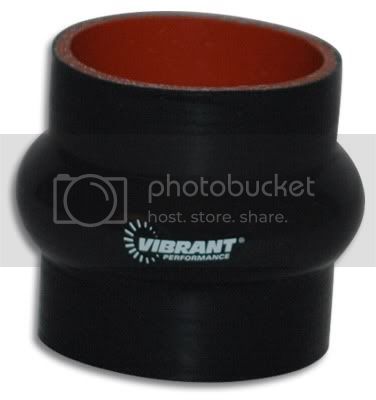

Jeff get a 3" boot with the flex humps in it. Your prob pulling the boot tight when the engine torques. There's lots of options out there just make sure it's reinforced with aramid or polyester and 4 ply.
You don't think the longer DieselSite boot will fix my issue?

It will. Your problem is you don't have enough bite past the beads. You got an original set of boots. I have almost 50 sets out there without issue, I just didn't like that 3" boot. Just not enough. Diesel site boot and your done. If you're engine is torquing enough to cause a problem with the boot, you have motor mount issues. I do think the flex humps could be beneficial but not necessary.

No. How is a boot that can't stretch and contract gonna help? That's why the stock ford boots have the humps so things can move and not blow. My diesel site boots have found there way into the scrap bin too, from day one they won't stay on even double clamping and using hair spray and I have my CCV to atmo too, just a heads up. The hump hoses are only $25. Here's a pic from vibrant
I've never had an issue with DieseSite boots before, so why would I have one now? Not saying you are wrong, I just don't see the issue being anything other than what Mike said....the boot I have currently is simply not long enough. The DieselSite boot is longer. That should fix it I would think.

Giver bud. Just giving you the best option so nothing touchs or gets pulled. Your dieselsite boot will work but it'll still pull on the pipe. Good luck and enjoy.

I've got all diesel site boots (except for the 4" on the HP) and its held pretty good. I've thought about the boot that was shown but haven't had a reason to change it
