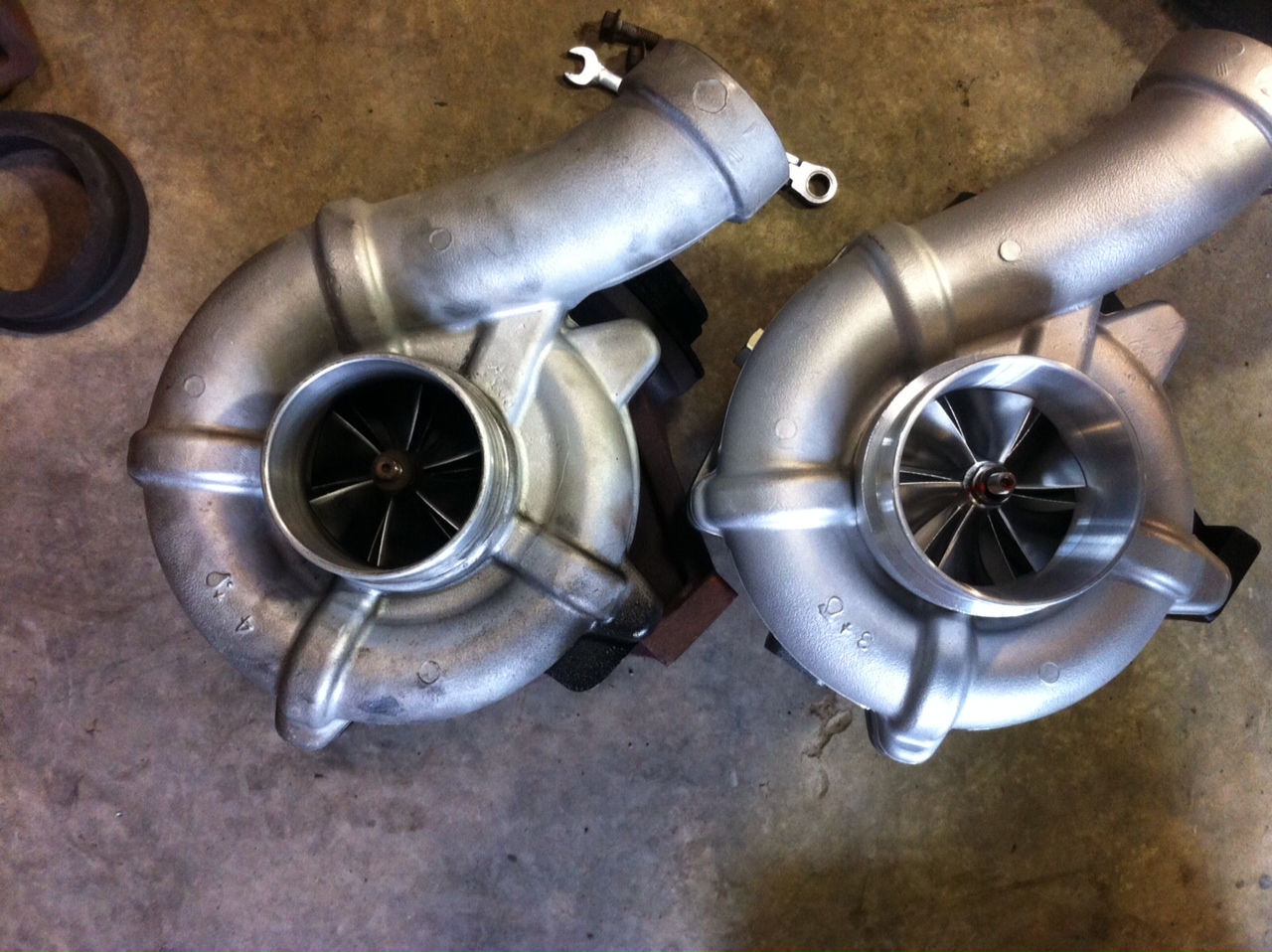

Here's a pic of my old 71 and new JHP side by side for reference in case you didn't see it on the other thread.
