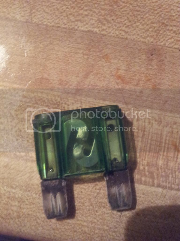

Ive eliminated them.My question now is.How.am I suppose 2 hook up a gauge 2 read fuel pressure since the fuel pump fuse blows so fast?

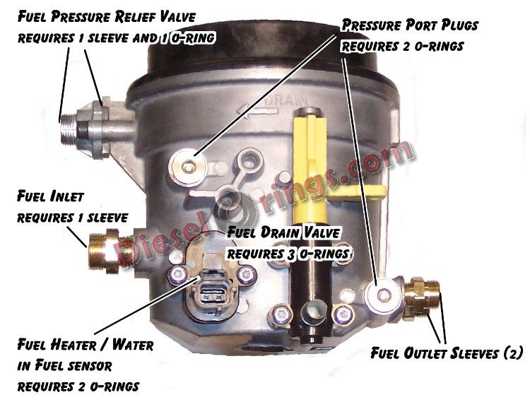

As I understand it, the DI tank mod kit should remove the parts between the umbrella and the top of the sender assembly. Im still puzzled why the bowl has enough pressure in it to cause to blow fuel out the drain under pressure. Ive never seen it , so if someone can confirm this is normal for stock SD fuel bowls, then I'll stop bringing it up. OP, after the fuse pops is the pump noticably warm or hot? can you tell? That maxi fuse has had over 20 amps back feeding through it so something is getting warm.

there is a test port on the bowl-- a harbor freight gauge with a 5 foot hose on it will work. put it somewhere you can see it from outside the hood.

cutthroatxxx
Aug 1, 2014
143
I can order.the adapter to run into the port from guzzlers page&can get a gauge but what Im confused on is how to get a correct reading since the fuel.pump fuse blows the pump wont be working so I wont get a correct reading.Lastnite it blew while idleing.Itll.blow a 40.amp.fuse it just takes.a minute longer.Ive blown over 100 bucks worth of em
