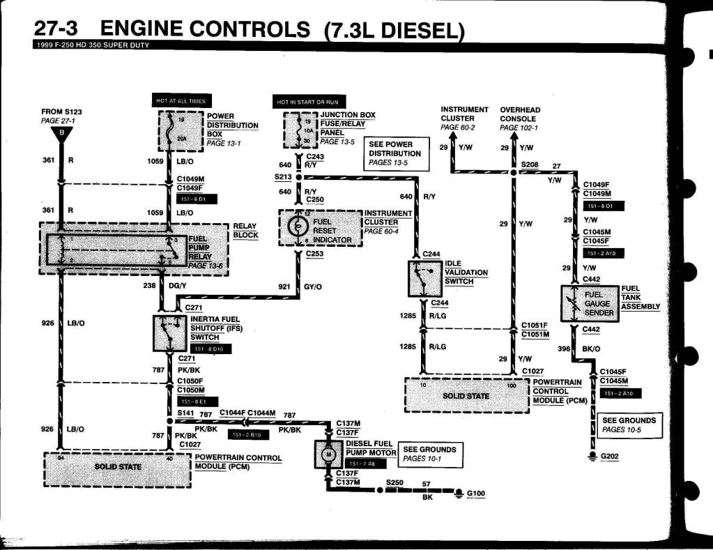

If you have a 0-100 gauge with a 5-6' fuel hose assy that has the needed pipe threads, it will work. You could use push on hose/fittings, etc. what ever the NAPA has. Get your multimeter as well and a test light for the wiring that you'll be tracing also.
A power wire in the circuit thats rubbing on steel will kick the fuse. The power wire goes up to the interia switch and then to the fuse (then to the relay thats triggered by the PCM). Has anyone seen the interia sw act up?
Use google and you can find other wiring schematics for the truck also.
