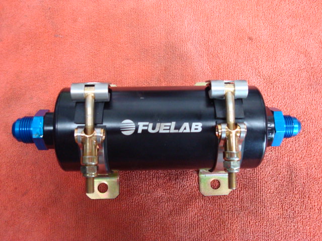

these clamps i think he was referring to...

What lift pump were you using?.
i had no lift pump,
sump>filter>fuelab>filter>RR
pump only saw failure once it hit water, (rain, car wash etc.)
talked to fuelab multiple times, assured me it was fine as a stand alone pump (needed no supply pump as long it wasnt doing a heavy pull) as well as ensured me that the pump was 100% waterproof.
i was told to use dialectical grease on the electronics to keep out water.

How did that setup work once you got your pump issues figured out?

Fittings on the heads are 12mm x 1.5 o-ring and usually go to-6 AN for the fuel line.
setup worked great, a member on here now has the new pump. they always stood behind the pump, and warrantied no questions asked.
held full pressure with 205/100s

Cool. I might end up going that route. not sure if it really makes sense to spend an extra 600+ on an AD or FASS just to feed the real pump...

be careful if you are not using a pusher(feed) pump to your hp pump. some claim that to be the failure with many of these pumps not living long.
