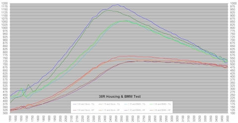

Dyno Run - 04/17/2012 - GTP38R, 1.0 W/G housing, Stock compressor wheel
(All values rated at 3500 RPM)
  • Max Boost - 34 PSI
  • Max EBP - 47 PSI
  • Max EGT - 1300
  • Peak HP - 566 @ 2613 RPM
  • Peak TQ - 1189 @ 2512 RPM
Dyno Run - 04/17/2012 - GTP38R, 1.15 Non-W/G housing, Stock compressor wheel
  • Max EBP - 45 PSI
  • Max EGT - 1300
  • Peak HP - 542 @ 2620 RPM
  • Peak TQ - 1141 @ 2433 RPM
  • Net HP Loss - 24 HP
  • Net TQ Loss - 48 Ft./Lbs.
(click on image to enlarge)
Bill, how well is the truck loaded on your dyno compared to on the street? I think you have a Mustang Dyno if I remember right. How many seconds would you estimate the run lasted, I am curious about the EGTs is why.
Power Hungry
Jun 20, 2011
365
Winder, GA
The dyno is running a simulated load of 8500 Lbs., runs are in 3rd Gear with the T/C locked, and the 2000 RPM sweep takes about 9 seconds. I can run a heavier simulated load which will extend the dyno time to around 15 seconds depending on the load.
