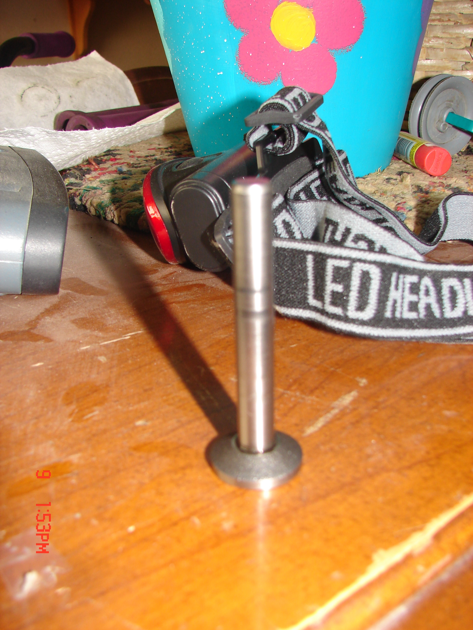

this was at the bottom of the oil pan, anyone know what it is??

Can't be positive, but it looks like the tappet from a fuel pump. They have been known to fall out and drop into the pan. Cheers!

idk how long its been on the bottom, but i take it it has a mechanical if it ran all this time
bluedge8
3,879
Champlin MN
do you have a fuel pump in the valley?
one of two things happen:
1. someone dropped it when they changed the fuel pump and bought another instead of fishing it out
2. or, you have been converted to electric fuel and have your fuel pump on the frame and it fell in at that time.
you didn't pull the fuel pump when you pulled the head did you?

there is a pump in the valley and no i did not
