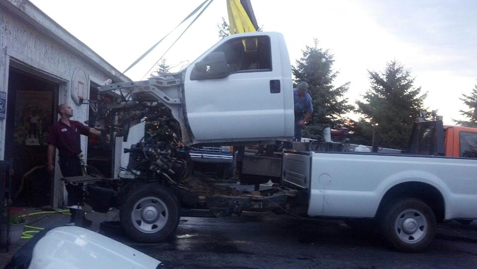

Here is how we lifted mine and done a few others as well. Its a 6x6 board with 2x4s nailed on to match up on the pinch welds. We used the back hoe before we had the crane on the truck. Works really well!

I would say about 2.5 hours if you don't have any issues with the cab bolts.
I've done one in about an hour, I know others have done it faster.
First time plan on 3-4 hours
Things like amp steps, stereo equipment, Ect complicate the cab removal process.
