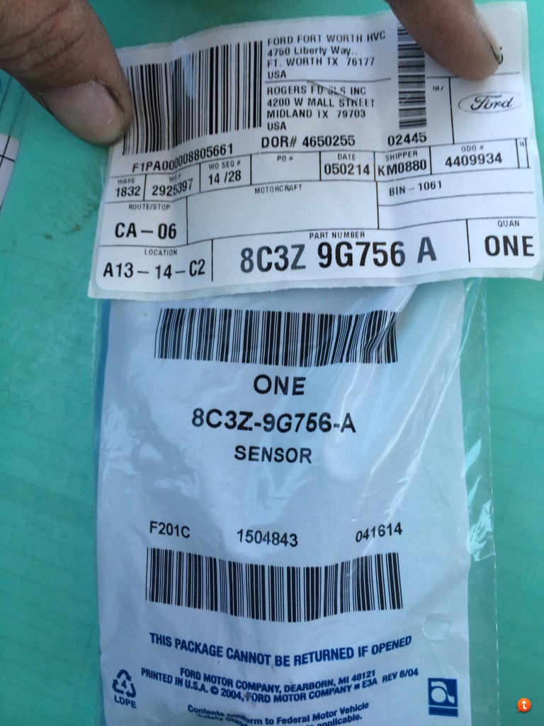

$37 dollar part. I'll know this evening if this cures my heart aches

What about an EBP sensor. Could that have anything to do with VGT boost. I thought I once heard it controls the vanes accordingly. Anyone confirm that.
