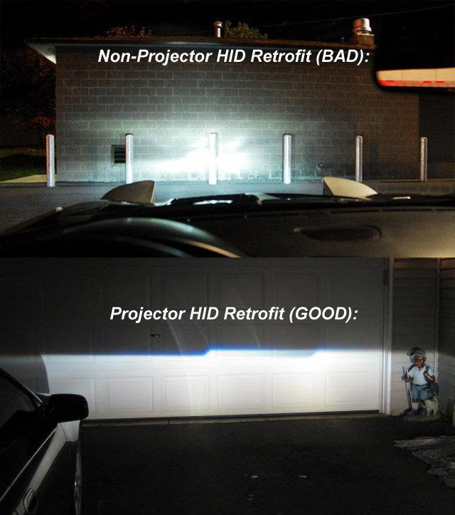

Plug and play just like a "normal" HID kit, only WAY better output and you won't blind other drivers. Plus you get that sexy light cutoff with the low beams, and the bi-xenon gives you great high beam output. His kit comes with the projector retrofit, bulbs, and ballasts. If you figure an HID "kit" (bulbs and ballasts) costs $150-200 and you really don't gain much in output, this is a great deal!
Good vs. Bad....
Also I will add I have no affiliation with this vendor. I am just glad to see someone offering this service at a crazy low price. I HATE HID setups in factory housings...this is the ONLY way to go!

They are the stock housings, but the addition of the projector focuses the light too a specific spot under the "cutoff" which formed by a cutoff shield that has the stepdown on the drivers side to not blind oncoming traffic like a truly stock housing/HID combo will do.
These will give your "stock" Ford housings virtually the same light output and pattern as a vehicle that comes from the factory with HID's. Headlight aiming is key after install to truly get that awesome cutoff.
Also a side note:
Most people run a 55watt 6000k bulb in their PnP HID kits, but in actuality, ALL the factory systems on the road run a 35 watt 4300k bulb and I guarantee any factory HID kit (or retrofit) will outperform any PnP kit in a stock halogen bucket. The projector helps create that blueish cutoff line and overall "white" or "blue" color everyone is after.
