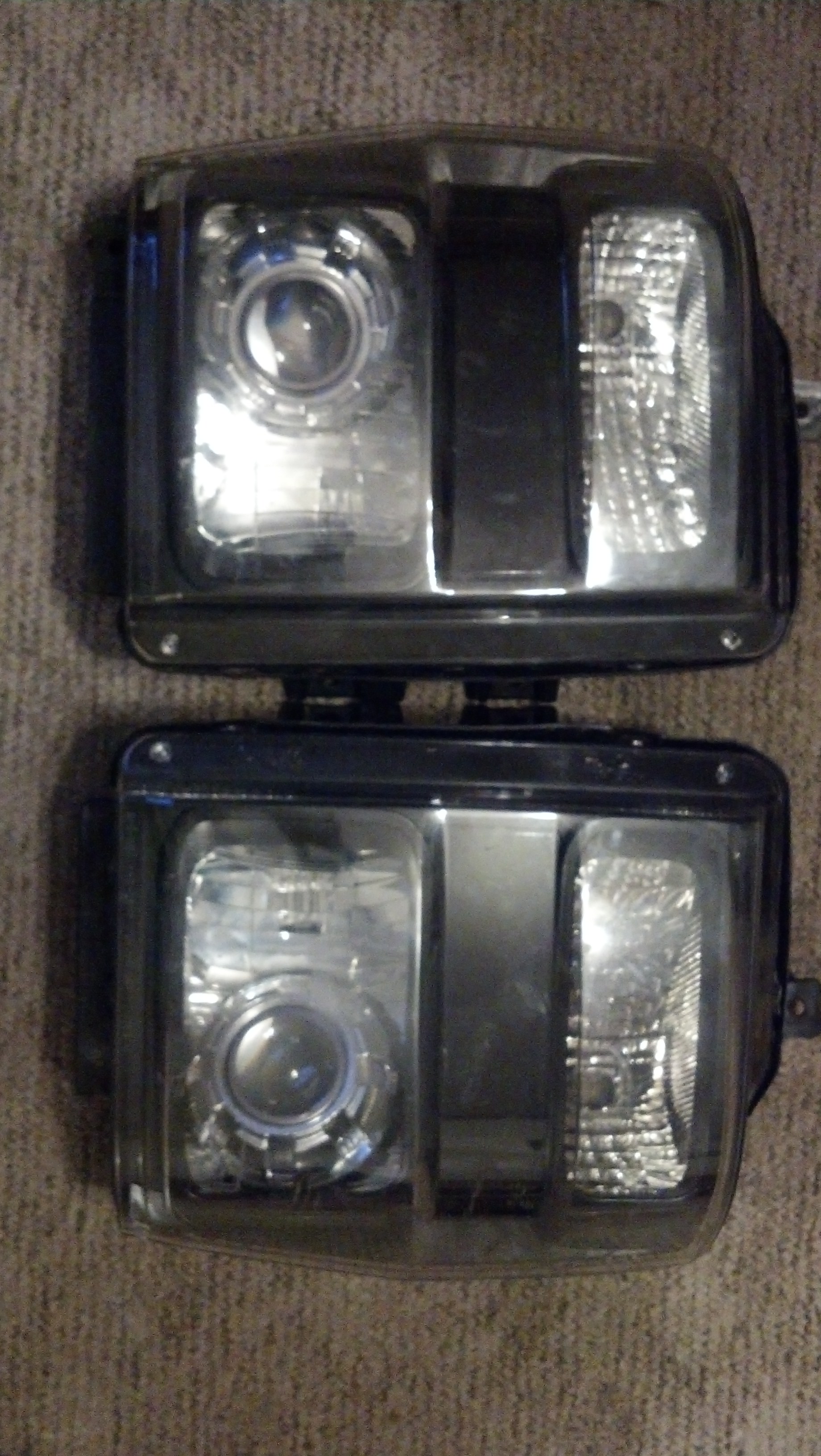

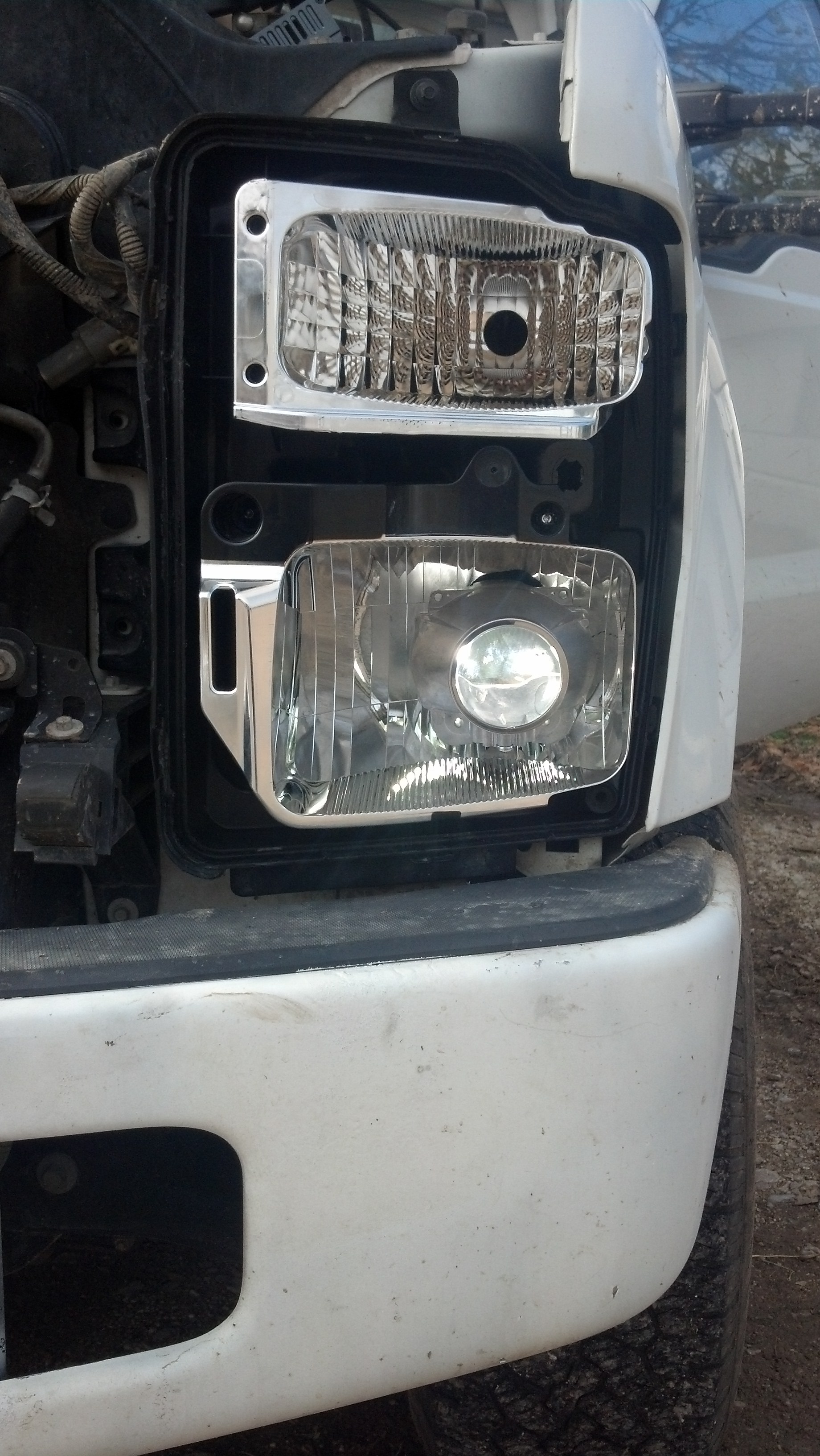

and i said let there be light lol

Looks good, show the beam alignment when your done
Can you align them without being mounted on the truck
FaSSt9602
Jul 27, 2011
605
Gilbert, AZ

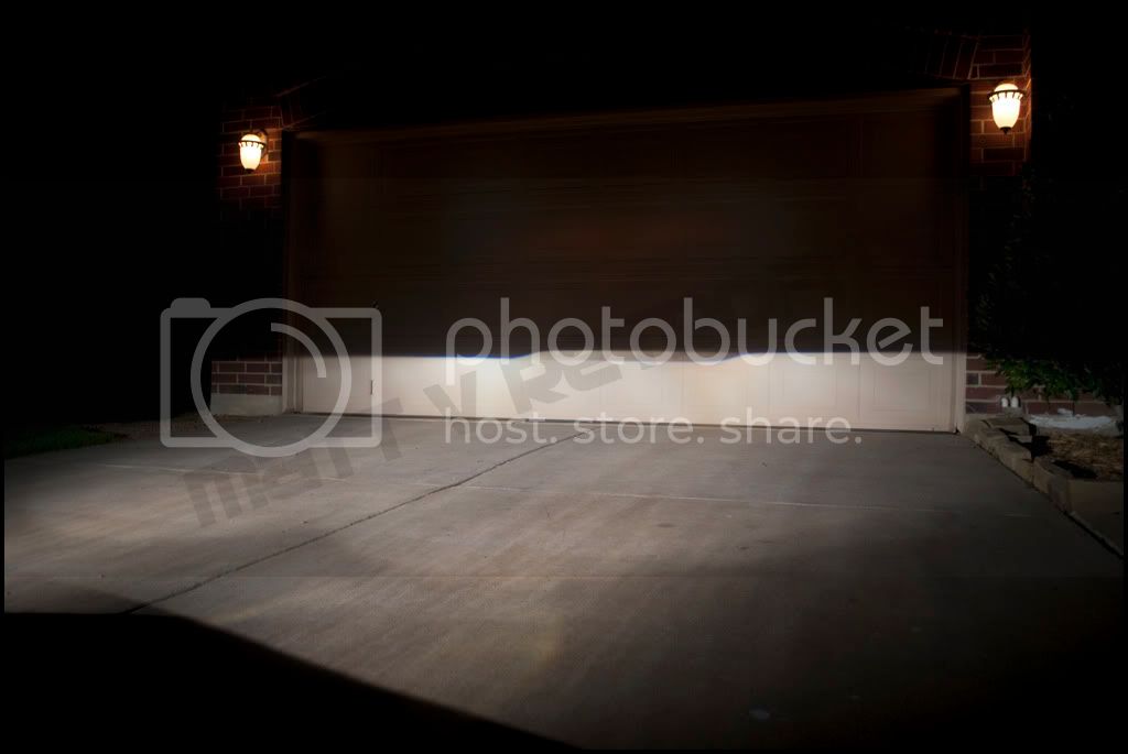

You can aim after the fact using the factory adjustments, but he has to adjust the beam horizontally before he seals them up. Otherwise your beam with be slanted and you won't get the sharp cutoff...
These pictures are not of the work ohio937 is doing, just showing you the difference in good and bad alignment.
Bad drivers side alignment, notice drivers side projector is slanted:
Good projector alignment:

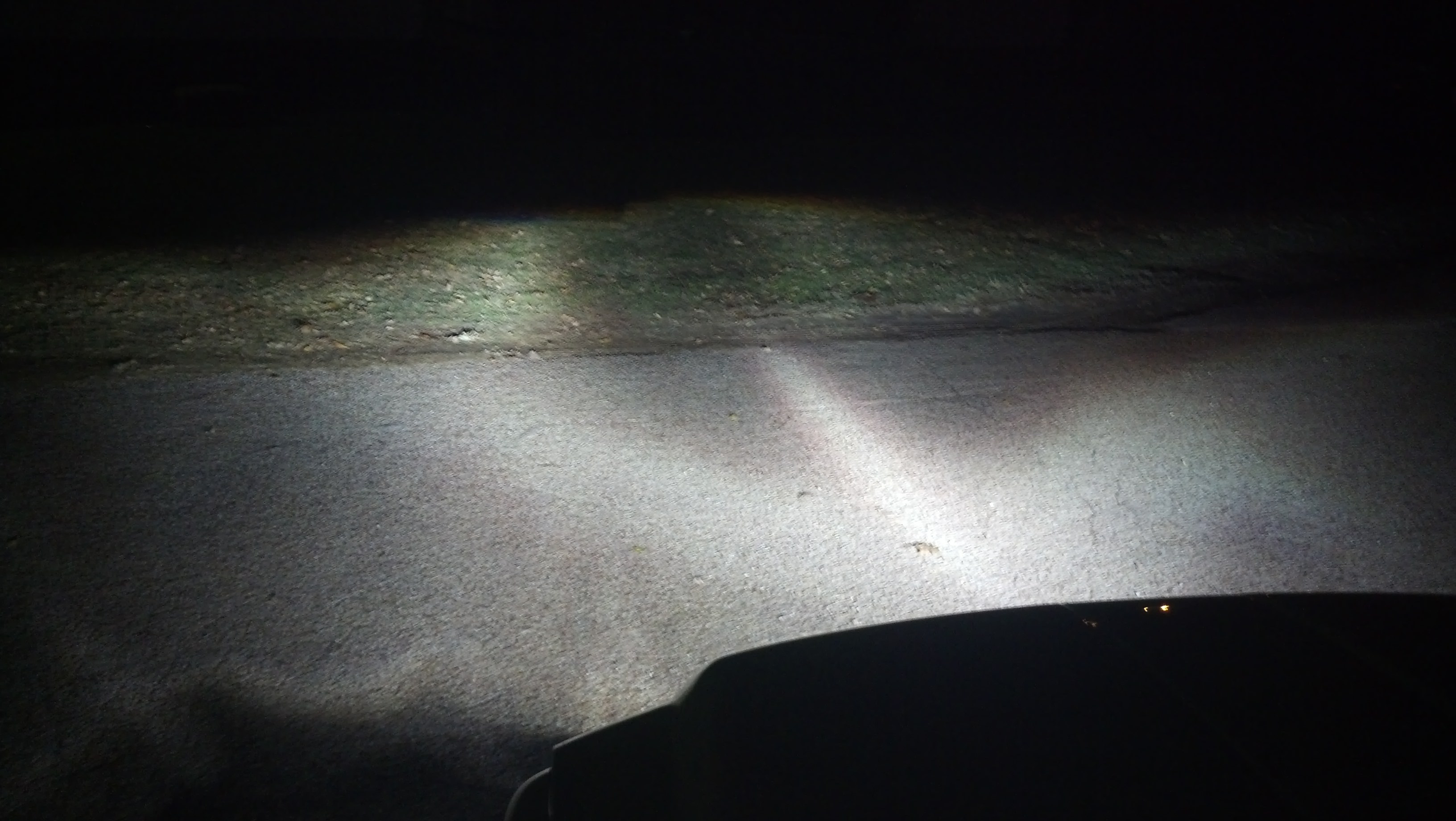

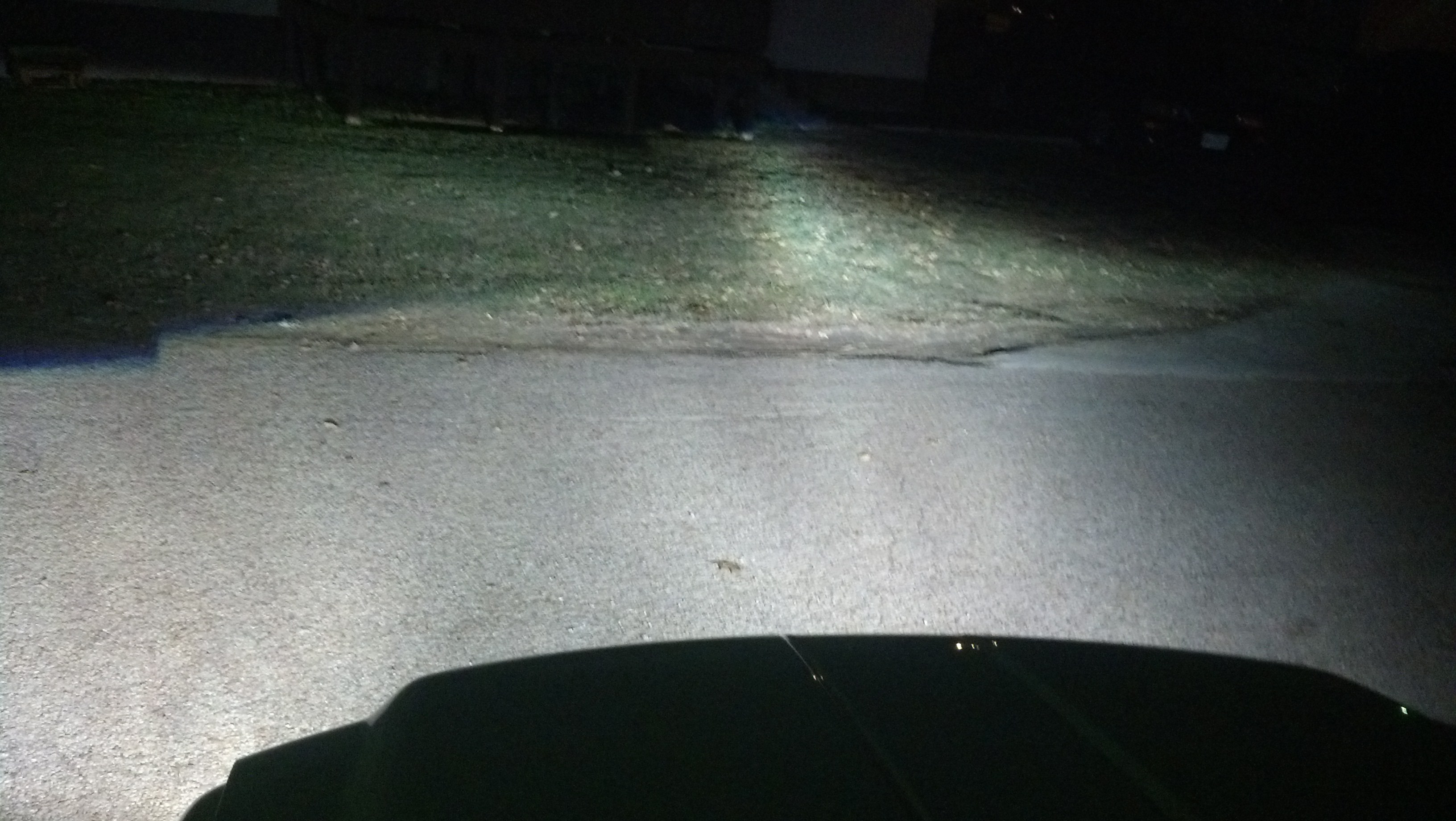

All done. getting the horizontal right was a pita
Cory@RPHC
Oct 4, 2011
504

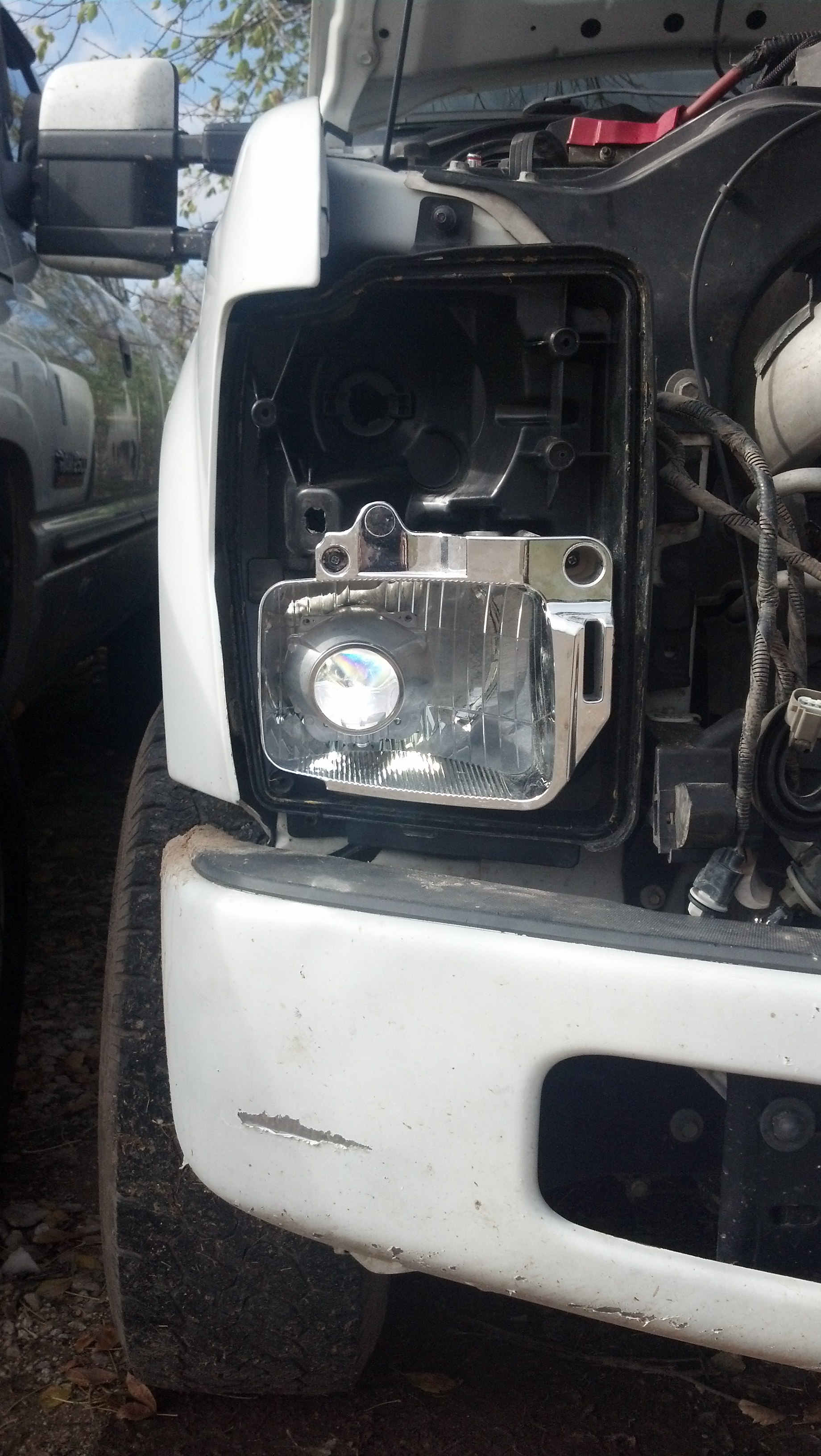

The set above was first one done. One the way to Canada now. And yes I can open them back up and reseal them again
