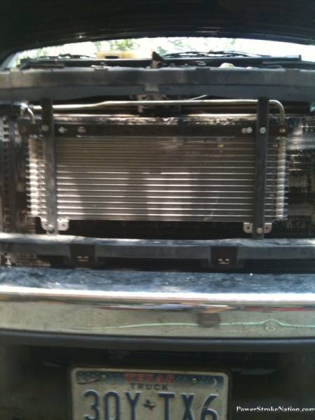

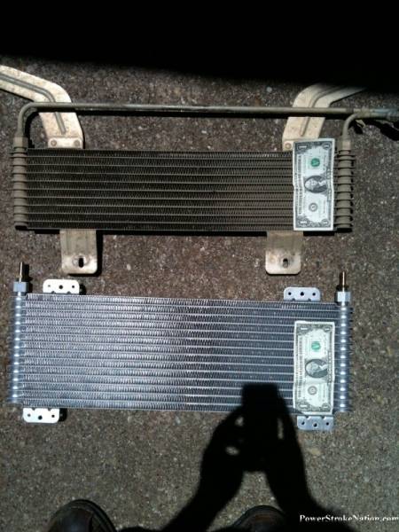

Sorry was in a pretty bad mood last night.. Tru cool max 4739 . I know its not the 6.0 but its the next best thing that I can buy.
Excellent, hope that works out for you and solves the problem.
side note, was watching temps yesterday while hauling my low mile 7.3 to the guy that bought it and getting on it hard etc and my temps never made 140, which is normal year round. Ambient was around 75. I'll be in Denver with it next week and looks like temps will be higher, I'll watch them some more. Cooling is 6.0 cooler, no radiator cooler, deep sump pan, billet triple disk etc etc

so andy, with your cooler in front of everything, how does the ac work down there in texas? did you notice a difference when you went from stock behind the ac to in front of it??
i have read somewhere that putting the ac in front of the tranny cooler, the efficiency of the trans cooler goes down to like 60 or 70%. i dont know how accurate that is, i just know i read it on psn somewhere.
