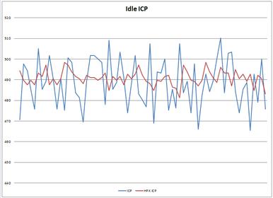

Well the data backs me up. The AE is showing substantial reduction in HPOP pressure spikes.
I have attached a graph from the idle test. Unfortunately, due to varying road conditions (even on the same stretch of road) the 55mph and 70mph runs were both inconclusive due to several anomalies in the data that rendered them useless.
