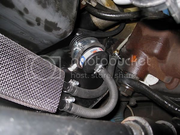

What did everyone do for the outlet line from the steering gear box to the cooler?
In the pics on the first page I see that 3/8" line runs down from the gear box to the cooler, but I don't s any mention of a fitting, etc.
freddie
301
Ohio
Nvermind, I see it now.
A Magnafine filter was installed in the return line. In case the pump or steering box ever failed I didn't want the fine passages in the booster getting clogged. It is secured with a 2" standoff pipe clamp.

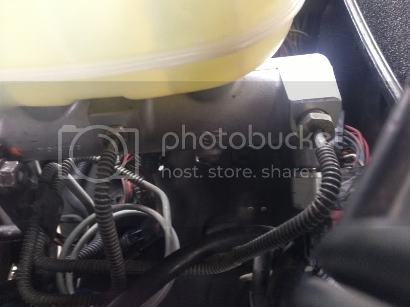

Using the 6u9z-2005-a will let you use the stock obs master cylinder or the 1 3/8 sd master. Here is the sd master, lines bolt right on
So your'e saying that if I get the 6u9z-2005-a Booster for my 95' F350 7.3 w/ cruise control that not only it will bolt right up to the fire wall but will bolt right up with my current master cylinder I have on the truck right now? I have drums still in the rear and don't plan on converting them to disc for some time now and I don't want to mess around with swapping out valves or anything to make the drums work properly with a new master cylinder like listed in OP's original parts list so would love to just keep my current master cylinder and have the brakes proportioned right. Also although the 6u9z-2005-a booster is a different booster then what OP used will the hydraulic lines OP has listed in his parts list still bolt right up to the 6u9z-2005-a booster or do you need adapter fittings? Thanks!
