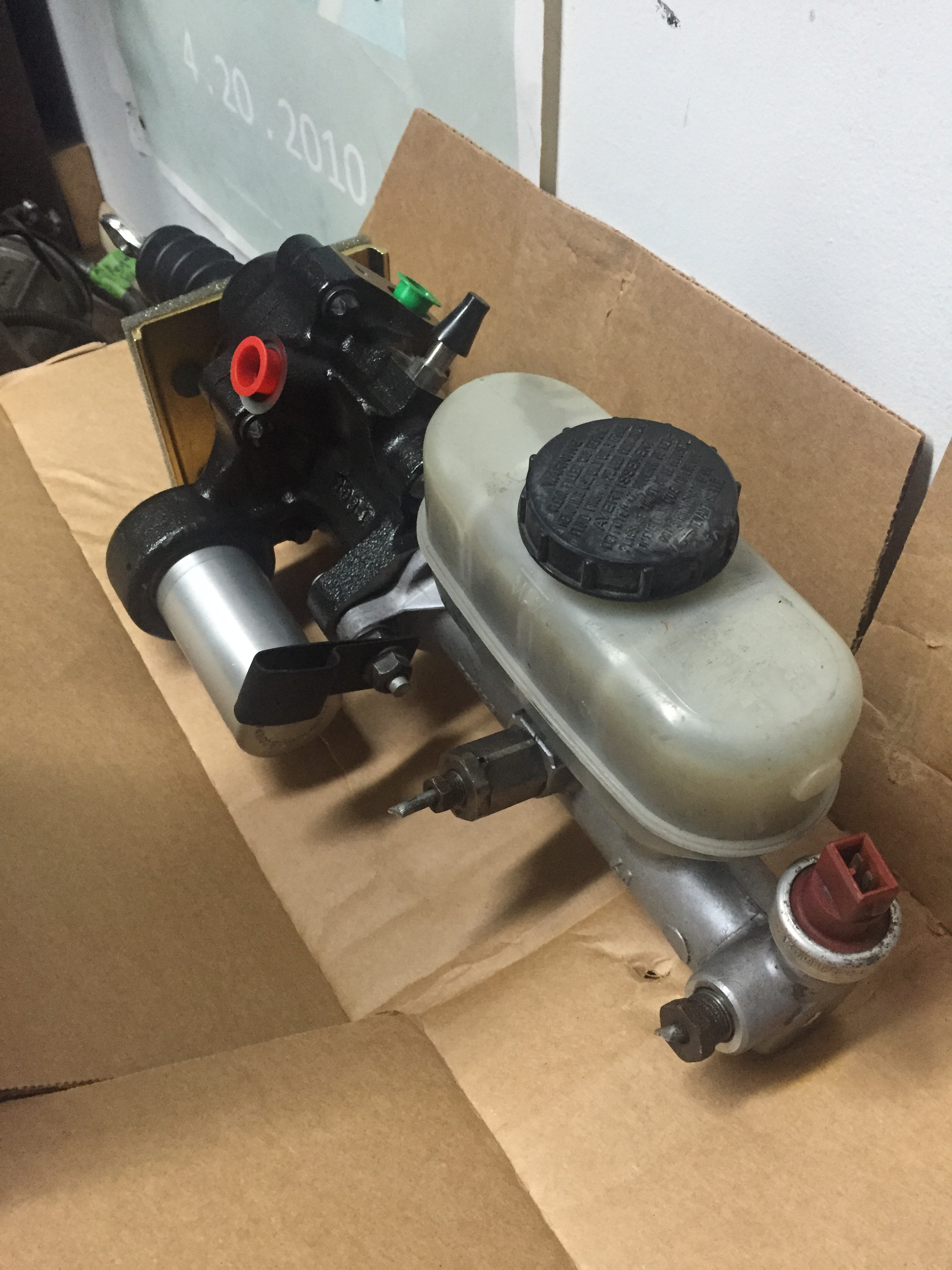

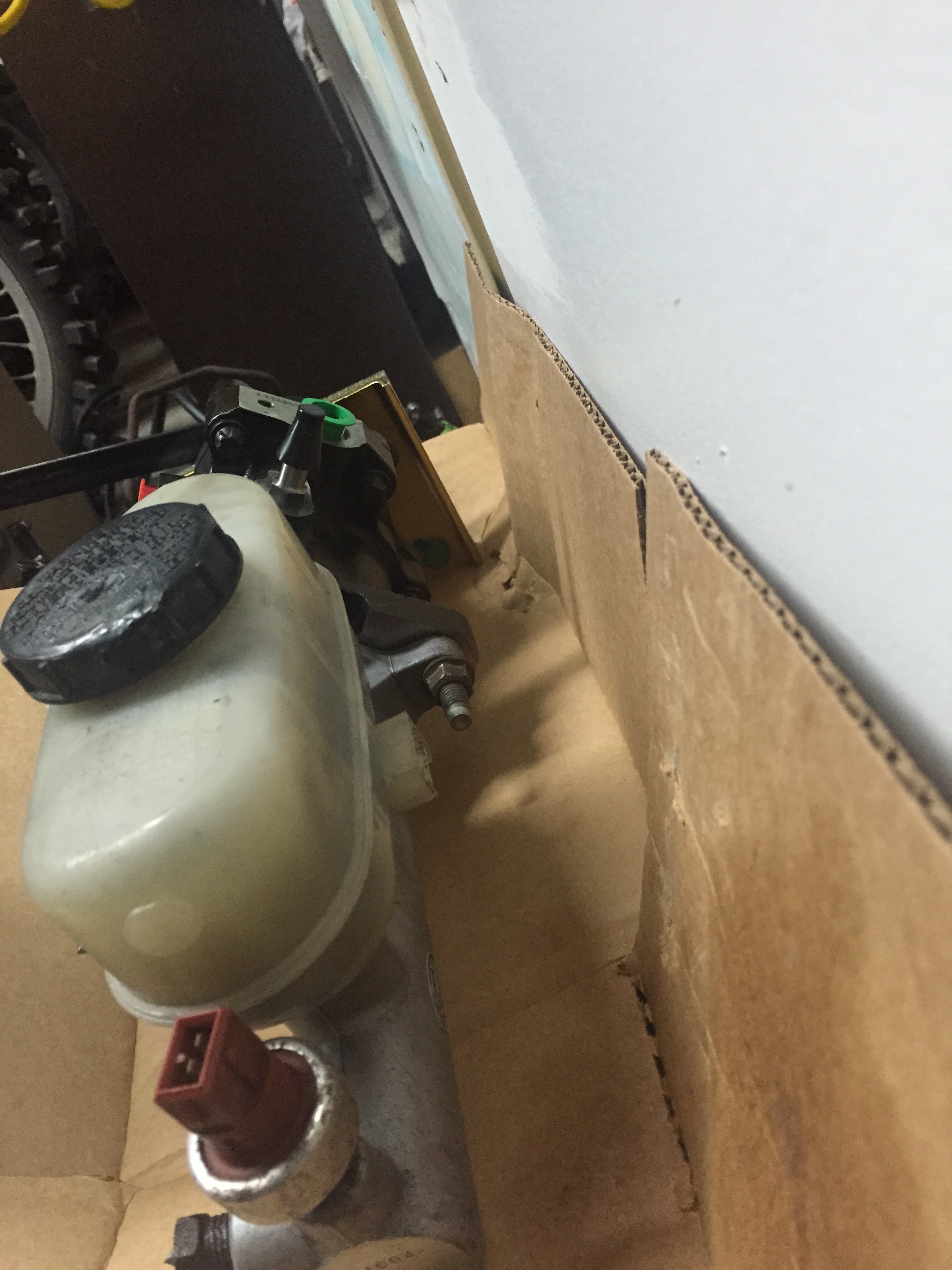

For those who notched out their original OBS master's how did you do so? I just reamed out the old holes evenly on each side till the master fit the width of the hydro boost bolts. Is this an ok way to do it?
