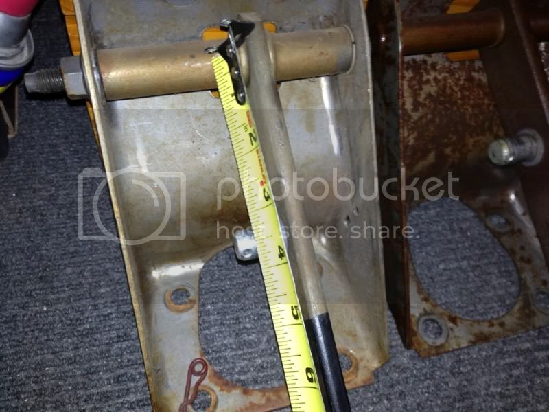

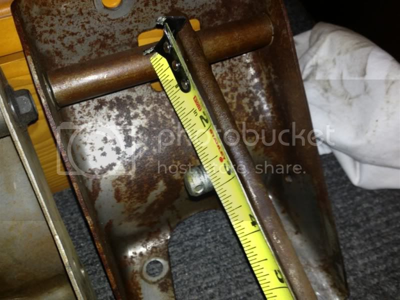

Here is the differences in the pedals. F450 F350 This is why the arm doesn't fit correctly on the f250-350 pedals. So for people that saying the pedal is the same, it is NOT! To correctly do hydroboost on a obs, better get the pedal too!

Very nice photos. That makes it clear there is a pretty big difference in the amount of force multiplication the pedal provides between the two. I bet that helps with the hard pedal after the hydroboost conversion.

Your right! I installed it tonight and took it for a drive. The pedal is night and day difference. You can actually feel the pedal be a little soft before it gets hard again from applying the brakes. ( if that makes sense) Before it was rock hard. I'm liking this conversion much better than before and plan on keeping it now. Now if I can find out why after 2 pumps it's still whining. I'm gonna try Mobil 1 first and if that doesn't work, I am going to put my old pump on. That didn't whine at all. I'm thinking air in the system still. I can feel the vibration on the hose coming from the pump to the hydro unit. I have tried a couple different bleeding procedures and still the same. The flow rate going back to the pump is nice and no foaming in the reservoir. Hmmmm
And I did clean up the pedal so it was ok to bolt to my truck. No way could it go in like that. Lol
The stock pedal on my F350 measures the same as the F450 pedal in your pics. :confused: Pedal rod fit on it with no problems and is nice and straight going into the booster.
Really? Well I have no idea then. All the f350 and 250s I have measured have been what I posted. The lower pin on the pedal. I measured from the center line on the pivot. You did too?
Yup I measured c to c. Has part # F5TZ-2455-DA stamped on it. I've no explanation as to why it's there, my truck seems to have been assembled from a mix bag of parts. Could explain why the vac boosted brakes never felt right?
I know the F Superduty pedal is no longer available. For those going forward with the swap, does anyone know if a SD pedal will work?

It doesn't seem difficult to machine a new pin, drill another hole in the F-250 pedal assembly and bolt the new pin into place. That's what I think I'll try when I install the hydroboost stuff into my truck. But I get free machining services from a buddy....
