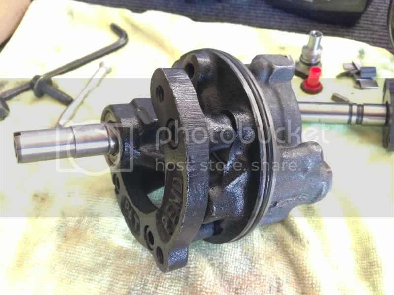

I haven't yet. I'm doing a saginaw conversion because the ford pump sucks and tired of dealing with a poor design pump. Here are a couple pics of what I have done so far.

I'm trying to find a brand new gm pump before I install it. I didn't want to use a reman one but I'm sure it would be fine. Just wanted a new one so its the last pump I have to deal with. Should have it in next week I'm thinking.

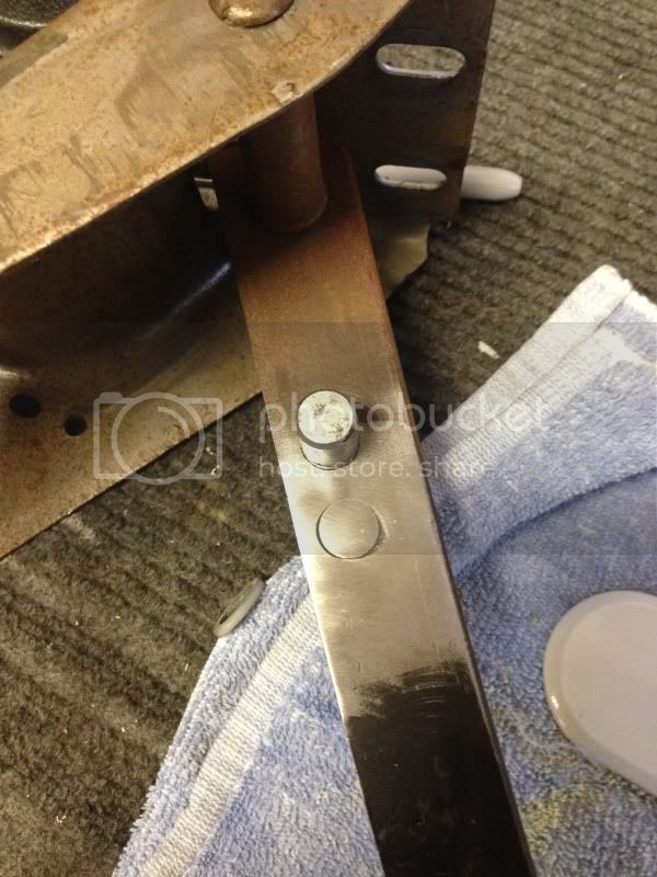

Did a pedal for a buddy. Went to pick n pull and ground the brake booster pin on the back side and knocked it out. Marked the new hole location with a punch. I then cut the f350 pin almost flush and then finished it smooth with a finish grinder. Then drilled the 9/16 hole (I think it was) and then pushed the pin in. Pin needs to stick out 7/8" from the pedal (on the side pic) Added some pics cause pics are cool.

Made my reservior can so I can finally bolt this thing in. Needed a return nipple for the hydroboost. I also bought a NOS pump so everything is brand new.
