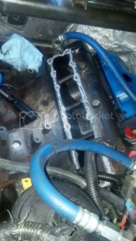

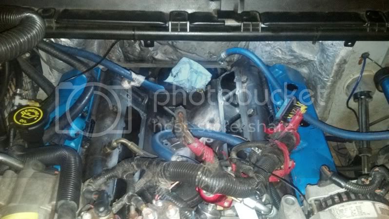

So decided yesterday to finally tackle installing this turbo and mount set up from Jake at Irate. I will have more pictures tonight but lets start off with a couple from yesterday.
Here the engine is all torn down. Spider, intake, CAC tubes, Turbo, uppipes, downpipe and plenums all removed.
Closer look at the intake runners
Grey RTV applied to the heads, ready to put in the custom plenums from Jake

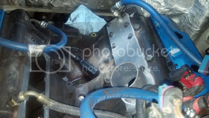

Heres what the plenums look like installed

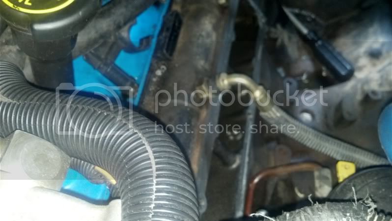

So im running into an issue with the oil return. What do I need ti get in way of braided line to replace the hard pipe return?

They are from Irate. The S468 would not fit with the stock plenums.
I will be updating this thread as soon as I finish with the install, running into issues with a siezed up fitting and some issues getting the oil return lined up and attached. Other than that its been a easy install with great fit
