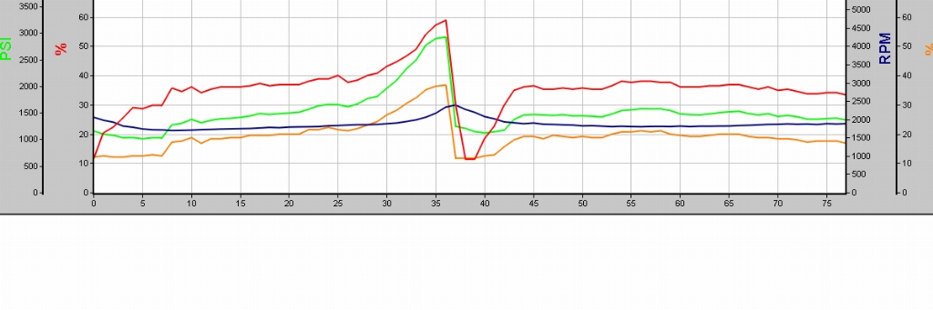

Here's an example screen shot that I was suggesting if produced for your truck, might help you/tuner with a diagnosis. Keep in mind...there might be nothing wrong at all either.
BUT...two pumps worth of HPOP oil volume, and your ICP should be jumping right up, like the chart below.
Red=Accel Pedal Position, Green=ICP, Blue=Engine RPM, Orange=IPR Duty Cycle.

The more I look at you graph, the more I feel like I have an issue. I dont see near that ICP under 2500rpm...that and I didnt make those numbers until like 2600 RPM
